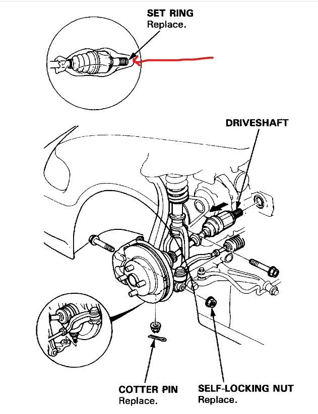

I just bought a used transmission and put it in my car because the garage I took it to said the main rod in the transmission was broken. I put the used one in it, and it still hasn’t fixed my problem. I can put it into gear, and it acts like it’s neutral my friend did have it moving one time, but the tire was jerking he parked it and it hasn’t moved since.

That sounds like a broken CV joint. Did you check to make sure they are fully installed into the transmission when you switch it?
Try this. Place the transmission in first gear (engine off) see if you can push the vehicle as if it is in neutral.
Let me know what you find.
Apr 8, 2024 at 12:42 PM
  • 55,721 POSTS

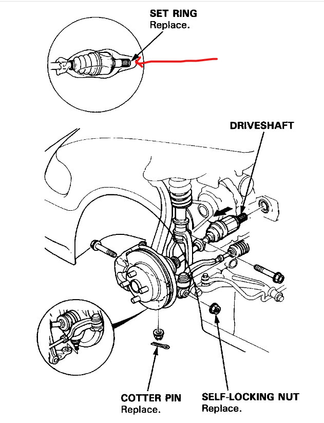

Here is how to install the CV axle correctly which if the C clip is missing the CV axle will just fall out of the transmission like Joe said. Check the image below to see what I am talking about
NOTE: Replacement procedures for left and right driveshafts are the same.

Check out the images (below). Please upload pictures or videos in your response to the problem so we can see what's going on.
