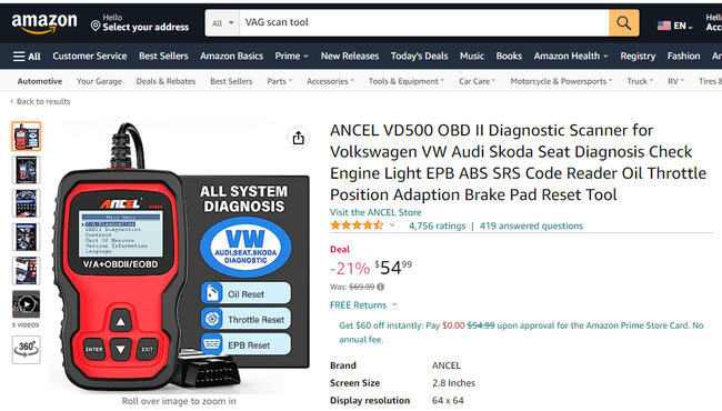

JAVED KHAN
  • 7 POSTS
Also, Jacob could you suggest me fault code reader for Audi I can buy on Amazon. Is it worth buying?
If you have any suggestions.
Mar 13, 2023 at 2:02 PM
  • 110,248 POSTS
As far as a scan tool is concerned, it really matters what you want it to do. Are you looking for something that provides powertrain codes and the ability to clear them?
I attached one that is a good price for what it can do. Take a look below.
See pic below.
