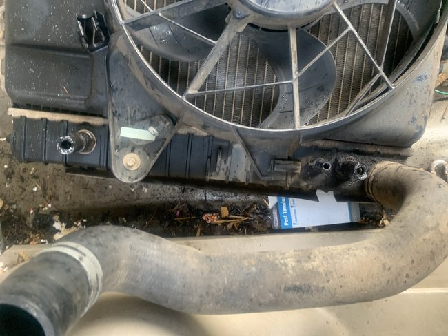

After replacing the cooling system/condenser I need help with reattaching the hoses to each unit
2003 FORD ESCAPE
250,000 MILES • 3.0L • V6 • 4WD • AUTOMATIC
ODESSA SMELTZER
I have replaced my cooling system including the condenser and transmission cooling unit, however I’ve not been confident in reattaching my hoses on each unit.
Feb 15, 2021 at 7:11 AM
Good evening,
They are for the transmission cooler lines. The other line on the side that has 2 outlets is the hose from the surge tank. Check out the diagrams (Below). Please let us know if you need anything else to get the problem fixed.
