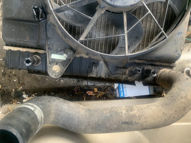

After replacing the cooling system/condenser I need help with reattaching the hoses to each unit
2003 FORD ESCAPE
250,000 MILES • 3.0L • V6 • 4WD • AUTOMATIC
ODESSA SMELTZER
I have replaced my cooling system including the condenser and transmission cooling unit, however I’ve not been confident in reattaching my hoses on each unit.

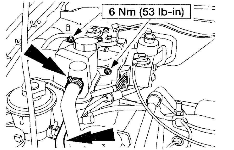

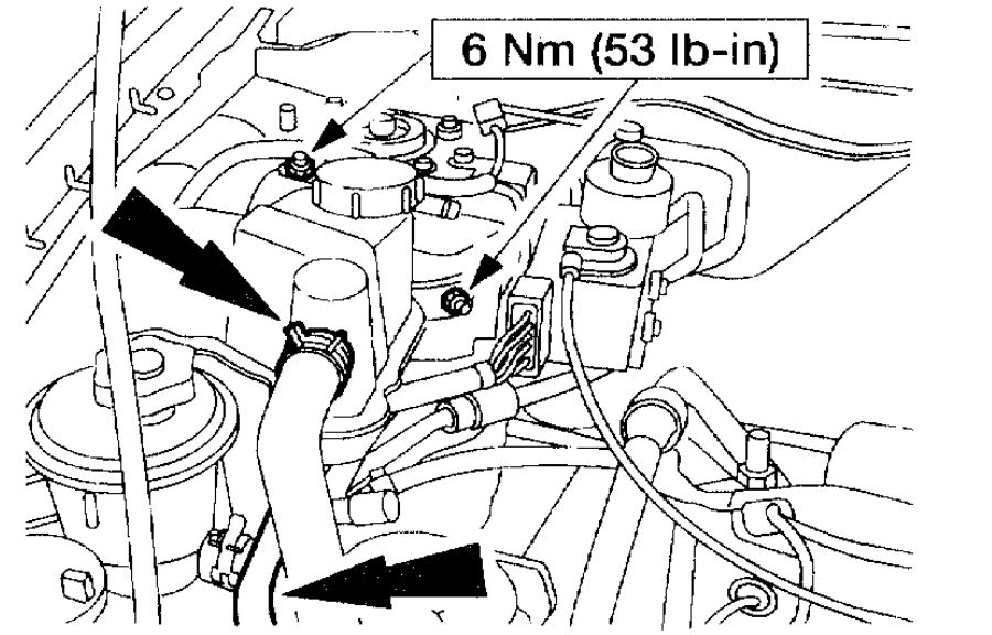

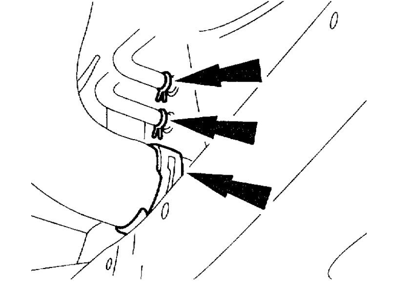

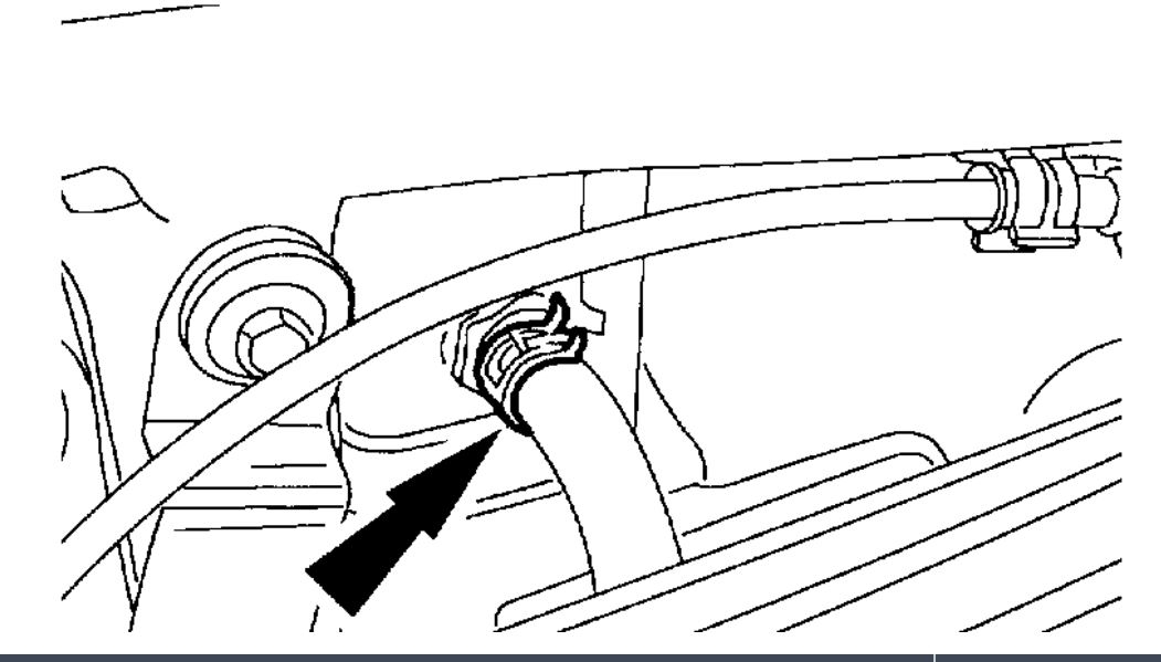

Good evening,
They are for the transmission cooler lines. The other line on the side that has 2 outlets is the hose from the surge tank. Check out the diagrams (Below). Please let us know if you need anything else to get the problem fixed.
