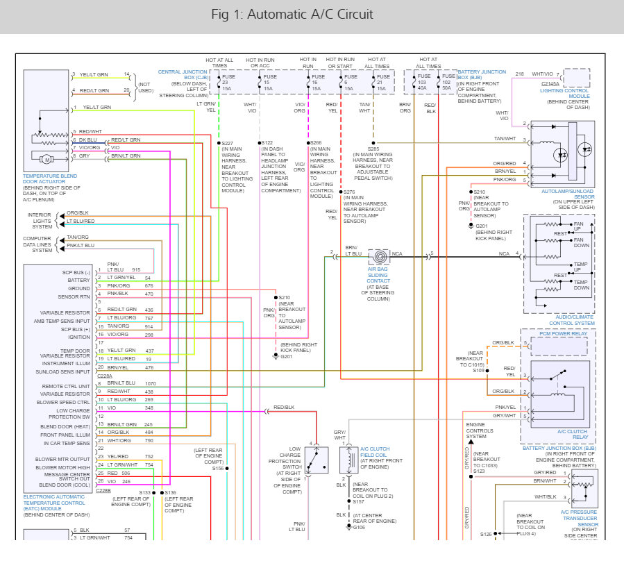

My blower motor won't come on at all. I checked all the fuses and they are all good. I pulled the blower motor resistor and have no power to that any suggestions?

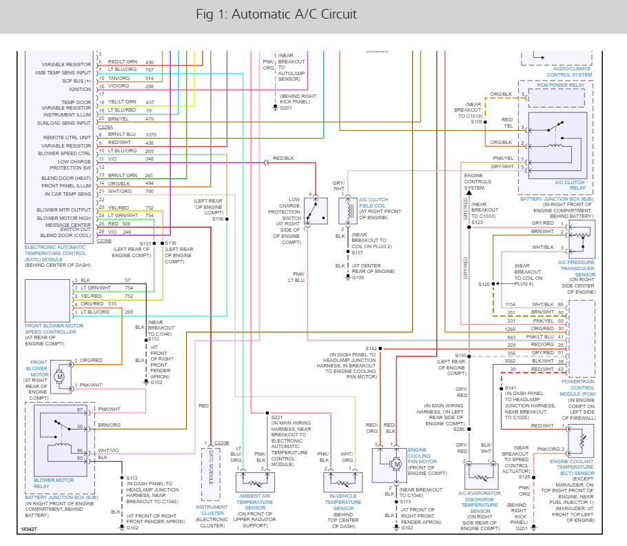

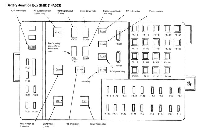

It sounds like you have a blower motor relay that is not working which is located under the hood in the fuse panel. I would swap it out and then see if the blower motor has power and ground, this guide can help.

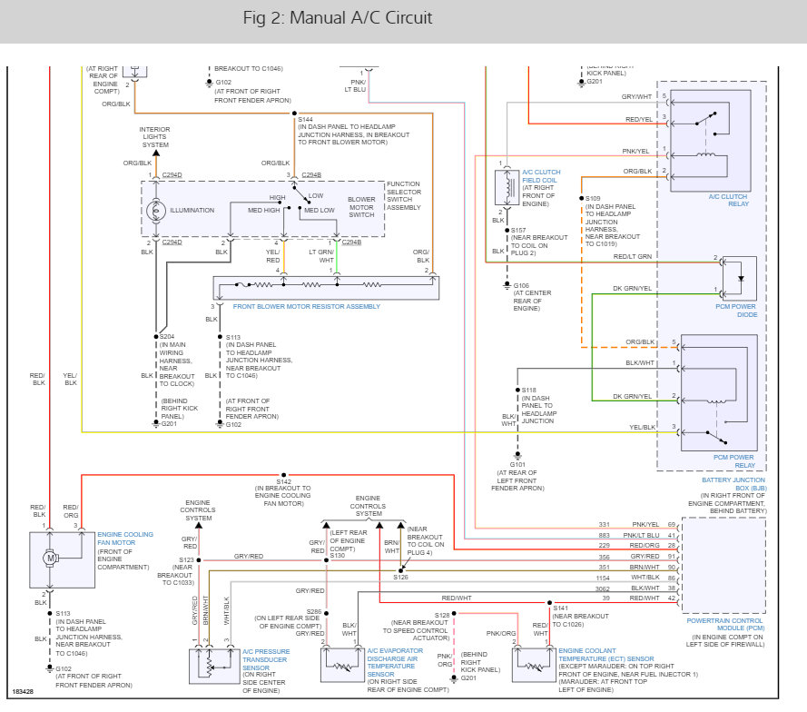

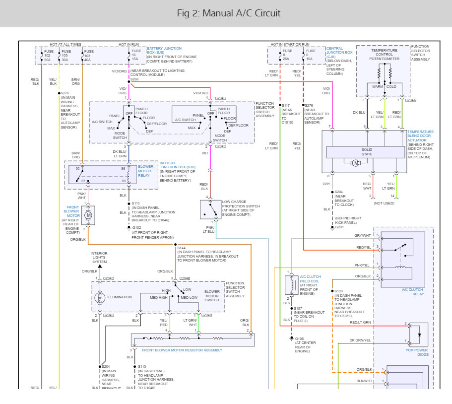

There is a relay for blower motor in junction box behind battery. Pull the relay and check to see if it's burnt. Also it can be the control head here is the wiring diagrams so you can see how the system works.
