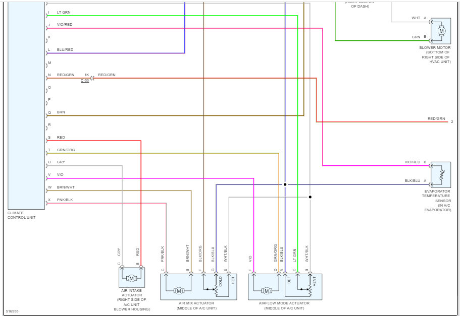

After a mobile retailer cleaned the car my climate control panel has no power.
Dec 27, 2022 at 8:14 AM
  • 110,240 POSTS
That isn't good. I hope you contacted them because if they got the wrong things wet, it can certainly cause issues.

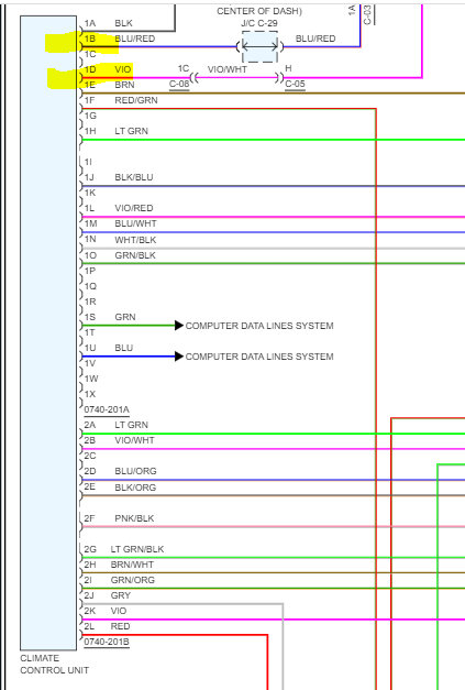

First, I'm not sure if you have automatic climate control of manual control. So, I opened up the wiring schematic for manual climate control. (See pics 1 and 2 below)
Power to the climate control panel is supplied by the room fuse located in the under-hood fuse box. First, I need you to check the fuse itself to make sure it hasn't failed. If it is good, also confirm there is power to and from it.
Let me know what you find. Also, if you have automatic climate control, let me know that as well.

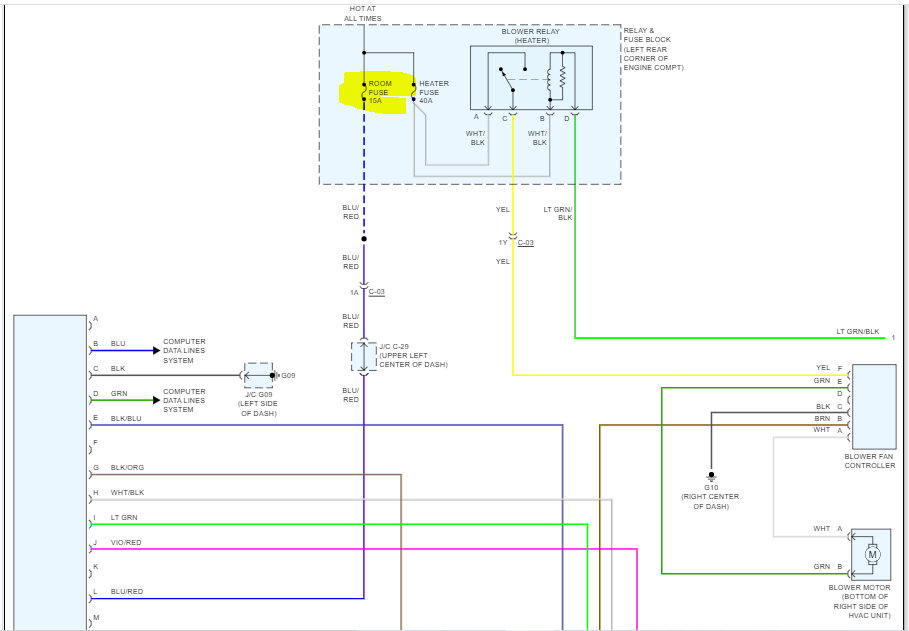

Fuse is good, looks like they may have damaged the actual climate control panel.
Dec 28, 2022 at 1:20 AM
JDOWNS40004
I have automatic climate control.
Dec 28, 2022 at 1:35 AM
  • 110,240 POSTS
I double-checked the automatic climate control, and it gets power from the same fuse. If the fuse is good and has power, the next thing would be to confirm there is power at the controller.
There are two wires at the controller connector that would need to be checked. I attached a pic below.
If there is power at the controller, then we need to scan the CAN. CAN stands for controller area network. Basically, the different modules are tied together via a few wires. This type of scan will retrieve codes regardless of the module storing them.
Here is a link that explains how it's done:

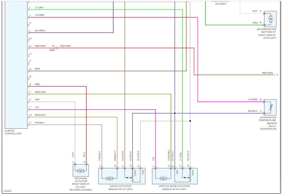

I have a question. Has anything other been affected? Is there anything on the controller that responds? Also, is there any evidence that water or a cleaner may have been sprayed on the controller?
See pic below.
