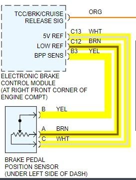

First, check to see if the brake light switch is getting power, is allowing power to exit, and is positioned properly.

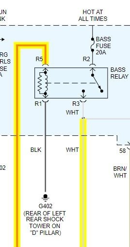

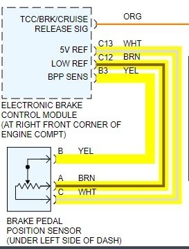

First, confirm power to the switch. I have attached schematics for you to follow. The first one shows three wires going to the brake light switch mounted on the brake pedal under the dash. There is a yellow, brown, and white wire. The brown wire (low reference) is the ground, so you can check for continuity to ground. The white wire should have power always and the yellow wire should show power when the pedal is pressed.
Next, check and confirm the fuse and relay in the under hood fuse box are good. See picture 2.

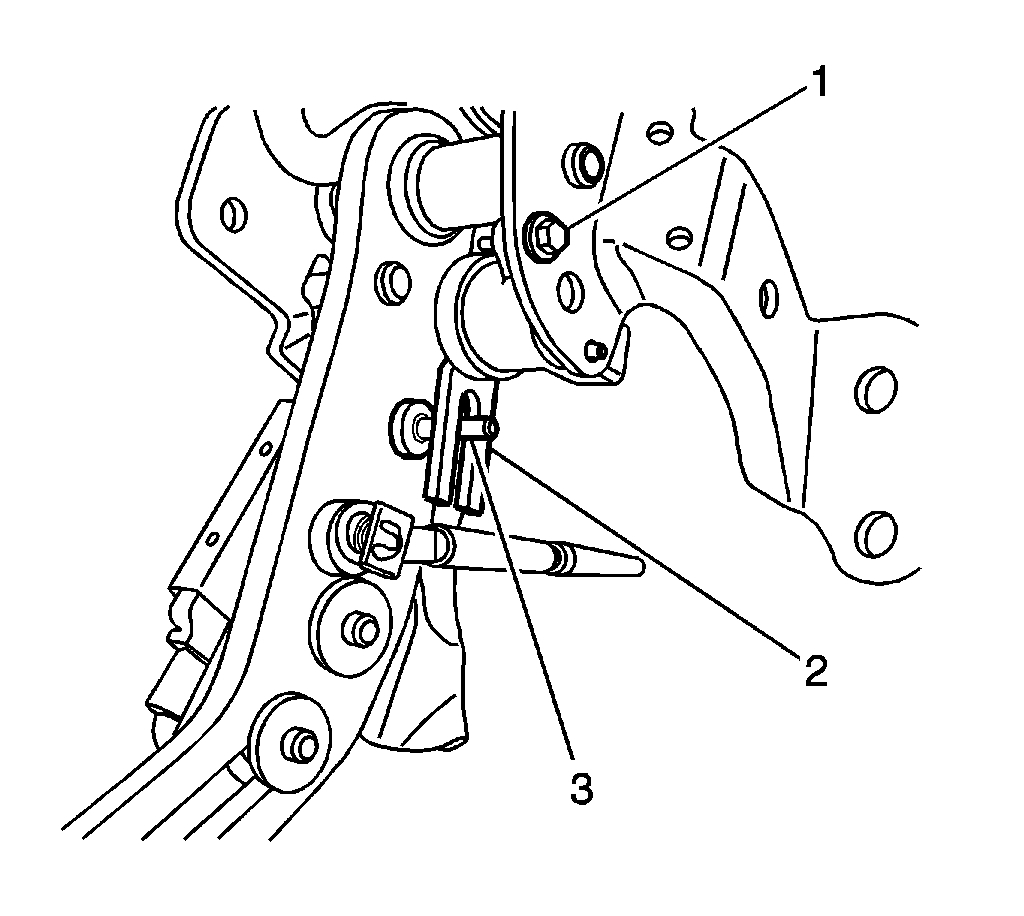

BRAKE PEDAL POSITION SENSOR REPLACEMENT
REMOVAL PROCEDURE
1. Remove the driver side instrument panel (I/P) insulator closeout panel.
Picture 3
2. Remove the bolt (1) securing the brake pedal position switch to the brake panel bracket.
3. Remove the switch.
INSTALLATION PROCEDURE
Picture 3
1. Connect the electrical connector on the switch.
2. Align the brake panel position switch to the stud (3).
3. Install the bolt (1) securing the brake panel position switch to the brake panel bracket.
NOTE: Refer to Fastener Notice in Service Precautions.
Tighten
Tighten the bolt (1) to 9 N.m (80 lb in).
4. Install the driver side I/P insulator closeout panel.
