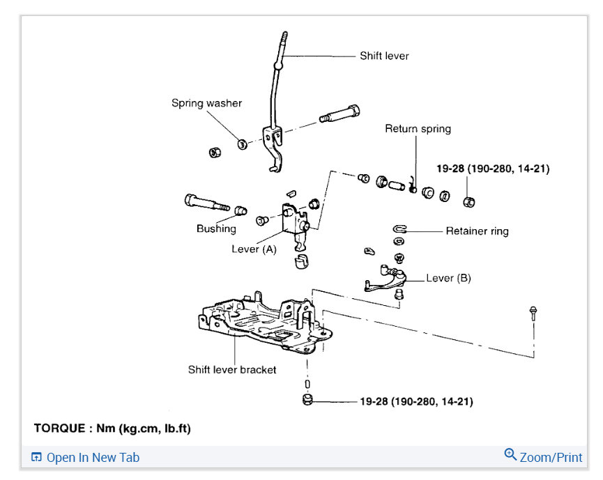

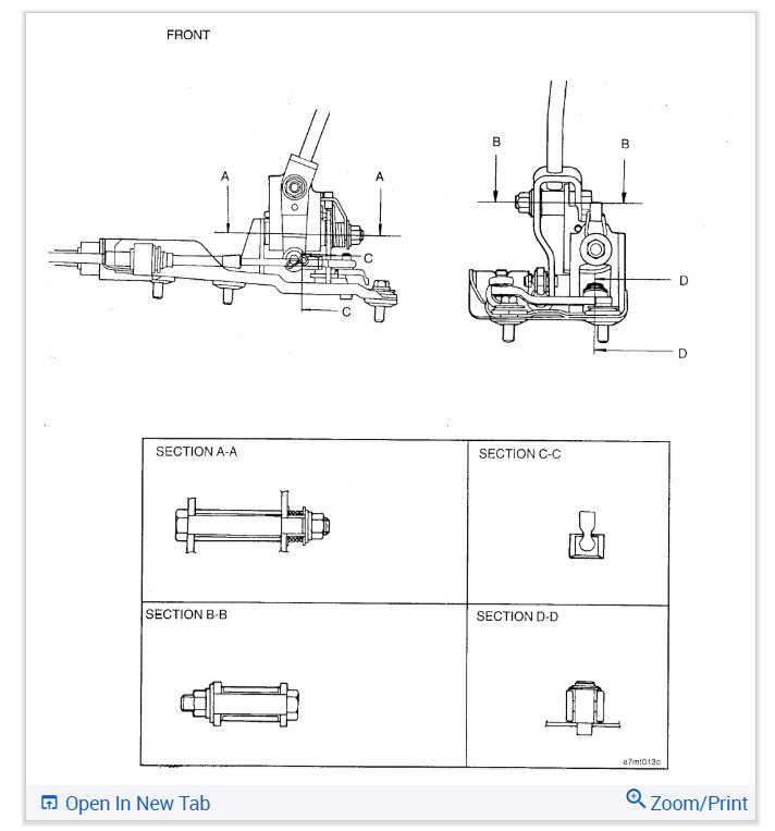

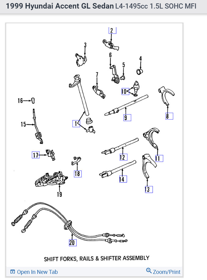

I have lost third and fourth gear
140 MILES • 1.5L • 4 CYL • 2WD • MANUAL
C JOHNSON
I have full travel on the stick but does not engage either gear.
Oct 22, 2018 at 12:17 PM
  • 55,746 POSTS
It sounds like the shift cables have worn out here are diagrams to help you confirm and replace the cables. Check out the diagrams (Below). Please let us know what happens.
