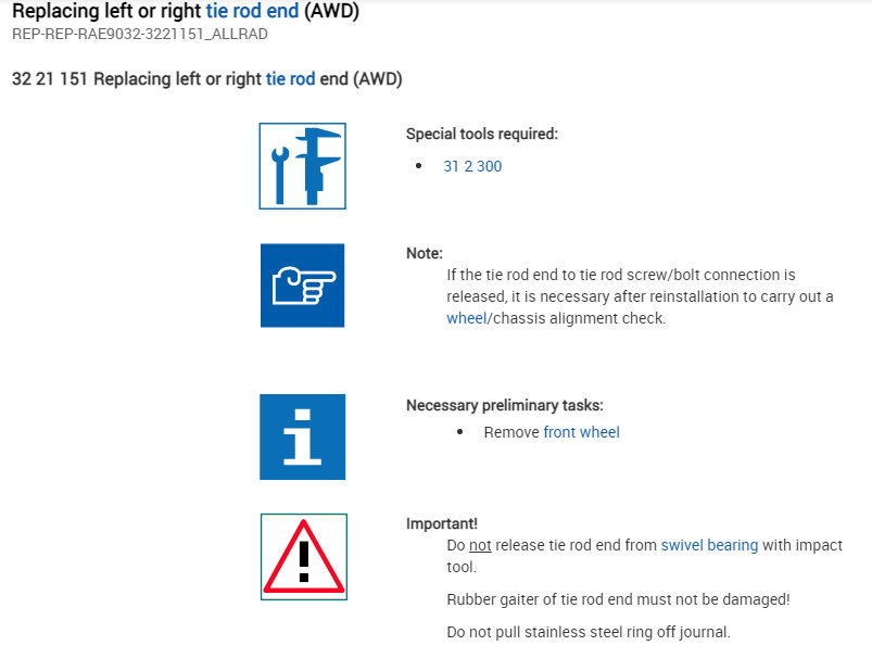

1. I have BMW 320D suddenly my car start given me a problem ... when I am driving 35 and above and trying to break I can hear very strong noise and vibration. When I am driving below 30 its fine... what do you think could be?????
2. Another issue I am facing when I am turning my steering wheel into left I can hear noise as well.
Thank you

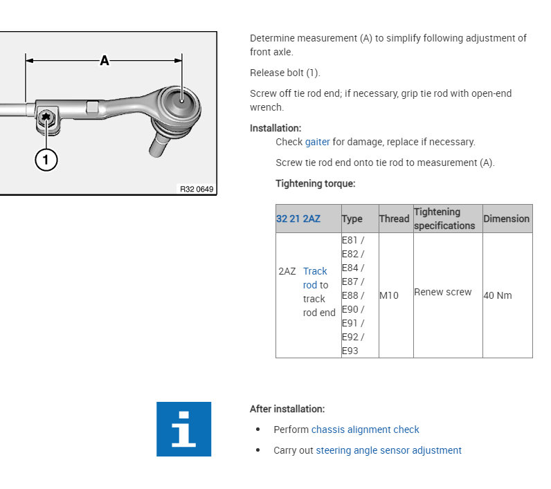

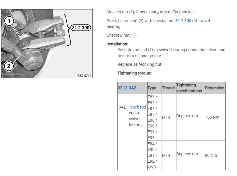

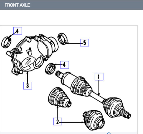

Can the describe the type of noise you hear?
Is howling, rumbling, screeching etc?
It will be helpful if you can upload a video so we can hear the noise.
This noise can be due to worn suspension components, faulty CV joint, bad tires etc.
Here are some helpful guides on different types of noises and what are the general cease:
https://www.2carpros.com/articles/car-howling-noise
If you hear the noise when turning wheel, it can be due to a bad tie rod or CV axle.
Please let us know more details of what you are experiencing.
