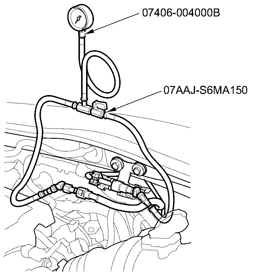

Here are the directions specific to your vehicle for testing fuel pressure. The attached pic correlates with the directions and the manufacturer's specifications are included in the directions.
______________________________
2010 Acura Truck MDX V6-3.7L
Fuel Pressure Test
Vehicle Powertrain Management Fuel Delivery and Air Induction Fuel Pump Testing and Inspection Component Tests and General Diagnostics Fuel Pressure Test
FUEL PRESSURE TEST
Fuel Pressure Test
Special Tools Required
- Fuel Pressure Gauge 07406-004000B
- Fuel Pressure Gauge Attachment Set 07AAJ-S6MA150
1. Relieve the fuel pressure See: Fuel Pressure Release > Procedures.
2. Attach the fuel pressure gauge set and the fuel pressure attachment gauge.
pic 1
3. Disconnect the HDS from the DLC (fuel pressure relieving with the HDS) or install PGM-FI main relay 2 (fuel pressure relieving without the HDS).
4. Start the engine, and let it idle.
- If the engine starts, go to step 6.
- If the engine does not start, go to step 5.
5. Check to see if the fuel pump is running: Listen to the fuel filler port with the fuel fill cap removed. The fuel pump should run for 2 seconds when the ignition switch is first turned to ON(II).
- If the pump runs, go to step 6.
- If the pump does not run, check for DTCs, then do the appropriate DTC troubleshooting procedure.
6. Read the fuel pressure gauge. The pressure should be 380-430 kPa (3.9-4.4 kgf/cm2, 55-63 psi).
- If the pressure is OK, the test is complete.
- If the pressure is out of specification, replace the fuel pressure regulator See: Fuel Pressure Regulator > Removal and Replacement and the fuel filter See: Fuel Filter > Removal and Replacement, then recheck the fuel pressure.
