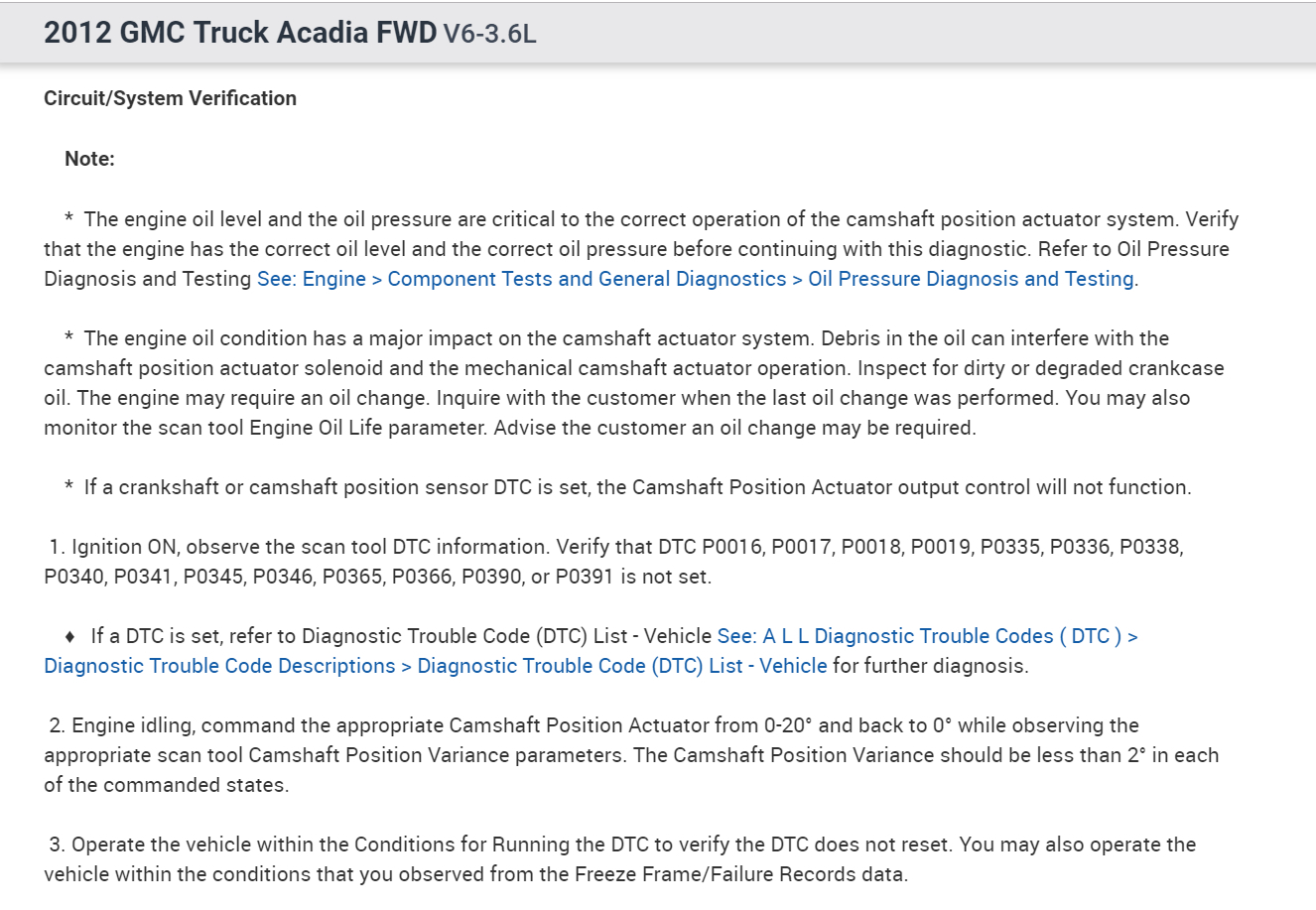

I have code number P0014
2012 GMC ACADIA
200 MILES • 3.6L • 6 CYL • 2WD • AUTOMATIC
ALISOWI
I want to solve this problem. Do you have any picture what I can do?
Mar 18, 2019 at 6:56 PM
SCGRANTURISMO
  • 4,897 POSTS

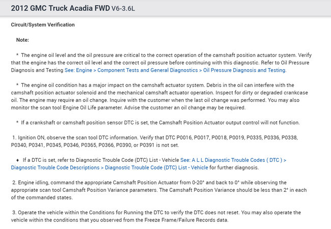

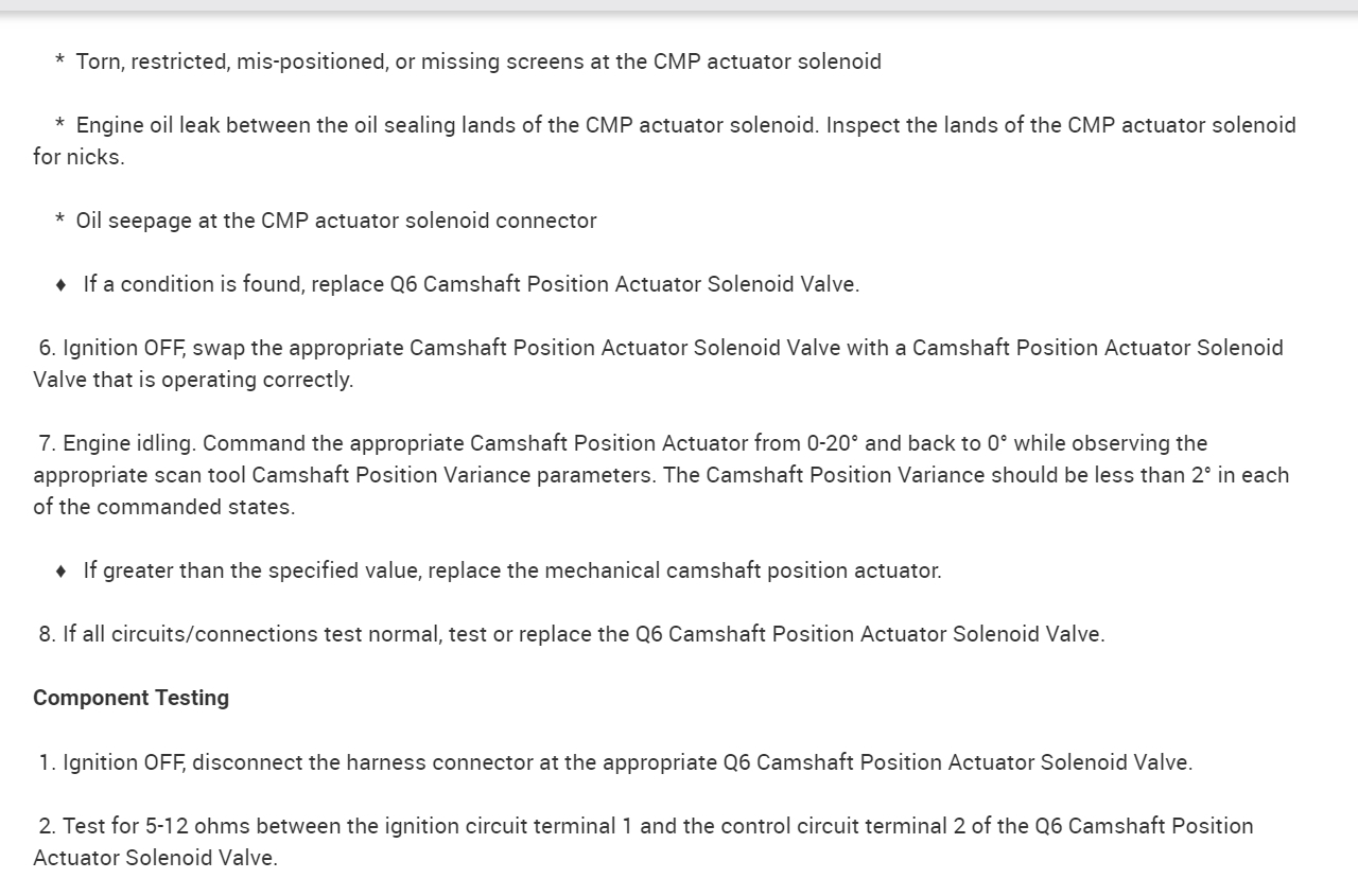

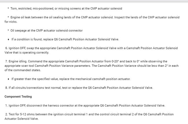

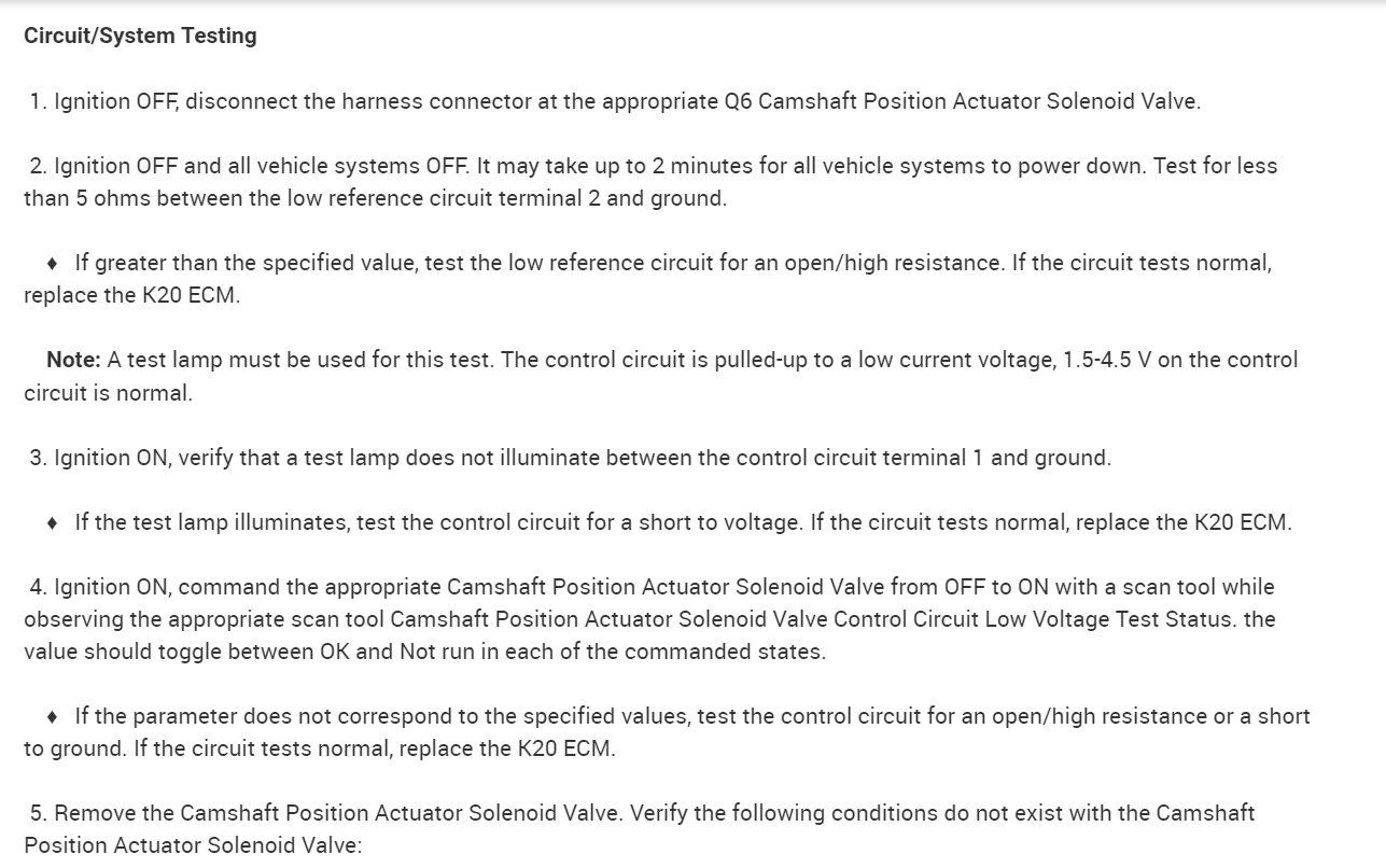

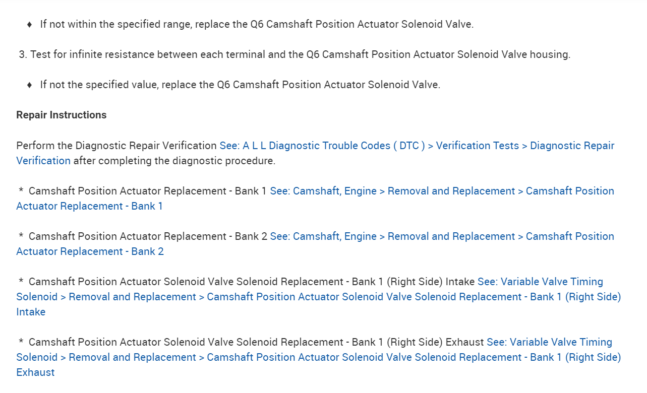

This is a problem with your vehicle's exhaust camshaft performance for bank 1. The Power-train Control Module(PCM) AKA,"computer" has detected a 5 degree offset from where the exhaust camshaft is and where it should be. I have included in the diagrams down below a factory troubleshooting flowchart for you to go through. Please go through it and get back to us with what you find out.
