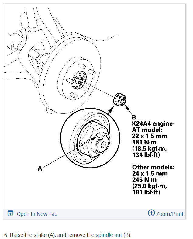

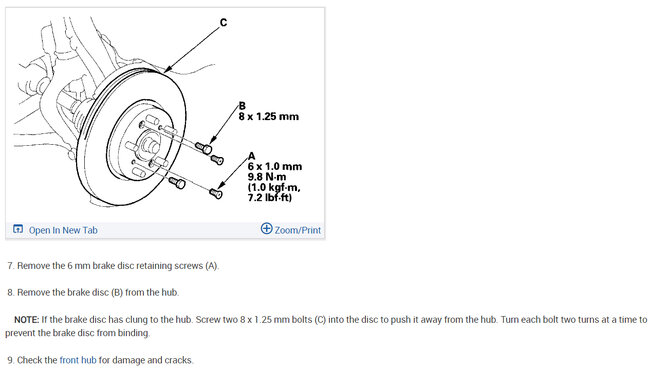

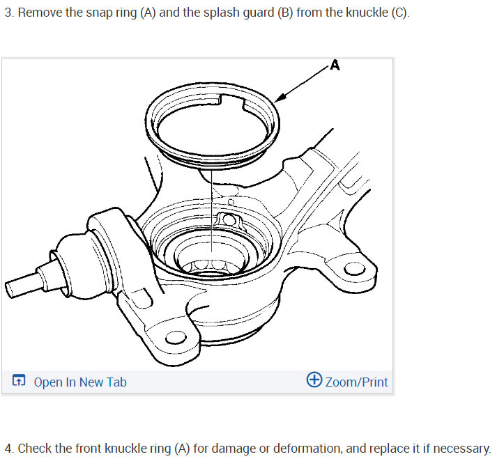

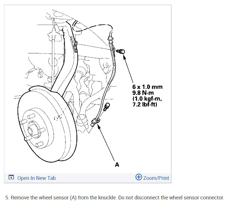

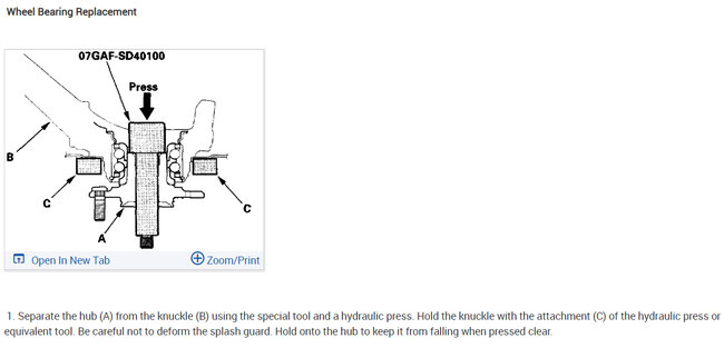

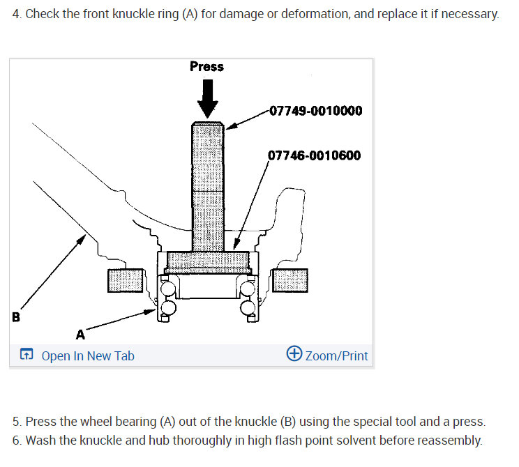

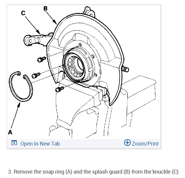

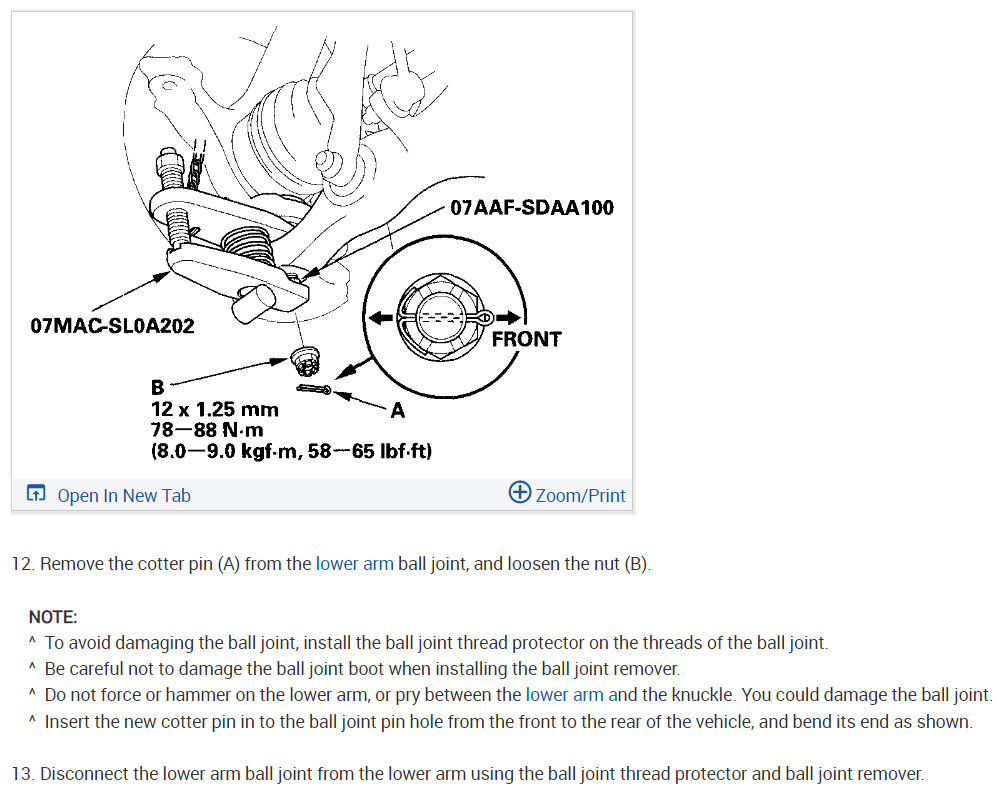

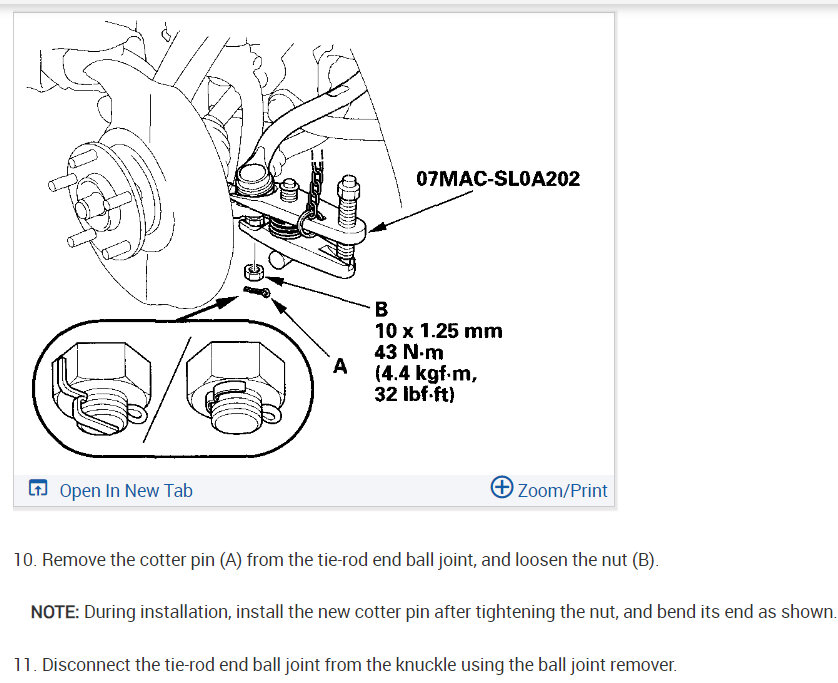

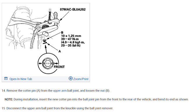

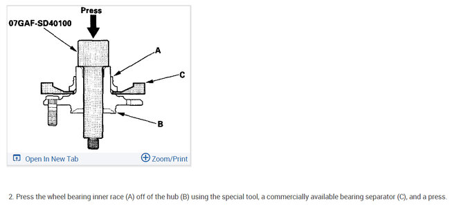

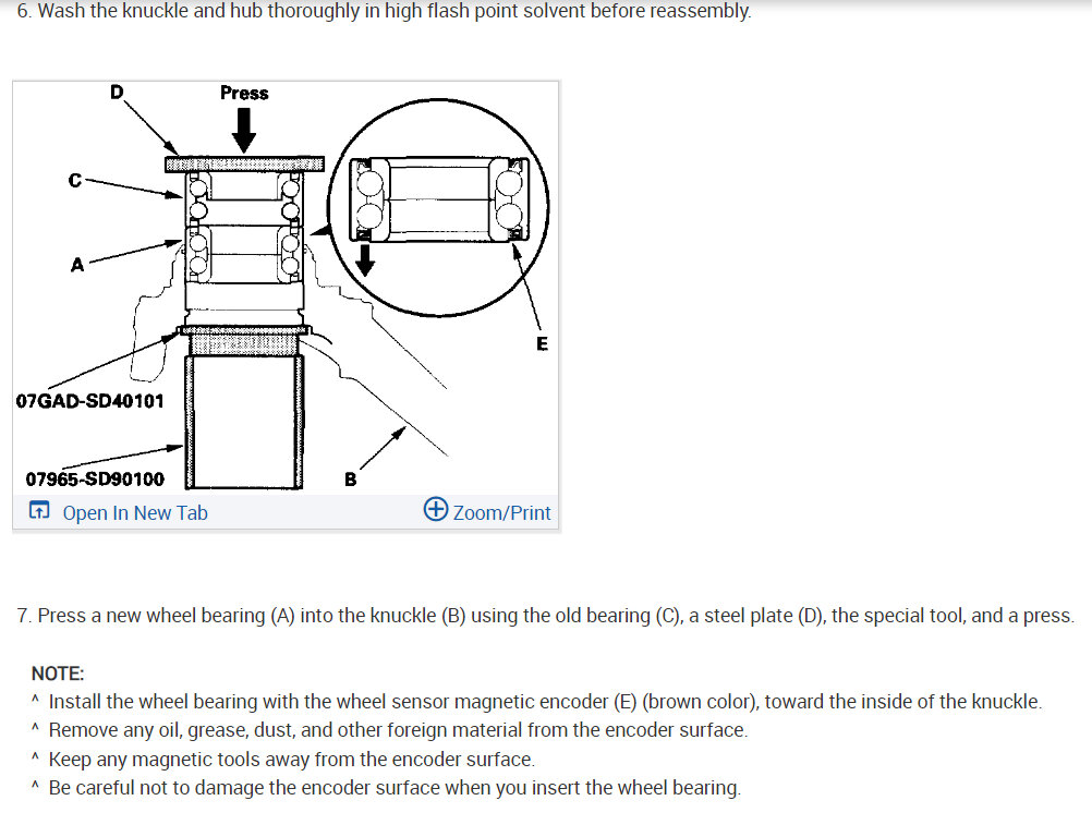

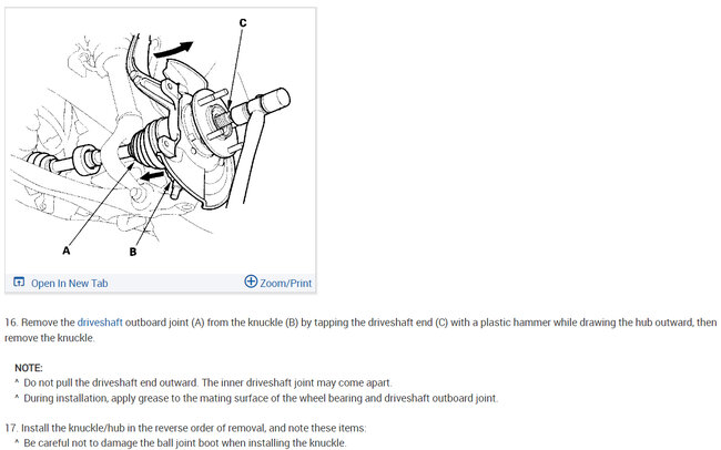

So, if the wheel bearing hub is going out the reluctor wheel will not line up on the sensor. Do you hear a humming noise coming from the right front wheel, if so, this will be the problem. Here is how to change it out.
This video will help with the press work:
https://youtu.be/_FzmmBoa4Tg?si=Sw8Ec4X4iCY4khXQ&t=442

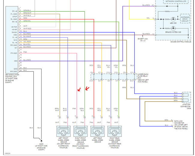

If this is not the problem it would check the WSS circuits, here is a guide to help and the WSS wiring diagrams so you can see which wires to test and where.
Check out the images (below). Please upload pictures or videos in your response of any problems so we can see what to help you with.

No, I don't hear a humming noise coming from the right front wheel. I will check pink green and blk wire voltage from ABS module and get back to you. Thank you for the wiring diagrams.

So, I didn't find any voltage issues when testing with multimeter. I just replaced the wheel bearing anyway since this car has so many miles and that seemed like my only other option. It worked!! ABS light is gone. I have 2 accords one with over 400k and then this one. Thanks for helping me keep these girls running with no dash lights. Hope to see 999,999 one day.
