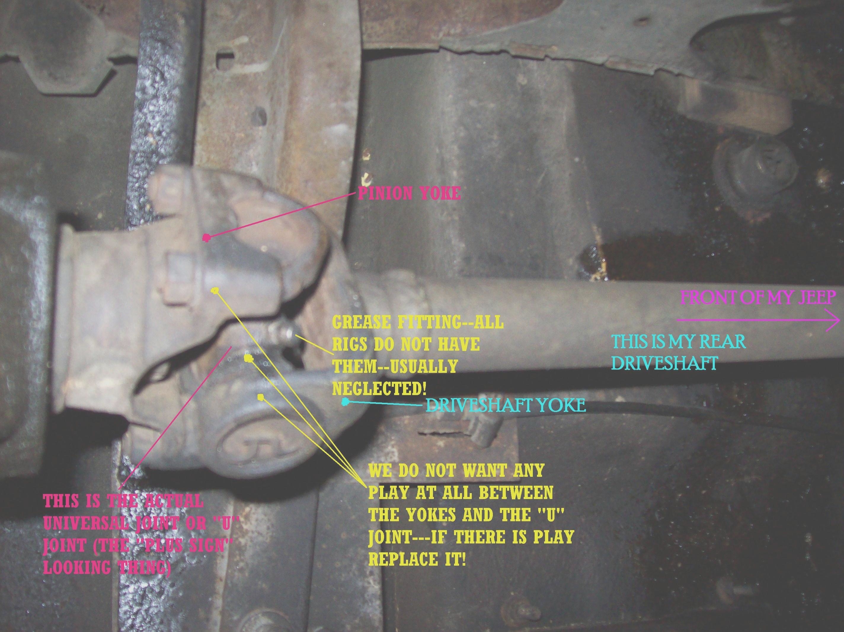

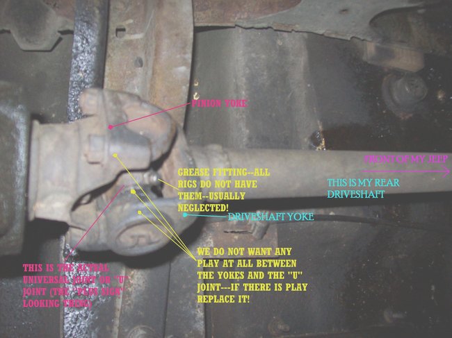

Have you checked the rear driveshaft's universal joints for slop or play in the caps?
Even if they are religiously greased, sometimes one of the caps gets nothing at all.
Not saying yours does, on my Jeep CJ, they will chirp during deceleration if they start going bad.

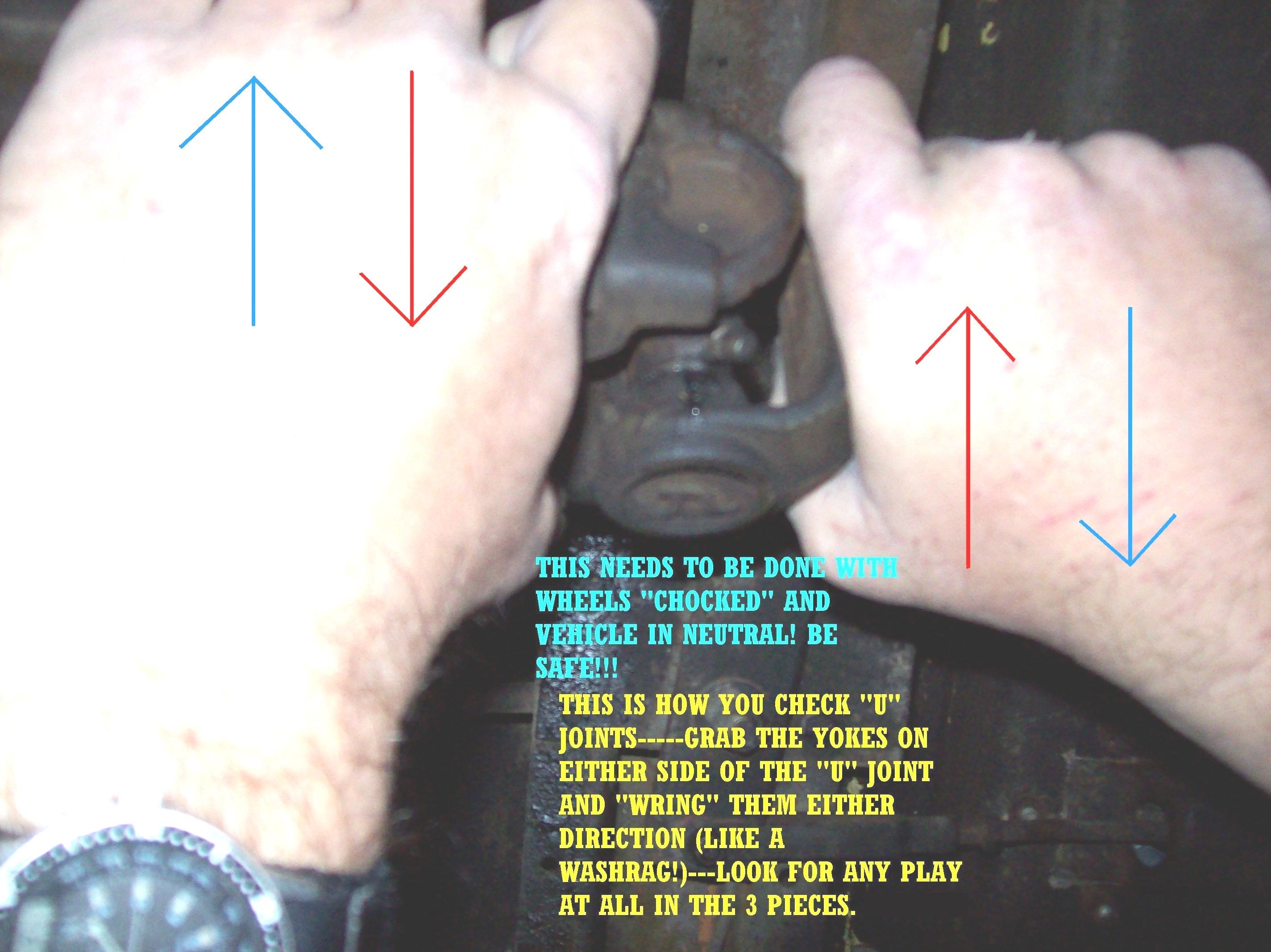

Flat ground, wheels chocked front and rear, out of gear. Grab either side of the universal joint and "wring" it back and forth looking for any play in the in the caps.
Keep us posted.

No it is not in the u joints in the drive shaft they are good.
