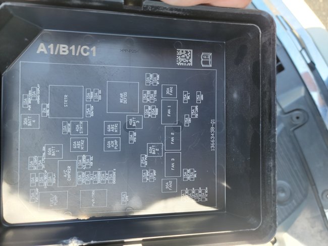

None of the relays under the hood say that.
Aug 30, 2022 at 2:40 AM
AL514
  • 5,683 POSTS
They don't make anything easy anymore. Can you find me a build date for your vehicle? It should be on a tag on the driver's door frame, it will have a month and year such 08/2007 or 08/07 for example. It might be on the underside of the hood tag as well. There might be a slight difference somewhere here. Even the OEM diagrams call it IGN MAIN PCB Relay, underhood fuse panel, passenger side strut tower. And is there 12volts at the Trans Fuse? No corrosion in the pins it fits into?
Also, you mentioned the TCM was spliced in? Was it recently replaced, and why was it spliced in?
Okay, I figured it out. Those relays are built into the fuse panel and are not serviceable.
The 3rd diagram is the same fuse panel you're showing me, I'll show you the list of relays built into that fuse box. (4th diagram) that's why we can't find it, but it's in there.
So, with the key On, if you have power at the TRANS Fuse and the ECM IGN fuse, the relay is working.

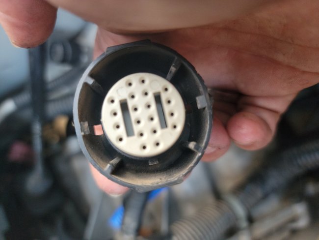

It's just impossible with the transmission one too.
Sep 2, 2022 at 11:46 AM
AL514
  • 5,683 POSTS
Look back up, I have a diagram I made showing how to back probe a connector.

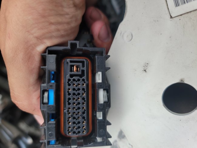

And what are you seeing wrong with pin 49? Does it look spread compared to the flat pin that it connects to?
that transmission connector will definitely need to be back probed, those are extremely small pins, those are the ones that worry me. They are so small, if there's the slightest spread in the female pins it will never connect with the transmission.

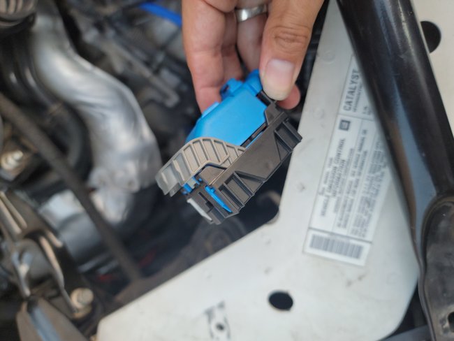

Okay, but how would I do that with the TCM harness? It has a whole plastic back I see doing it with the transmission one but the TCM one?
Sep 2, 2022 at 11:52 AM
ERIC ANTHONY URIBE
  • 39 POSTS
It is like lower than it should be it's like misaligned. it's just the only thing I've seen slightly not right.
Sep 2, 2022 at 11:53 AM
AL514
  • 5,683 POSTS

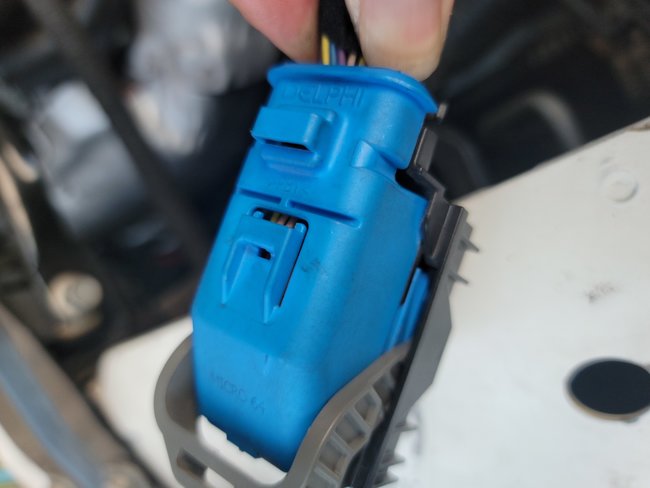

Can you show me the rest of the connector? Sometimes they may need to be taken apart somewhat.
Sep 2, 2022 at 11:55 AM
ERIC ANTHONY URIBE
  • 39 POSTS
Here.
Sep 2, 2022 at 11:58 AM
ERIC ANTHONY URIBE
  • 39 POSTS
This angle too.
Sep 2, 2022 at 11:59 AM
AL514
  • 5,683 POSTS
Okay, that blue cover will come off, I'm trying to find the diagram of it, sometimes you have to pull the grey latch back to its lock position and it make expose the tabs to remove it. I take them off all the time, they need to remove for testing when plugged in, It's just a search trying to find the instructions to getting it off.

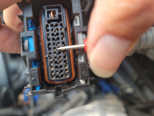

As for pin 49, if you can find something that is the same thickness as the pin that fits in that cavity, you can do a drag test on it. If that Ground has a loose pin, it can cause that code. Just look at the TCM pins to see how thick that pin is, It does look like it might be a little loose.
Ill see if I can find the instructions on taking that blue cover off, unless can you fit a regular pin inside of the TCM connector smaller pins? Just nothing that has to be forced it, you only need to make a light contact with those female pins to get a voltage reading. Even a sewing pin might fit.

Find something the same thickness?? That connector is so unique. That seems extremely difficult. I feel like I'd have to destroy the new TCM I bought to find the same thickness and use the pin from the new TCM and saw through it.
Sep 2, 2022 at 12:21 PM
ERIC ANTHONY URIBE
  • 39 POSTS
I tried a sowing pin but I was getting a reading like it was .40 etc., I couldn't get a good reading and I tried other female pins and roughly the same reading.
Sep 2, 2022 at 12:27 PM
AL514
  • 5,683 POSTS
No don't do that, get the blue cover off the back and back probe the connector, do that first and let's make sure that 12volts is getting to that pink wire. This code is for the TCM Ignition wire. Try a sewing in in the front and get a voltage reading on the pink wire. We'll deal with the results after.
In these situations, you have to be creative, this is what it takes if you're going to fix your own vehicles.

So, I tried to get a voltage reading on the female pin with my sewing needle and it didn't read anything it was 0 but I tried the pin to the right it had 12 volts and the one to the left of it didn't read any volts either. That was with the DC current with the black lead on the negative terminal of my battery with the key on.
