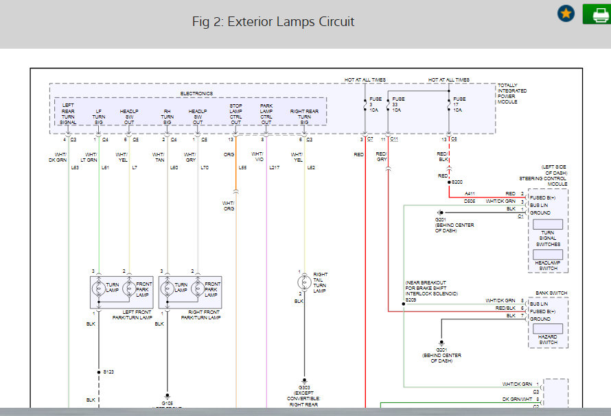

I have had a few people look at my left rear turn signal light that will not work. all the other parts to the taillight and brake light works. i have even replaced with a new bulb and it didn't work. i can't figure out how to fix it? Do you know what it could be and how to fix it? Someone said maybe buy a multi-functional turn signal switch, but if all of my other signals and lights all work right but that left rear signal light would i still need to buy a multi-functional switch? Also, the people said something about it wasn't getting grounded right maybe or something what does that mean and how can i fix that?
Jul 18, 2019 at 2:18 PM
SCGRANTURISMO
  • 4,897 POSTS

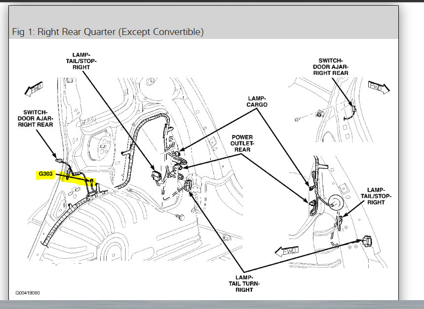

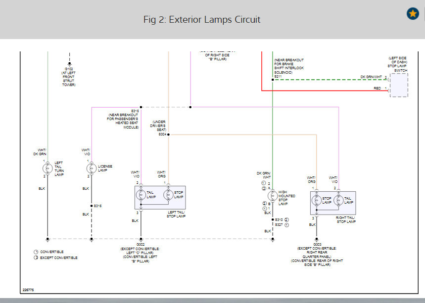

This could be a problem with Ground #303, which is located on the right rear quarter panel. In the diagrams down below I have included a wiring diagram of your vehicle's exterior lighting, and a diagram of where Ground #303 is. Please inspect Ground #303, making sure that it clean, tight, corrosion free, and making good metal to metal contact and get back to us with what you are able to find out.
