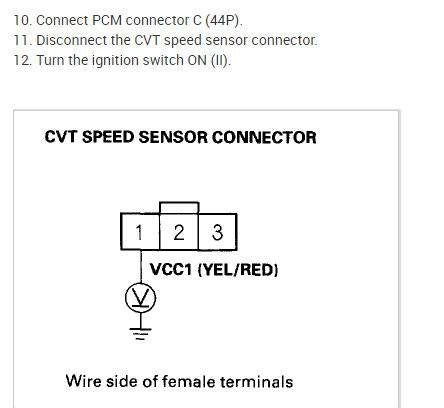

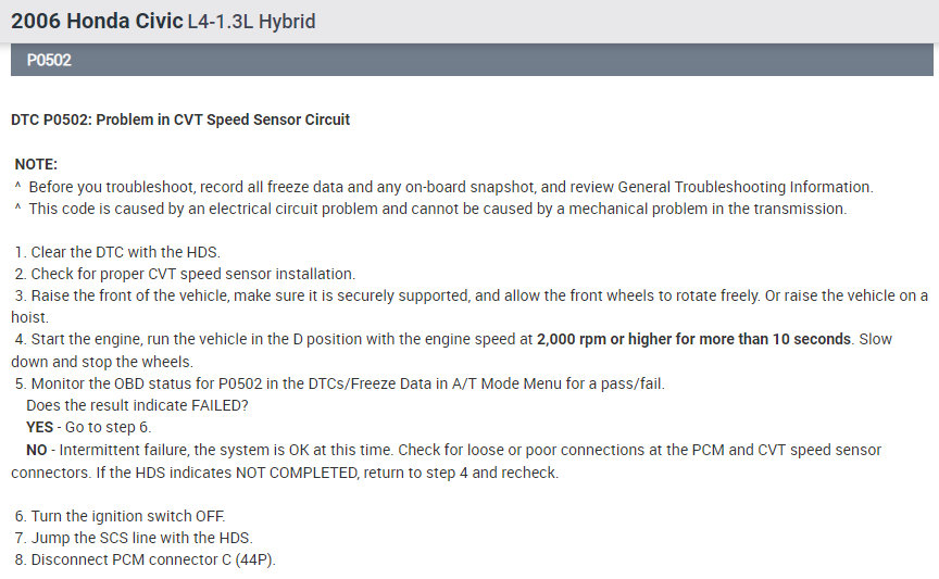

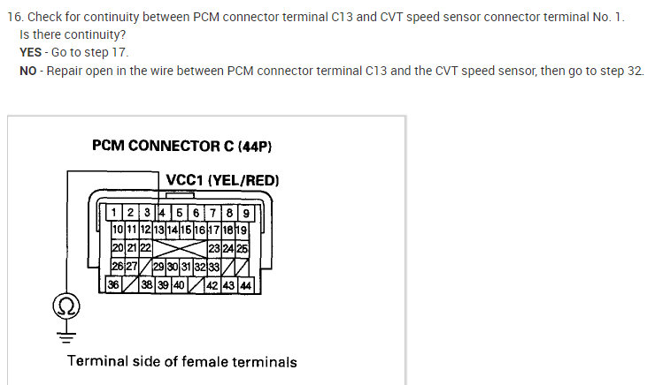

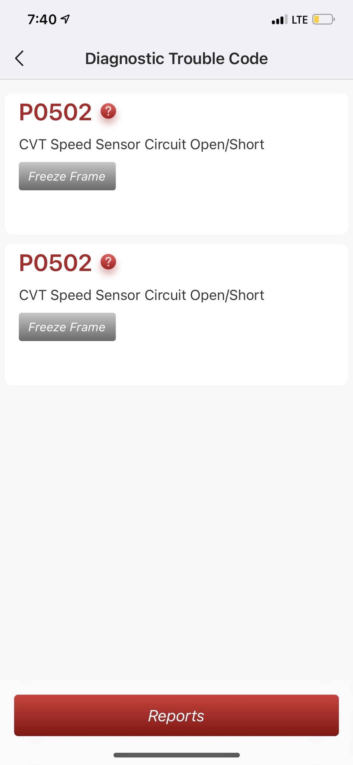

Code p0502 which sensor should I be looking at and how can i test?
2006 HONDA CIVIC
135,000 MILES • 1.3L • 4 CYL • 2WD • AUTOMATIC
ERICKBB6
  • 8 POSTS

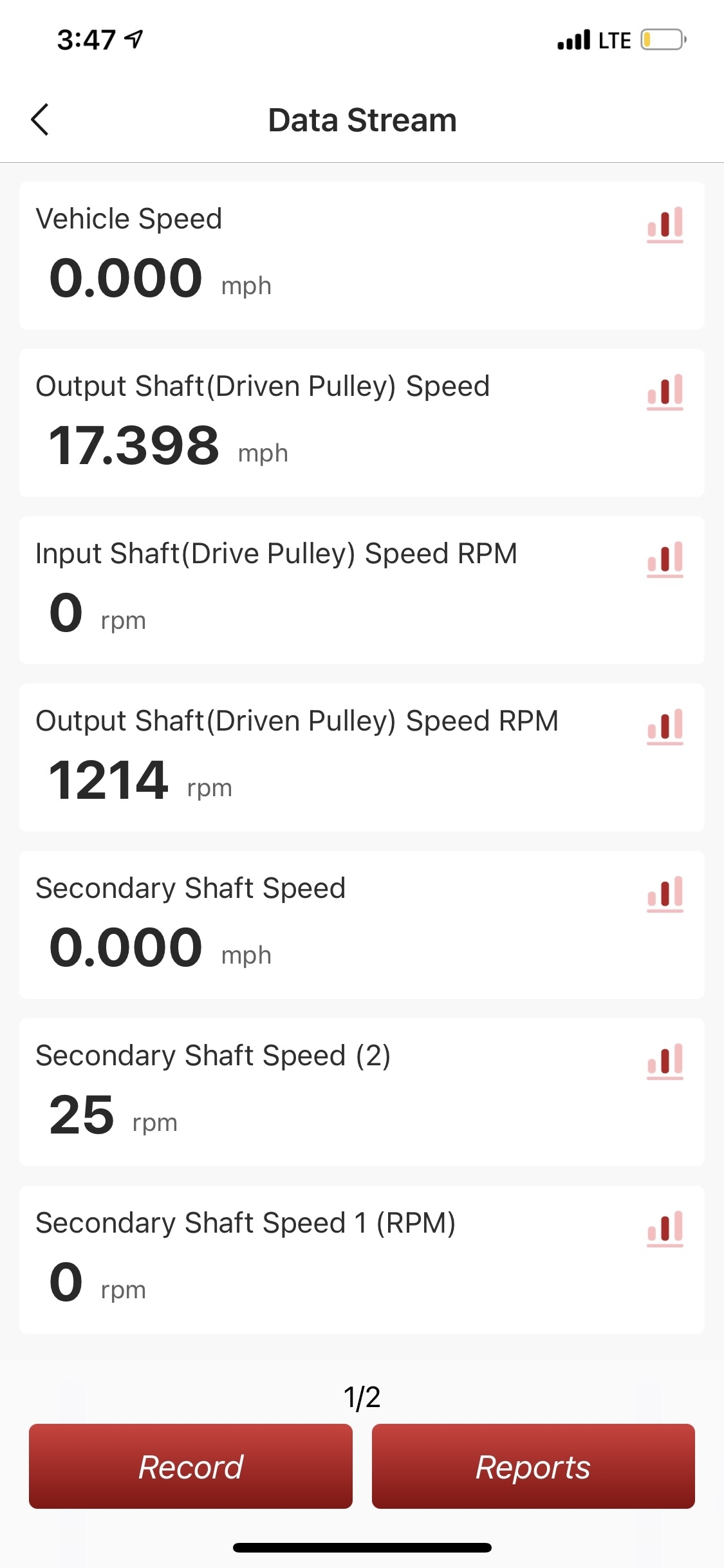

I have a flashing D light.
Code p0502
speedometer stays at 0
And the following live data readings:
No speed read from Drive pulley input and secondary shaft speed(1).
Aug 31, 2021 at 10:35 PM
DANNY L
  • 5,648 POSTS
Hello, I'm Danny.

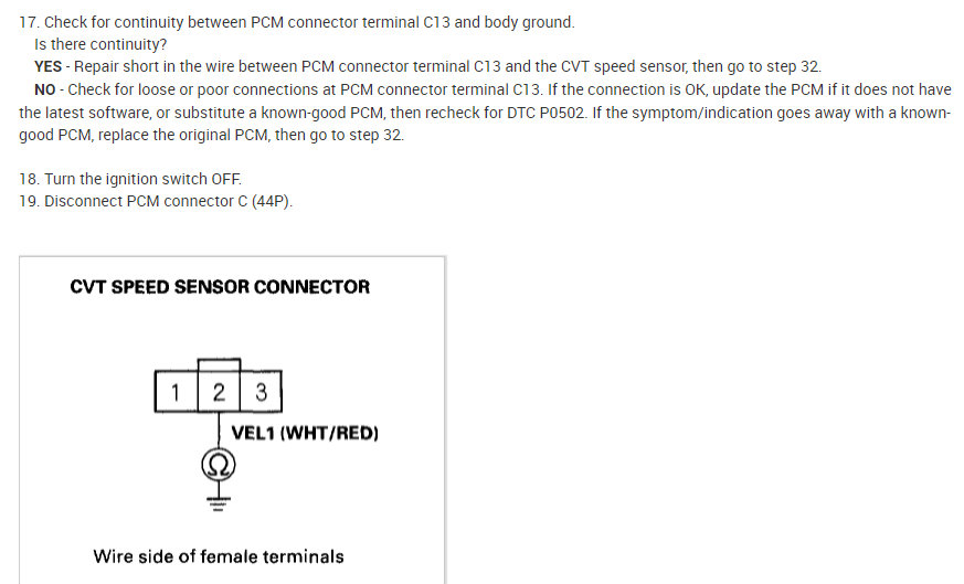

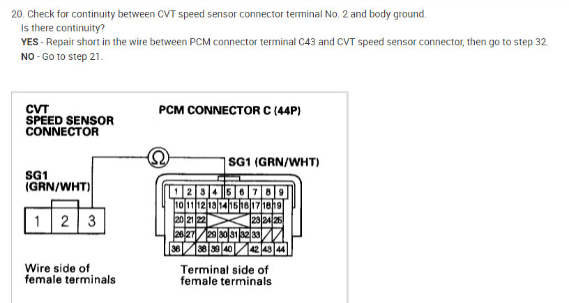

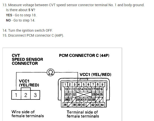

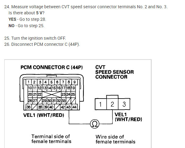

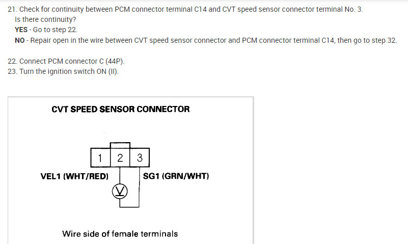

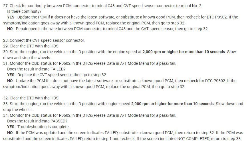

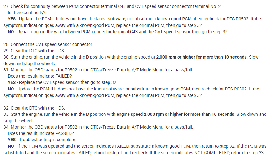

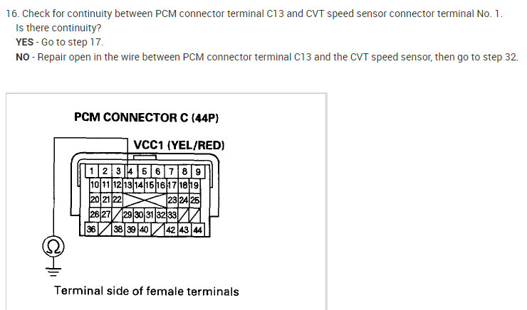

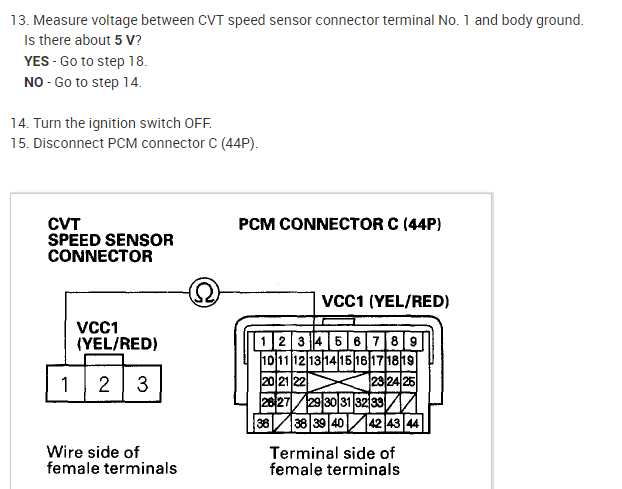

Here is the information you requested. The code is for a problem in the CVT speed sensor circuit. Here is a tutorial showing how to test wiring:
I've attached picture diagnostic flow steps below for your Civic. Let us know what you find and we'll go from there. Hope this helps and thanks for using 2CarPros.

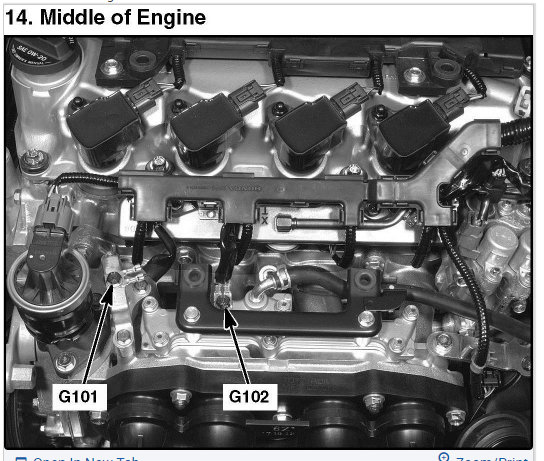

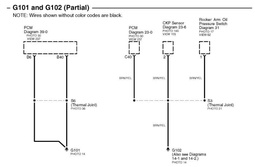

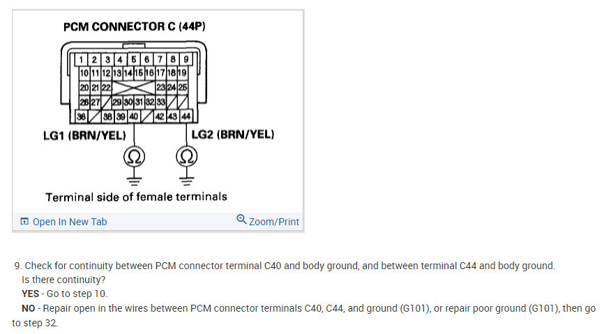

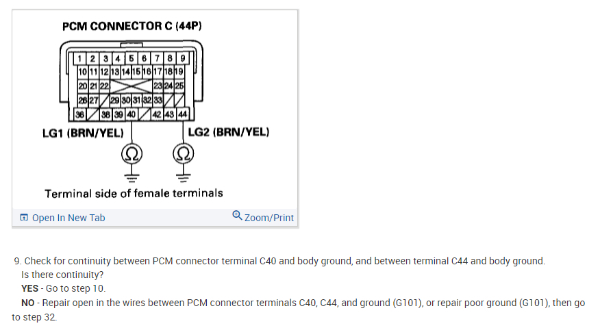

Thanks I did the whole process at some point I didn’t have ground on the ECM connect or C 40 and 44 But. Then I did maybe it’s intermittent

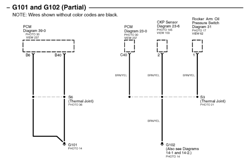

Where is ground g101?
Also this is for the speed sensor on top of the transmission? If the replacement has opposite polarity does that make a difference ?

Hello again.
Here is the information you requested. You will need to replace the sensor with the correct one as to a sensor with reverse polarity will not work correctly. I've attached a wiring diagram and a photo below of the ground g101 you referenced. Here is a tutorial on how to test electrical wiring:
Let us know if you have any further questions on this issue. Hope this helps and thanks again for using 2CarPros.
