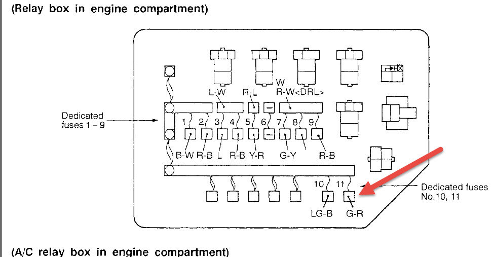

I need the fuse box diagram to determine if the fuse is bad
1999 MITSUBISHI MIRAGE
125,000 MILES • TURBO • 2WD • AUTOMATIC
LIZYARIS VéLEZ CALDERóN
I need the fuse box diagram to determine if the fuse of the stoplight is damaged, or if it is the bulbs. Since I do not know what the exact fuse is. I will appreciate, if you help me. Thank you all.

this is the American version and it is fuse 11 under hood. see picture.

Do you have another diagram? because it does not look like my fuse box. Maybe Japanese version.
Feb 1, 2017 at 12:23 AM
HMAC300
  • 48,601 POSTS
this is only one we have.
