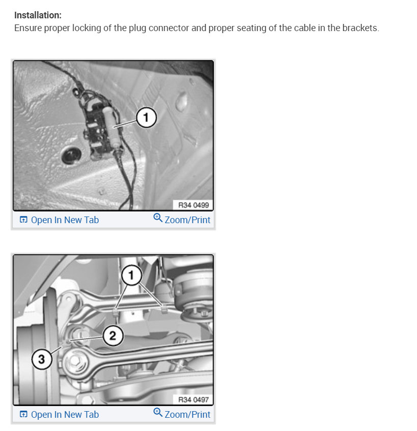

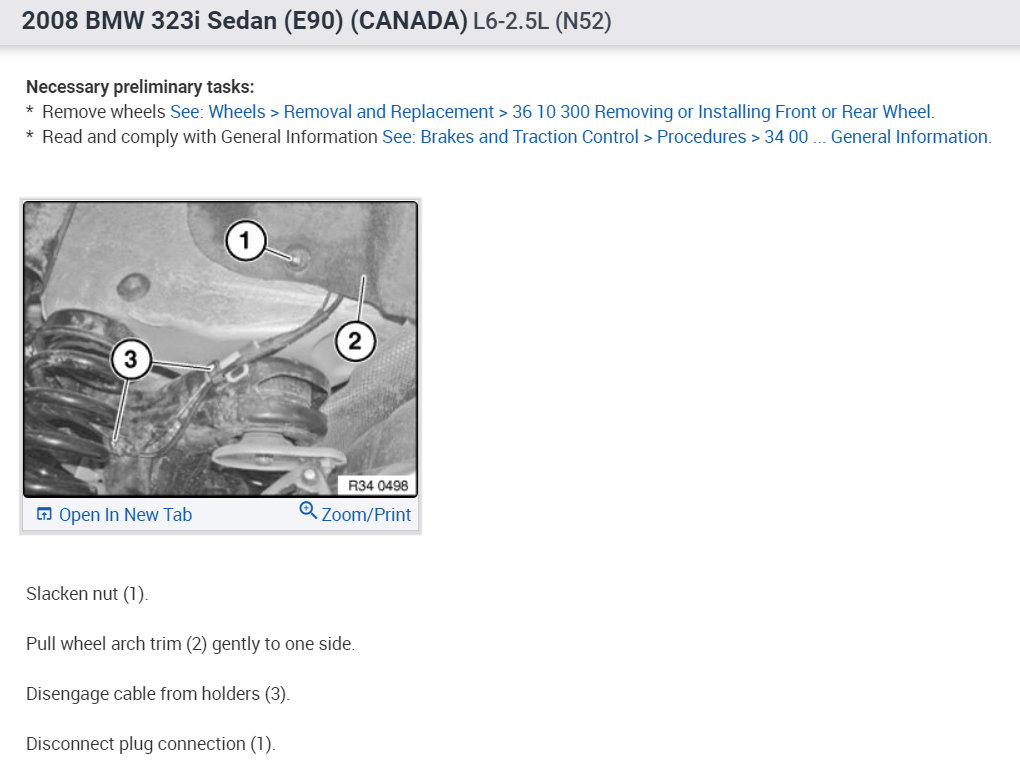

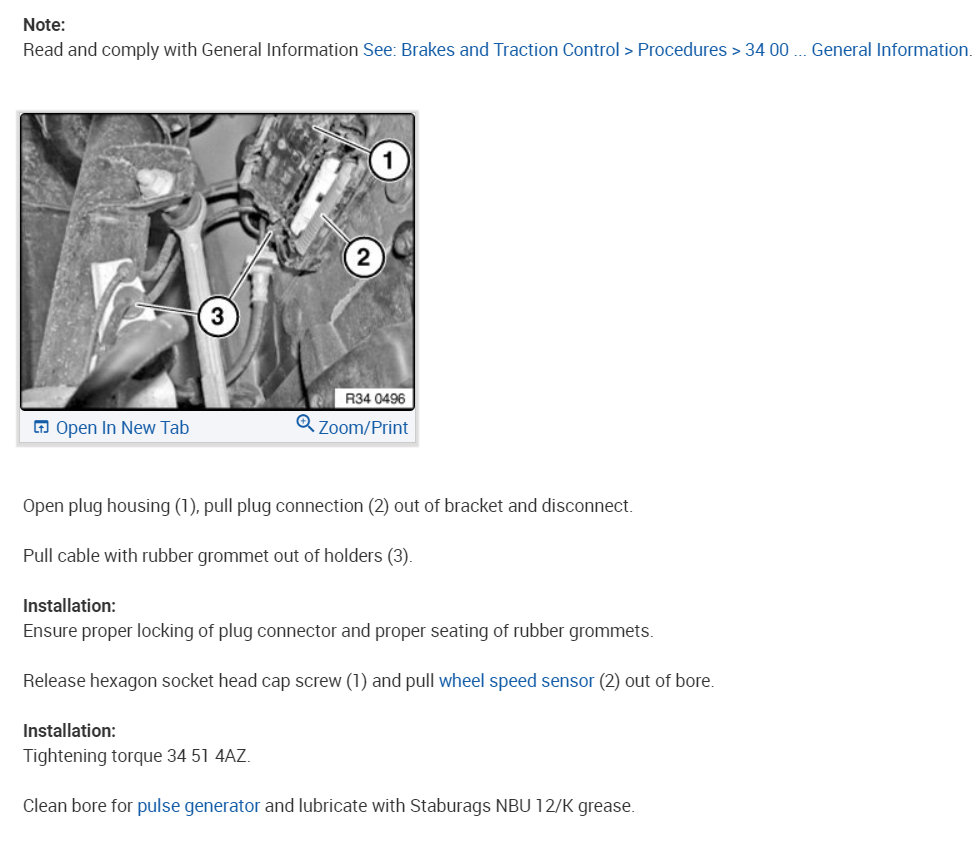

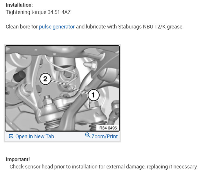

I have the ABS/traction/brake light on as well as the service light with gives code cc-id-207. i really am stuck to what to try now I was told it could be the reluctor rings on the rear shafts but I would like to try some things at home. To keep the cost to a minimum. Any help would be great.

Yep, you are on the right trail. I would look at the ABS wheel speed sensors and axle bearing because when a bearing goes bad it can cause the sensors to stop working. We can scan the ABS to see which sensor is having an issue or you can test them manually by following these videos.
https://youtu.be/rTtAnsOlZU4
and
https://youtu.be/jG18XmUJoNU
