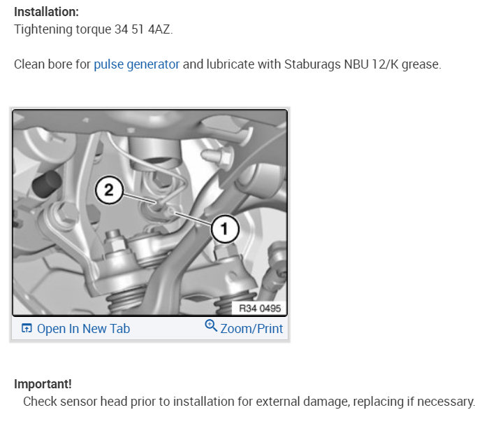

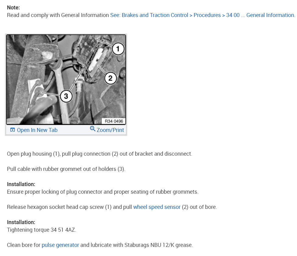

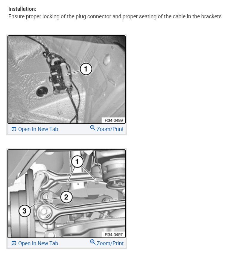

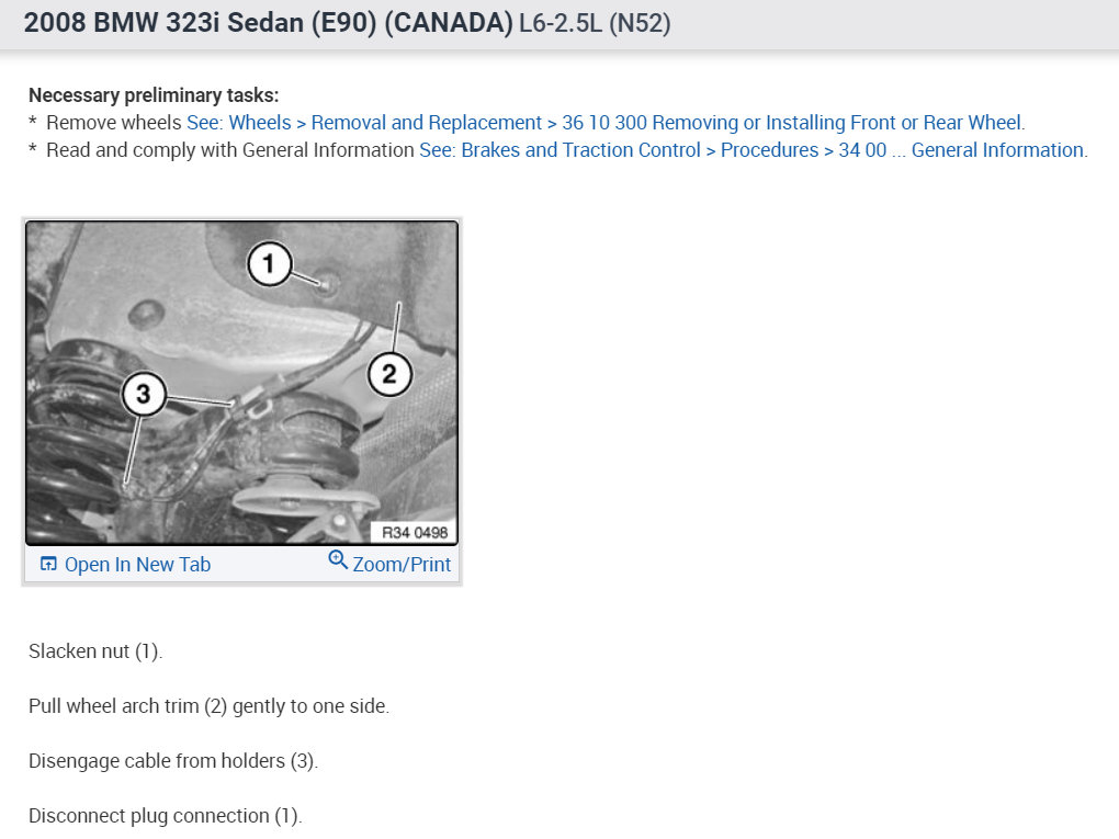

Yep, you are on the right trail. I would look at the ABS wheel speed sensors and axle bearing because when a bearing goes bad it can cause the sensors to stop working. We can scan the ABS to see which sensor is having an issue or you can test them manually by following these videos.
https://youtu.be/rTtAnsOlZU4
and
https://youtu.be/jG18XmUJoNU
