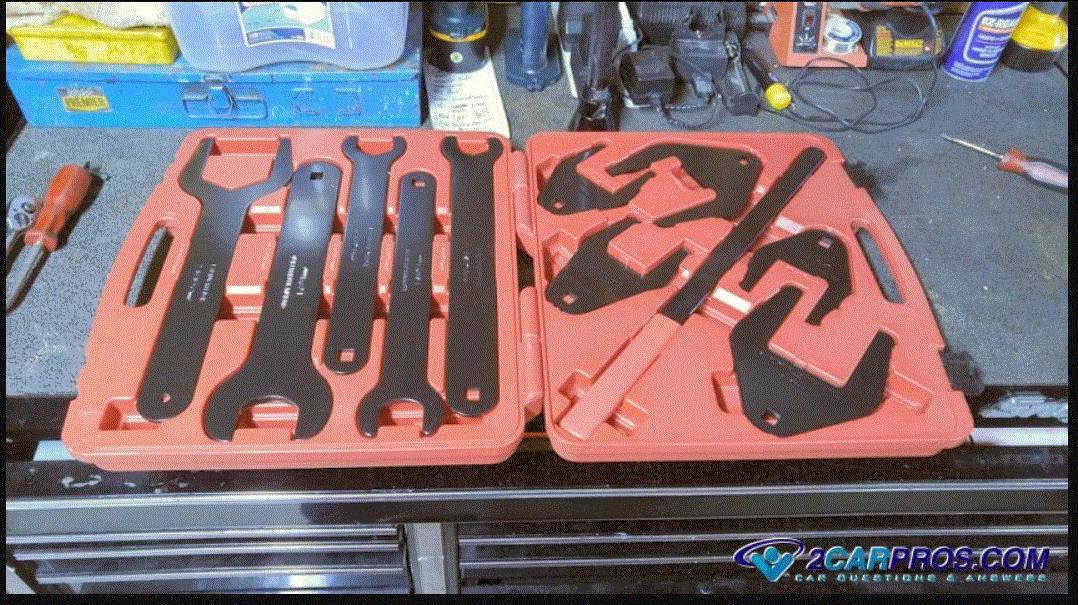

If you determine the fan clutch is bad, here is a link that shows in general how one is replaced. You can use this as a guide.
https://www.2carpros.com/articles/fan-clutch-removal
You will need special tools to remove the clutch, but most parts stores will lend you the tools. See pic 1 below for tools needed.
See pic.
