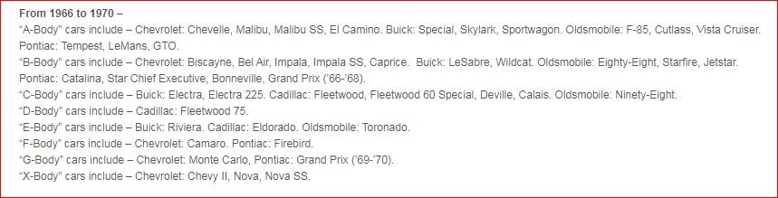

Trying to figure out what 350 it is, engine ID is V0302CNN
1984 PONTIAC FIREBIRD
16,000 MILES • 5.7L • V8 • 2WD • AUTOMATIC
SETH KROGER
Not the stock motor in my car. Engine has approximately 16,000 miles on it. Engine ID is V0302CNN. I have a 350 small block Chevrolet.

So what information are you looking for? Displacement, year, etc?
Hope to hear back from you soon and thanks for using 2CarPros.
Danny-
Jun 5, 2019 at 11:36 AM
V=Plant
03 = Month
02 = Day of month
CNN = Engine Suffix Code

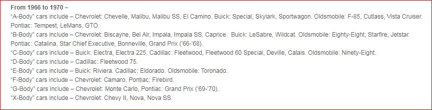

So your engine was built in Flint on March 2 and was intended for a 1970 turbo 350 - 250 HP 2 bbls for an A, F, or X body style. I attached the possible body styles that this could have gone into.
Let me know if you need more information. Thanks
