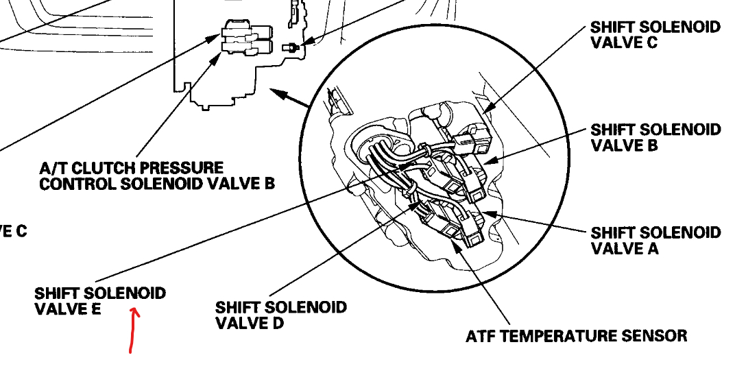

It has a code saying shift malfunction E, what does that mean?

It’s saying shift malfunction E what does that mean?

Can you please give me the code number? I need it to help fix it, but I have seen the shift solenoid E go out and need replacement, here is the location so you can swap it out if needed. Check out the images (below). Let us know how it goes.

The code is p1733. Saying shift malfunction E what does that mean ?????

The code is p1733. Saying shift malfunction E what does that mean?

trouble code (DTC) P1733 typically indicates an issue related to the transmission, specifically with the third clutch pressure switch. So we were correct in replacing the shift solenoid E as in the image above.
