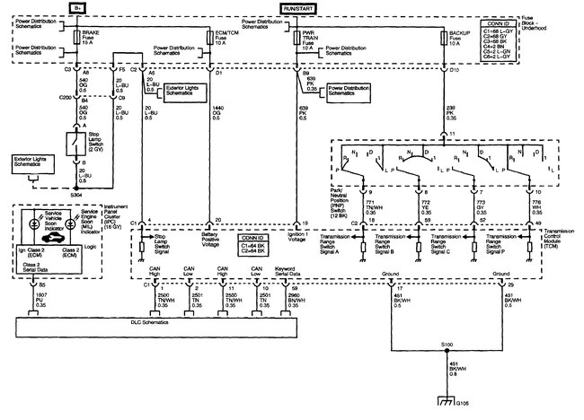

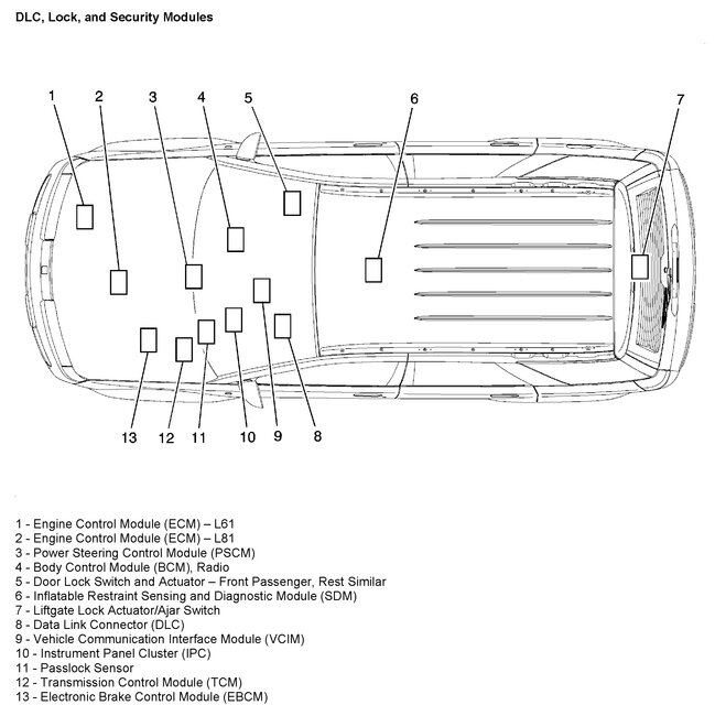

I bought the vehicle listed above off my girlfriends old landlord and I plan on driving it daily but I'm fixing it up myself. I did a code reading that came up as 0700 and 0701 which of course deals with the transmission control module. I am trying to locate the TCM under my dashboard on the driver side but I'm just not seeing it or its in a different location of the of my car. I even checked under the hood as well and I'm not seeing it either. When I look online for what I'm looking for it brings ECM etc., but not the TCM.

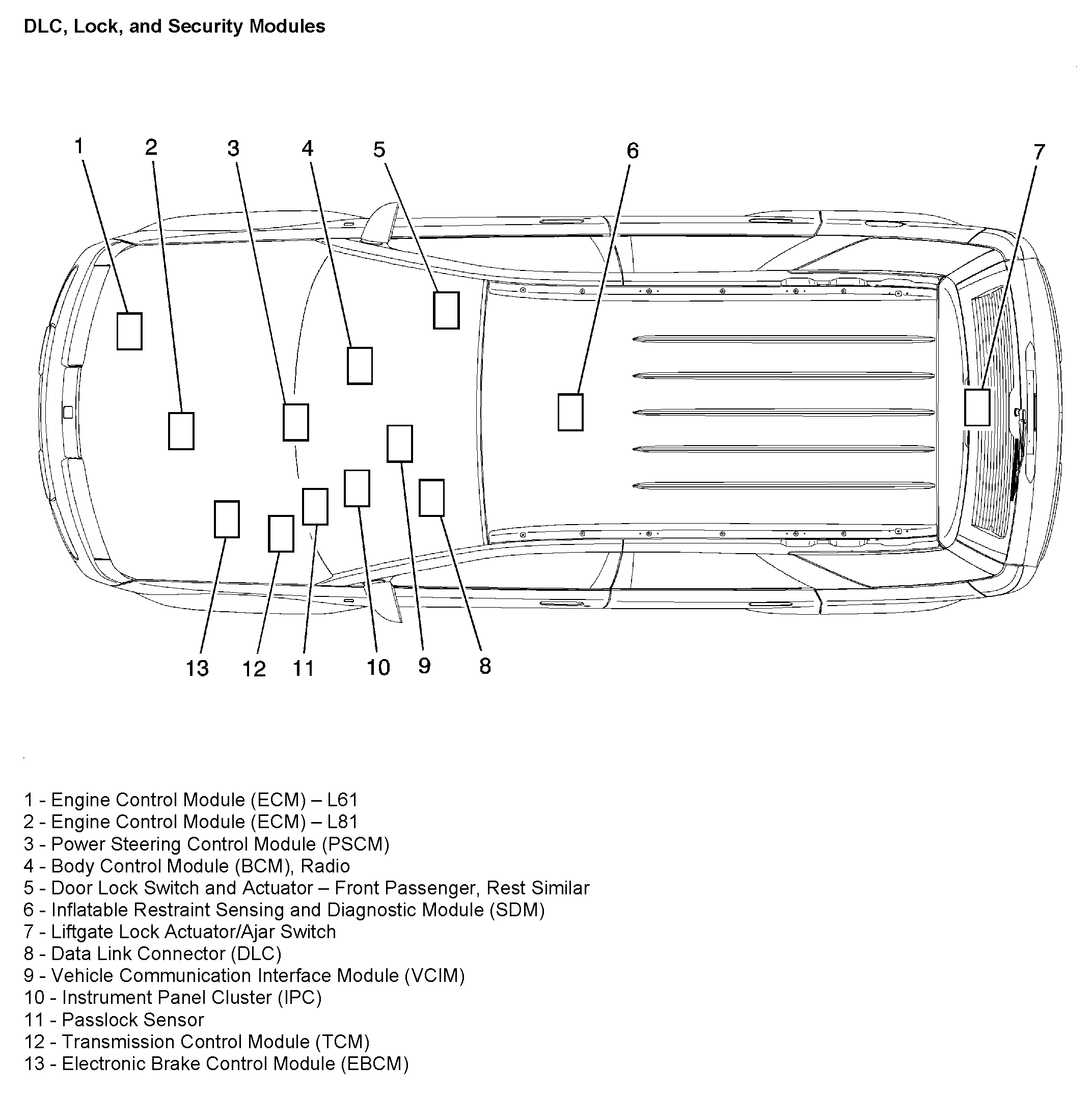

It's under the left side dash next to the steering column. it you have a bidirectional scan tool it can be reprogrammed.

Here is the location chart. please click the image below its number 12 on the chart.
Sep 2, 2025 at 12:45 AM
MECHTRIX
  • 417 POSTS

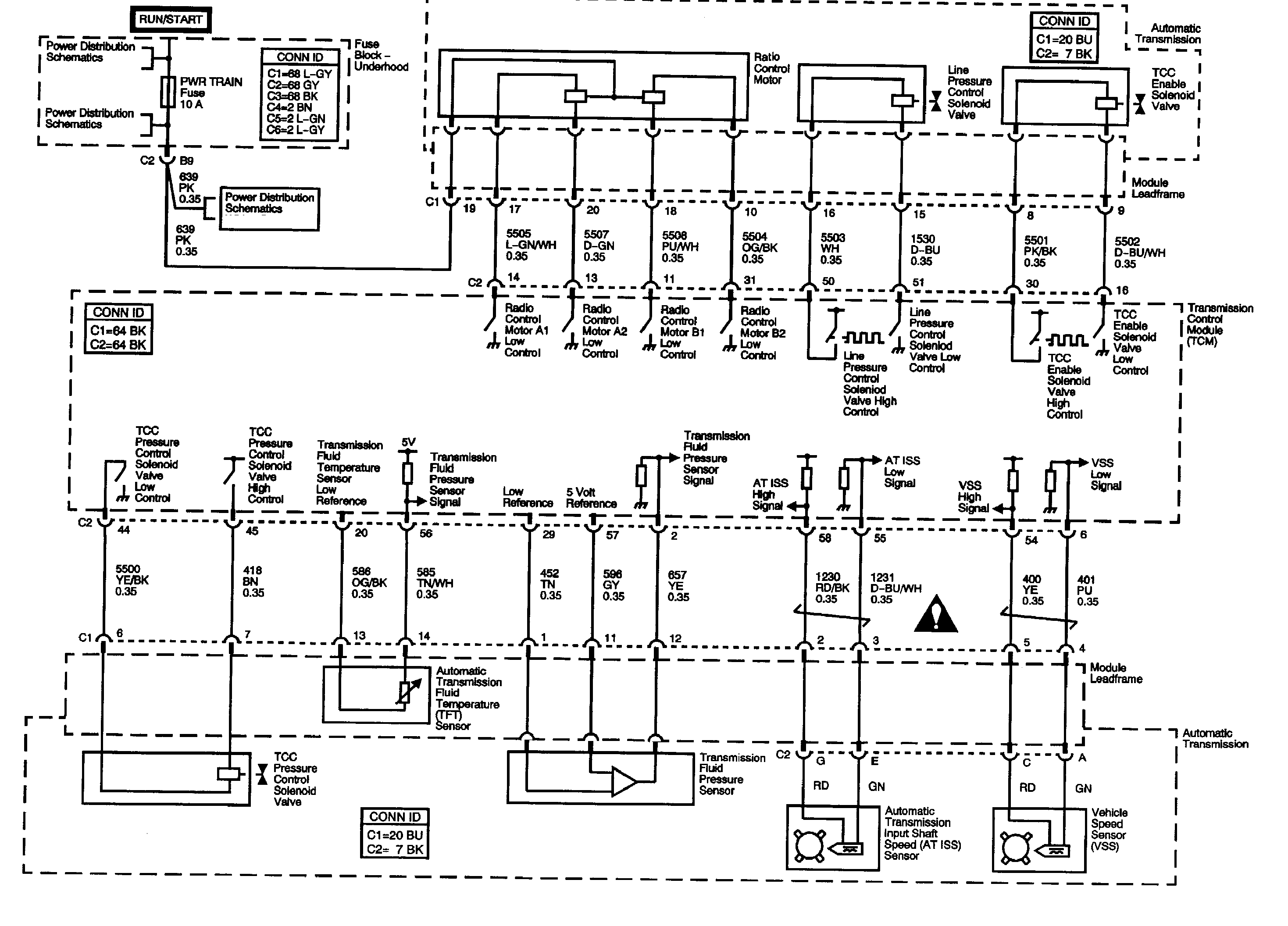

Here are the 2 diagrams for the transmission controls.
