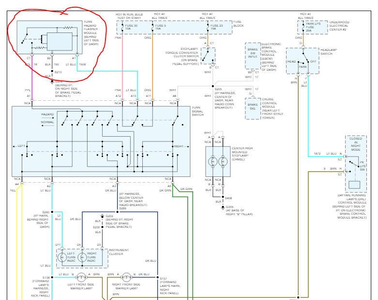

My turn signals are not @had my hazards on for to long could that have burn out the relay and where is it located at.

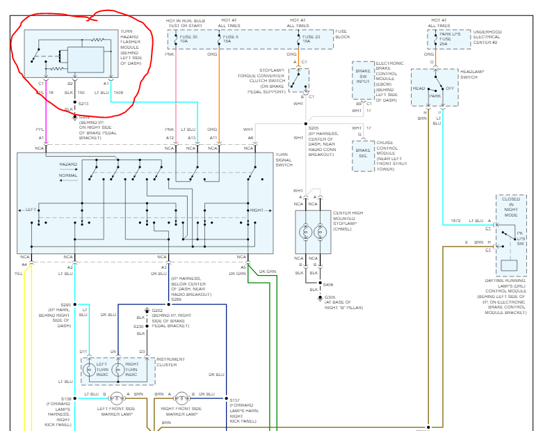

There is a module for turn/hazard located under the left side of dash.Here is a tutorial showing how to test:
https://www.2carpros.com/articles/how-a-car-electrical-system-works
I've attached a picture below of the wiring diagram for you.Hope this helps and thanks for using 2CarPros.
