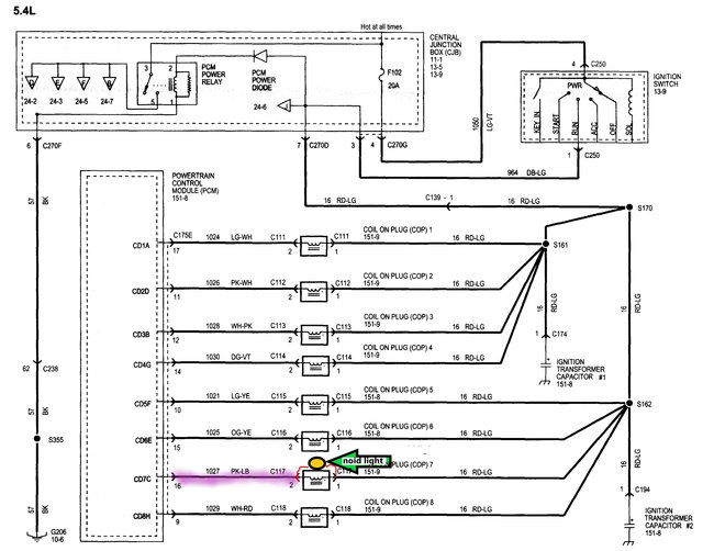

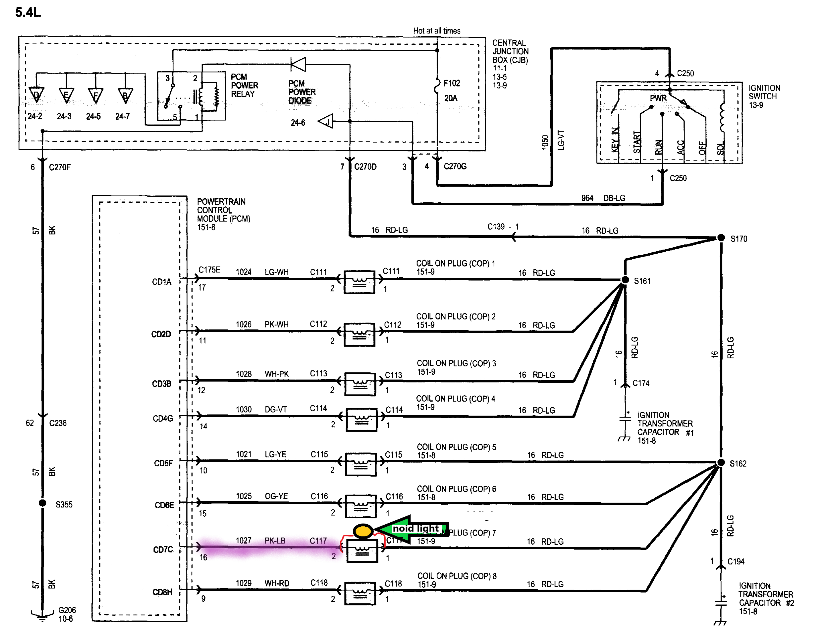

We replaced the spark plug, ignition coil and throttle body. it also has a code for the crank 2 sensor low voltage. Code P0357
Sep 14, 2019 at 11:32 PM
BMDOUBLE
  • 1,139 POSTS
P0357 is for cylinder 7 coil primary circuit fault. I've attached an illustrated diagram for the circuit in question so you can reference and test with a noid light. Cylinder 7 will be on the driver side second from the rear.
