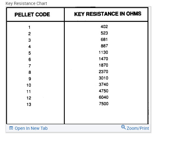

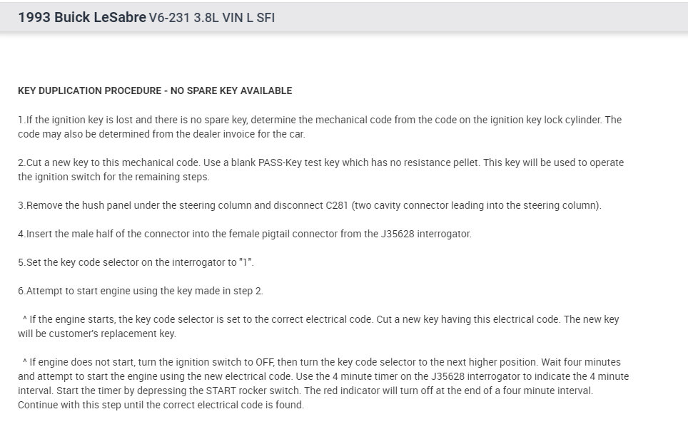

Okay, well, I did and it turns it to own but the security light is flashing and then I have found out that the keys that they sent with the new ignition it's just a template I guess where they can cut it another key but I don't know what kind of oums or PassKey 2 to that was on my car.
Jul 8, 2023 at 1:22 PM
  • 110,244 POSTS
I attached directions below for programming a new key. The issue is it requires specialized tooling. I also attached a list of key resistances.
At this point, you likely need to get a locksmith or a dealership. I wish I had a better answer, but because of the model year, it may be hard to find someone with the right programmer.
