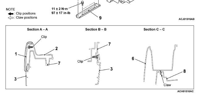

A charm from my bracelet fall into the emergency brake slot, how to get it out?
2021 MITSUBISHI OUTLANDER SPORT
10,000 MILES
TDMCNAIR819
And some change too. How can I get it out?
May 29, 2022 at 5:12 AM
  • 55,221 POSTS
You would be surprised at how often this happens. Try to use a flashlight and one of these tools i see if you can fish it out of there. "Terrarium plant grabber"
https://www.amazon.com/Esschert-Design-USA-GT168-Terrarium/dp/B07YBDM3RR/ref=asc_df_B07YBDM3RR/?tag=hyprod-20&linkCode=df0&hvadid=589635262953&hvpos=&hvnetw=g&hvrand=14534060434997523402&hvpone=&hvptwo=&hvqmt=&hvdev=c&hvdvcmdl=&hvlocint=&hvlocphy=9031538&hvtargid=pla-1839480890872&psc=1

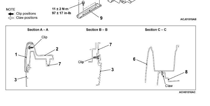

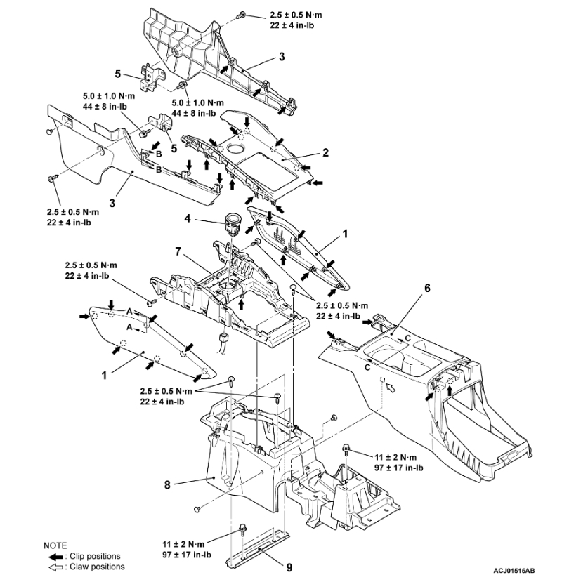

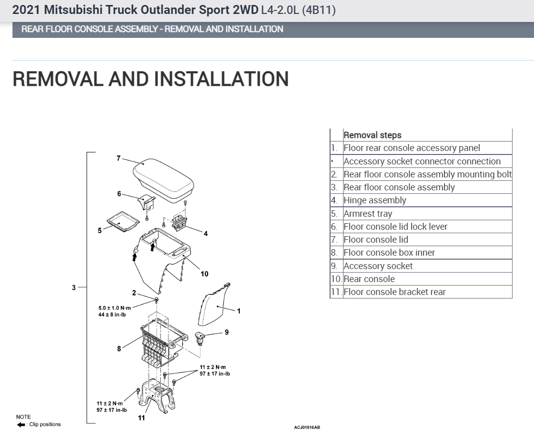

If not, we will need to take the center console off here is how. Check out the diagrams (below). Let us know what happens and please upload pictures or videos of the problem.
May 29, 2022 at 9:41 AM
