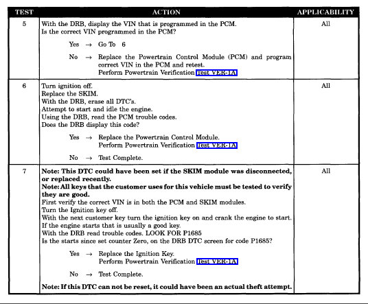

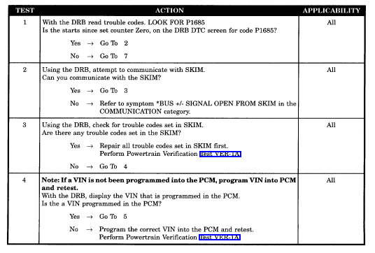

I am going to provide several flow chart images which are for problem solving this code. You will see the acronym DRB, which is Chrysler's name for their scanner. If you have a good scanner, it should work.

This condition exists when the transponder ID (KEY) read by the SKIM does not match any of the transponder ID's stored in the SKIM's memory. The following could be new or does not match, PCM, SKIM, or KEY.
POSSIBLE CAUSES
Incorrect VIN in PCM
invalid SKIM key not present
NO VIN programmed in the PCM
PCM defective
SKIM trouble codes set
Go through these and let me know what you find or if you have questions.
