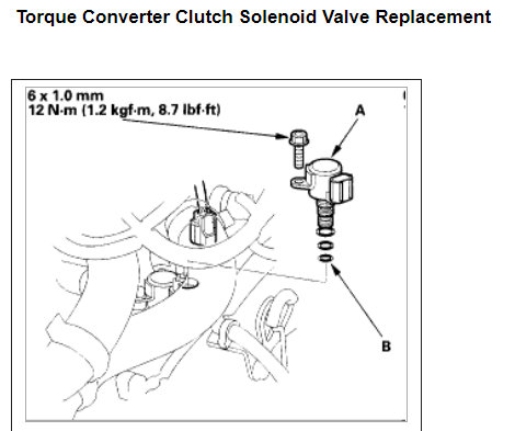

I changed my oil pan and I gottwo codes p1768 and p1753 and my d5 light keep blinking. Also my TCS light is on. what can be the problem?

That code is for your TCC solenoid operation malfunction. This can mean the solenoid is not working or the torque converter is having a problem. I would try the solenoid first. Below is its location.

https://www.partsgeek.com/assets/rep/full/1035607.jpg is this the part?

Sure looks like it

Can u please look it up n tell me please

Yep that is the part.
