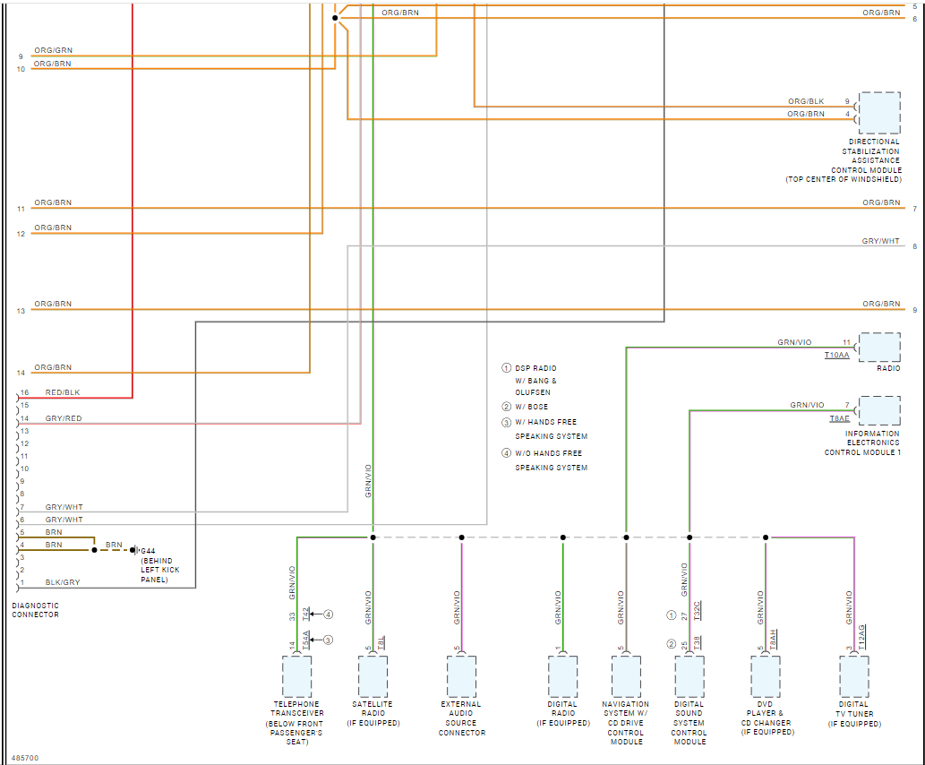

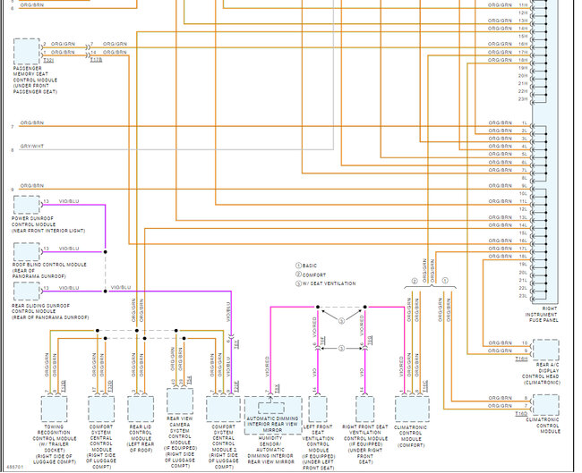

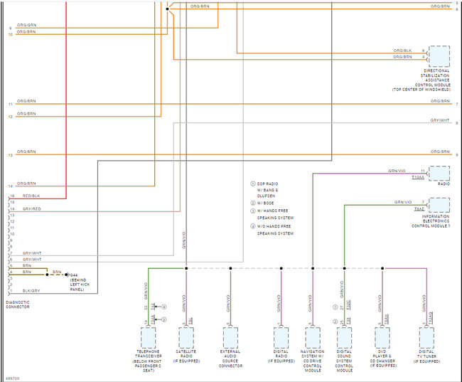

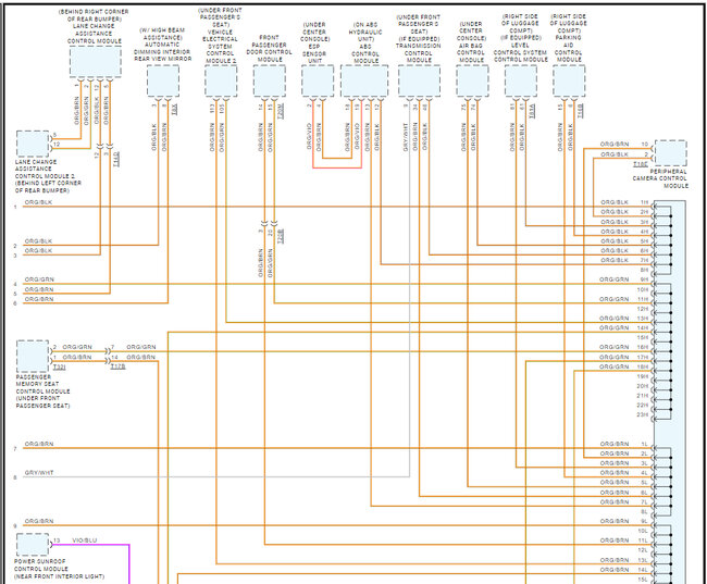

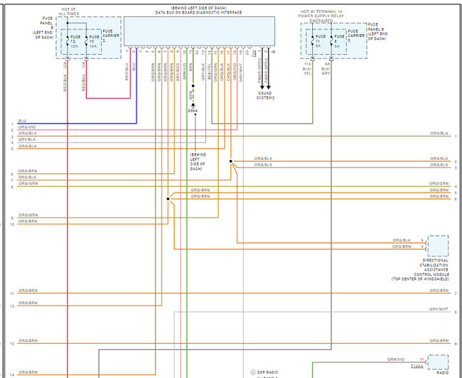

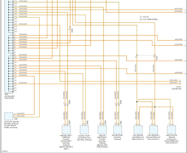

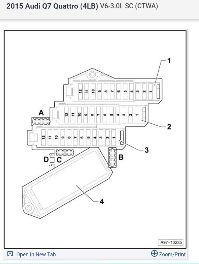

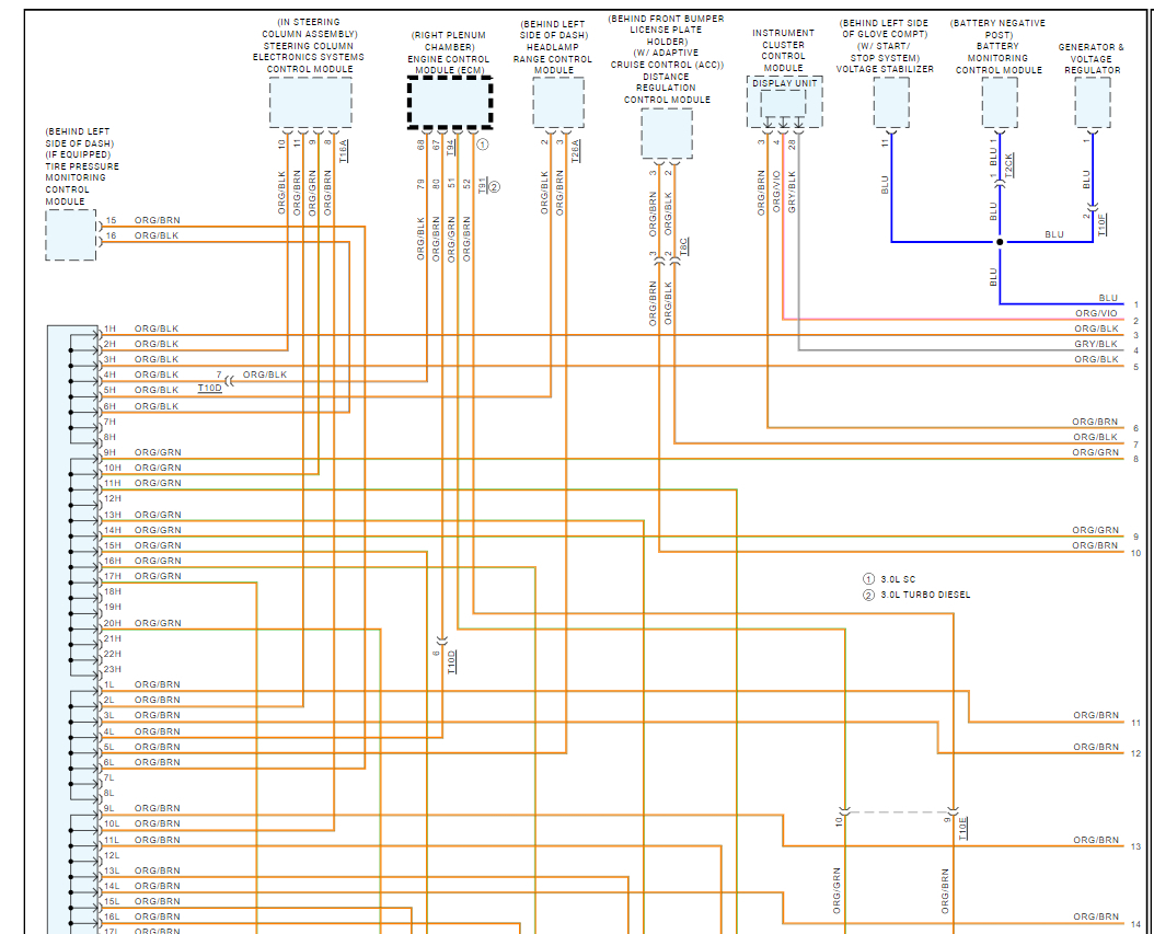

Hi, please I have an issue with my Audi Display screen not turning on, can I please have a diagram for the network wires and voltage signals for Can H and Can L? It fault tells me no communication, which is the 2 wires. A diagram of the network bus will help me solve this issue. Thank you.
Audi Q7 3.0 Tfsi supercharged Quattro.
Sep 30, 2024 at 11:55 AM
  • 55,721 POSTS

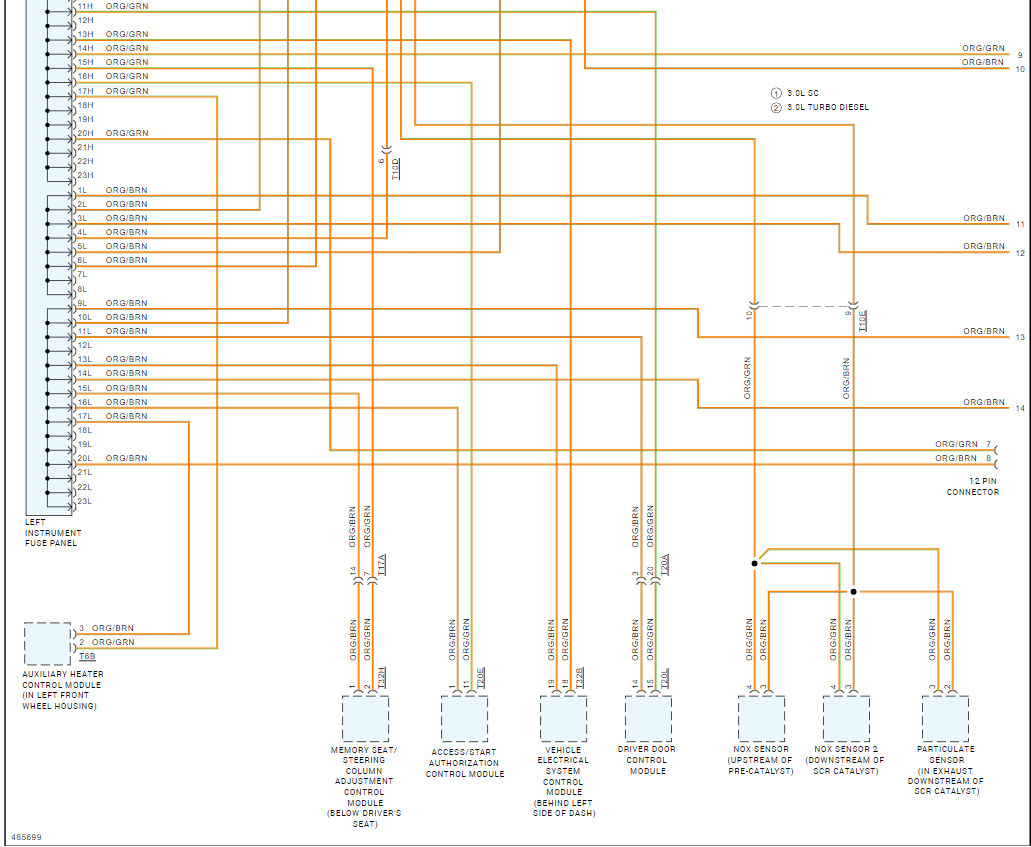

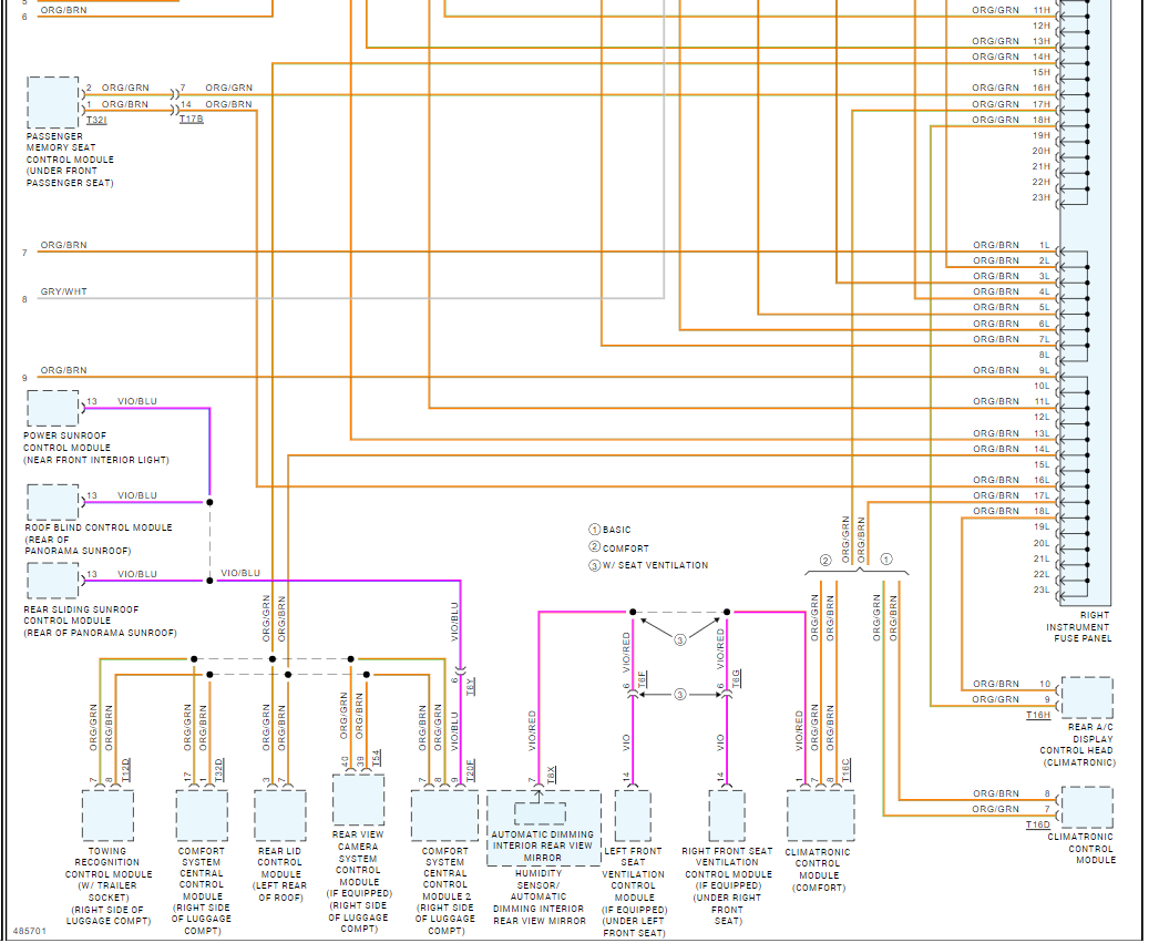

Hi Andrin,

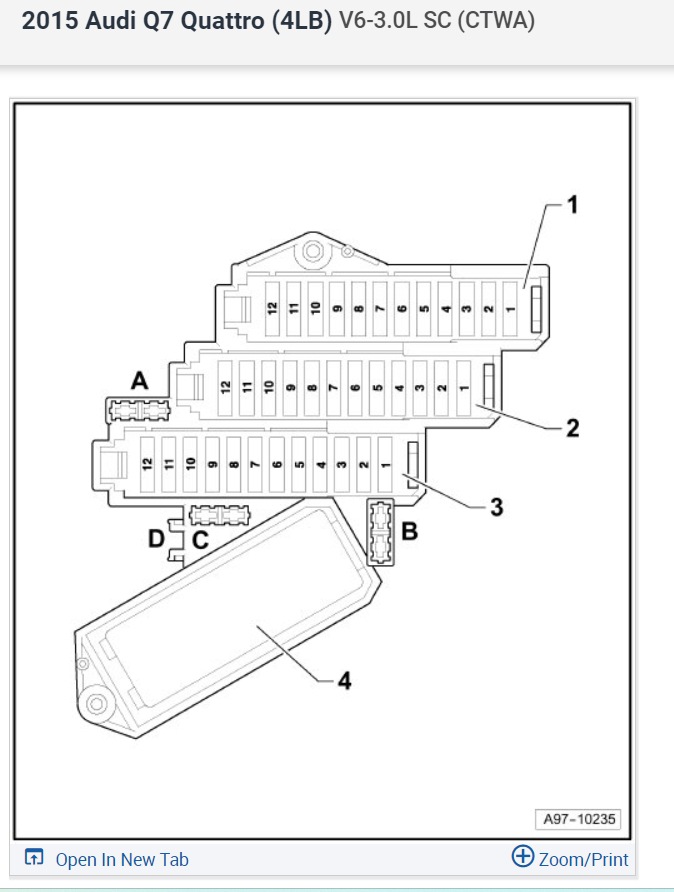

Here are the wiring diagrams for the BUS circuities and the display itself. I would check fuse # 12 and #10 in the fuse panel on the left side of the dash, and the fuse # 11 and #8 in the same fuse panel.
Here is a guide to help and the fuse locations as well:
Oct 1, 2024 at 7:43 AM
