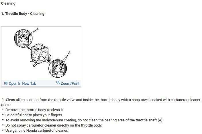

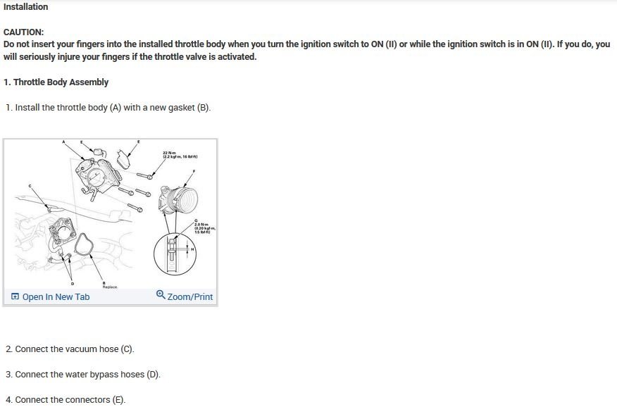

Hi. I have a serious problem right now. When I remove my foot from the gas pedal, the car continue to accelerate. The gas pedal doesn't get stuck but speed keeps increasing. When I press the brake it only maintains the speed. It does not slow down my car and it does not even stop it. I can only drive at 40km/h and press the brake pedal to maintain that speed. I don't know what else to do.
Mar 1, 2019 at 4:47 AM
HARRY P
  • 2,292 POSTS

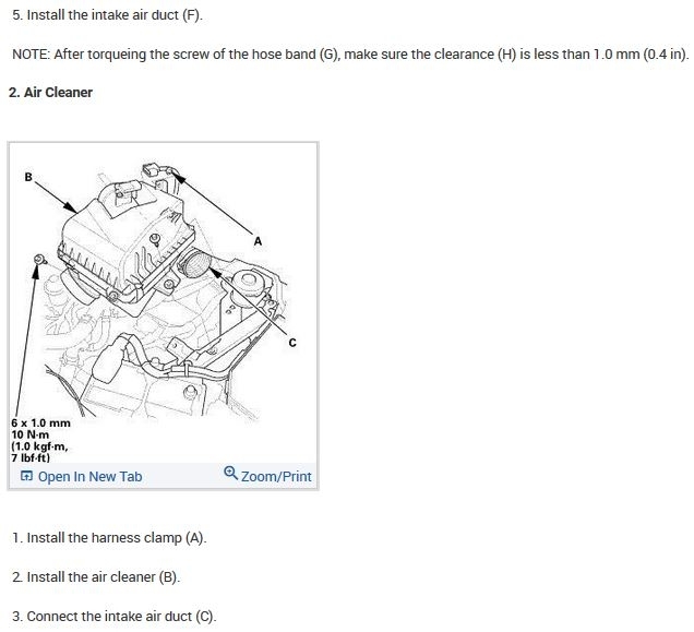

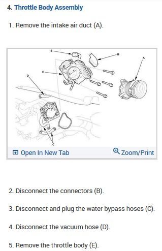

Hello and welcome to 2CarPros. Is the service/check engine light on? If so, take the car (carefully) to the nearest chain auto parts store and have them scan it to retrieve the trouble codes. Report the trouble code numbers (not their descriptions, but the actual numbers) here. Then we'll have some insight into what the problem is.

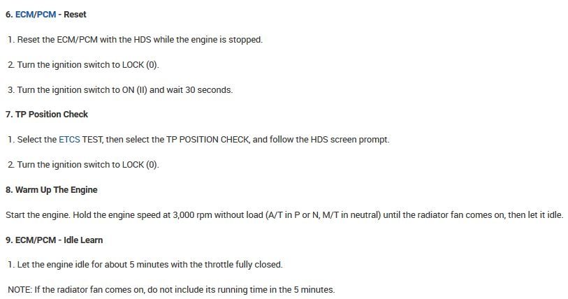

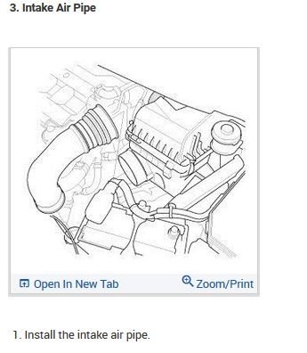

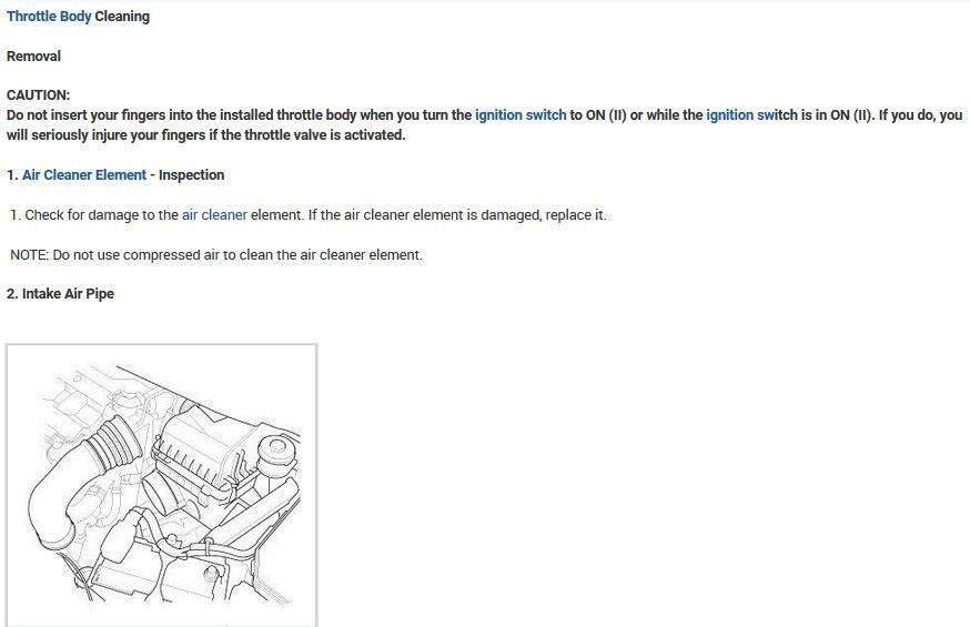

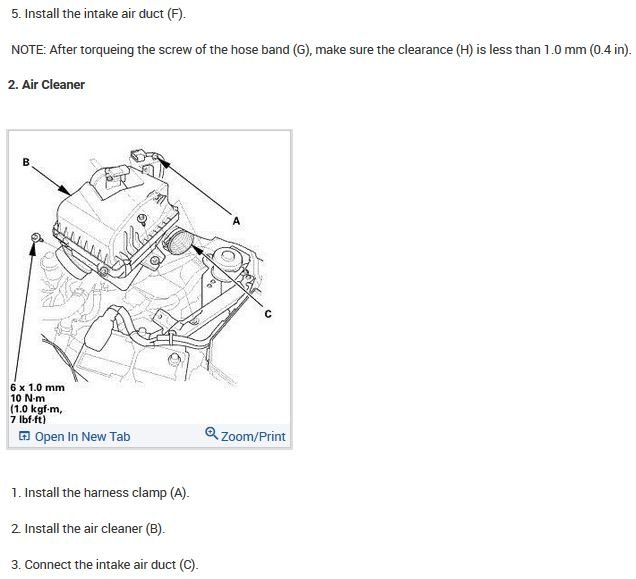

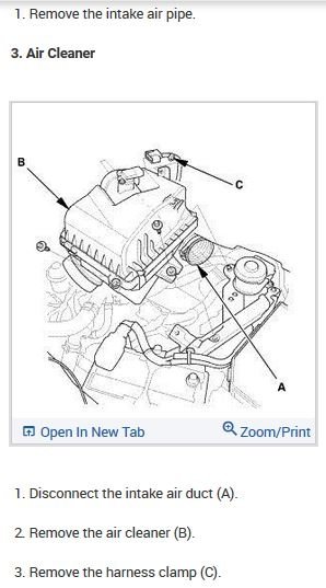

If the service engine light is not staying on, then I'd bet on a sticking throttle actuator or a bad idle air control valve. Either one would definitely cause the engine to run too fast and could do so without the computer setting a trouble code and turning on the service engine light.
I'm including AllData's how-to information on cleaning the throttle body in the images below. Some of it (particularly the last three steps of installation) require some tools that you don't have access to. But here's a YouTube video that will help you circumvent those steps:
https://www.youtube.com/watch?v=YtundPqtKww
and
Check out the diagrams (Below). Please let us know what you find.

Have you tried cleaning the throttle body as detailed in my prior post?
Mar 3, 2019 at 4:05 AM
MENDYZOEY
  • 15 POSTS
Yes, the gas pedal seems okay, but brakes still not good.

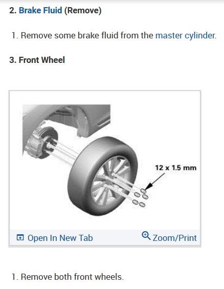

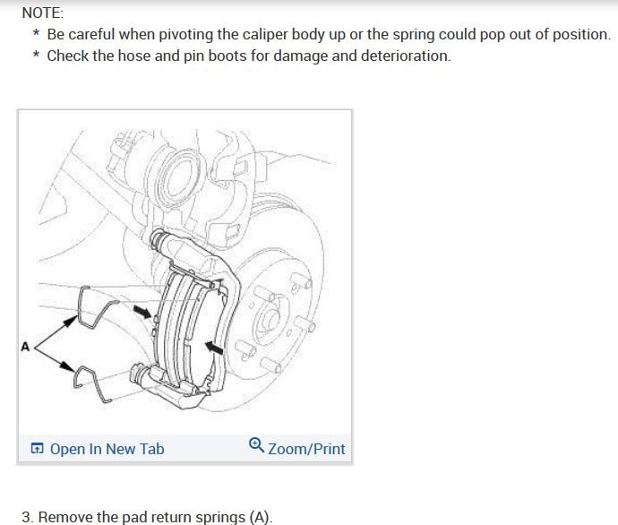

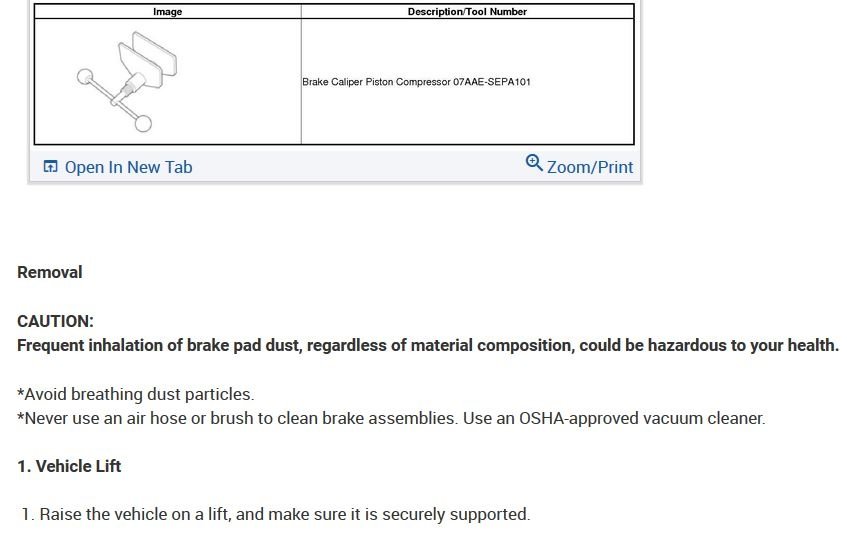

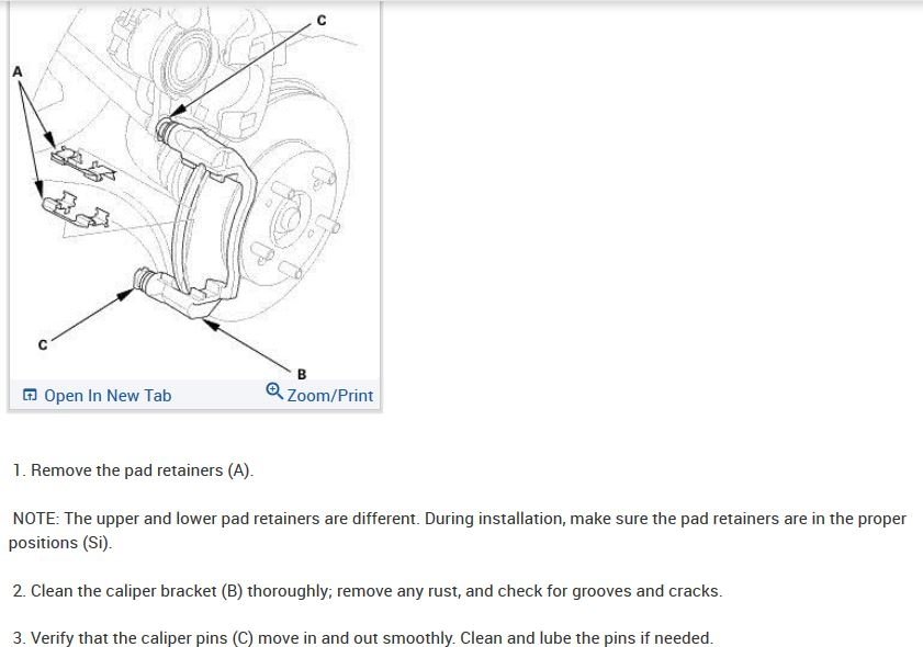

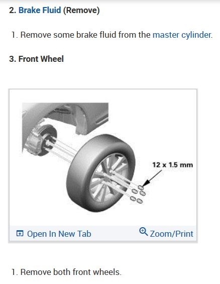

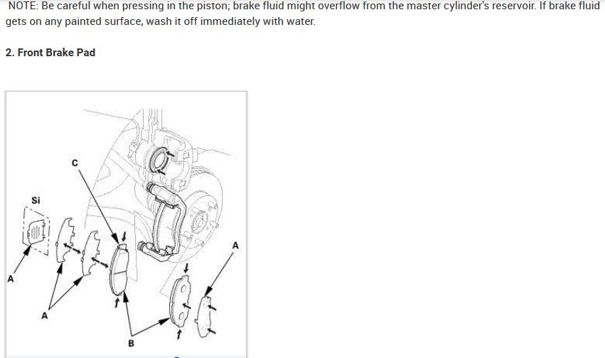

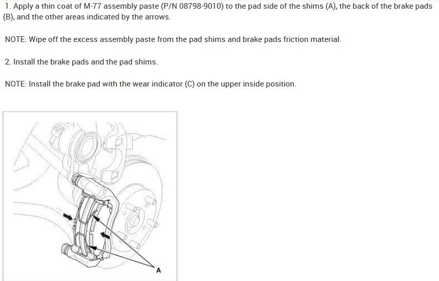

So to be clear, the gas pedal is not operating the way it should. When you let off of the gas, it stops accelerating, right? If so, then we're off to a good start.

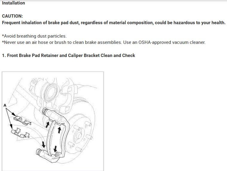

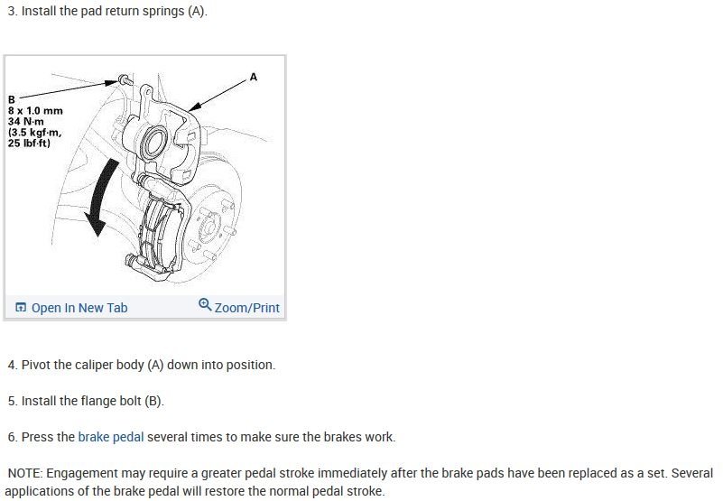

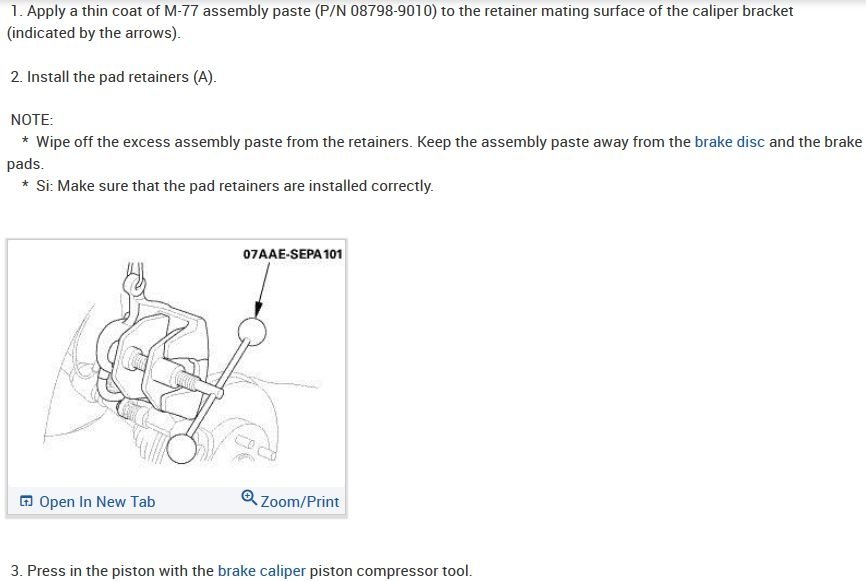

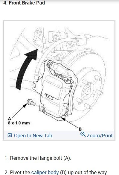

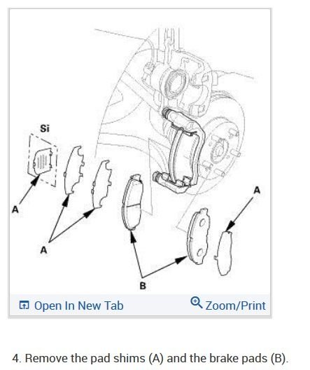

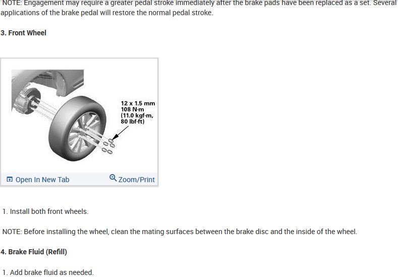

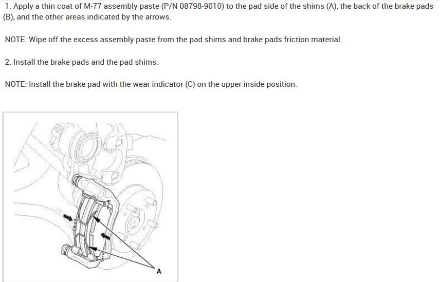

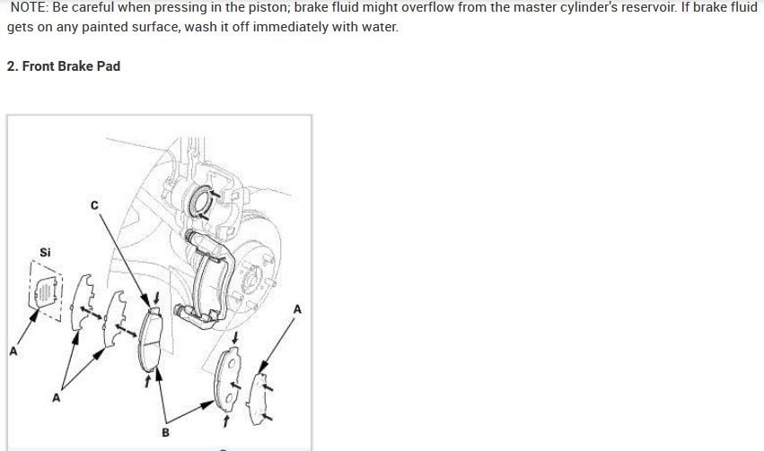

Driving the car with the brakes pressed has probably worn out the pads. It might've even overheated the rotors, causing them to warp a little bit. If the car is shaking when you push the brakes, then the rotors have definitely warped. It's probably time to change the brake pads. And if the car shakes when pressing the brakes, then you should also take the rotors and get them resurfaced. I can get you instructions on how to do that if needed.
I'm including AllData's instructions on how to change the brake pads on your car in the attached images. Also, I have some additional tips: (1) Take pictures as you go through the process, so you can reference them if needed. (2) You probably don't have a lift at home, so use a jack and back it up with a jack stand under the frame of the car. (3) If you've not added brake fluid to the master cylinder, do not remove any. If you have added some, don't worry about it just yet, excess will come out on it's own in a later step, just wash it off of the painted surfaces quickly. (4) You can use "brake parts cleaner" that the auto parts stores sell to clean things up. (5) Spray some "white lithium grease" on the caliper pins to keep them lubed. (6) They sell a suitable assembly paste at the parts stores, just use that instead of the "M-77 Assembly paste." (7) A larger c-clamp can be used in place of a brake caliper compressor tool, just put an old brake pad on the caliper piston so the clamp doesn't damage the piston. (8) Be absolutely sure to push the brakes all the way at least 10 times before driving anywhere, or you'll be driving with no brakes at all. Also, you can do this entire job with a basic set of wrenches (metric sizes) and a 6 inch or larger c-clamp without trouble.
Here's our general how-to guide on brakes: https://www.2carpros.com/articles/how-to-replace-front-brake-pads-and-rotors-fwd
I'm also including a link to a youtube video (not one of ours though) on doing the brakes on your car: https://www.youtube.com/watch?v=RktXFq_1XrU
Hopefully this information helps you.
