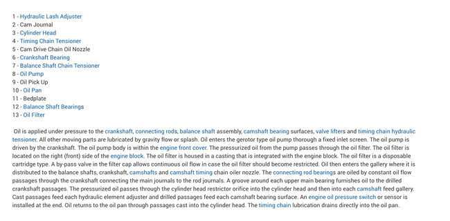

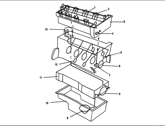

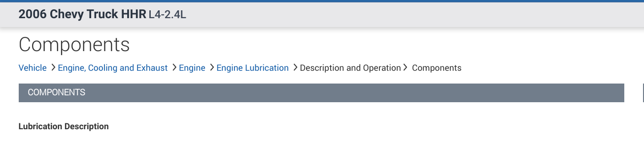

I hate to be the bearer of bad news, but there is no automatic shutdown for low oil pressure on your vehicle. In the diagrams down below I have included a full description of the oil lubrication system for your vehicle. Please go through this guide and get back to us with how everything turns out. Sorry.

Thank you for the diagrams. Does that mean you think the reason the car turned off was because the engine seized? I have driven a car to the point it seized before. In my defense I bought the car for $200.00 and it was a long time ago. My car now did not act like that. My husband is thinking to put some JB weld on the hole, let it set, put some oil in and see if it holds enough to turn over. We don't have money to buy a new pan for an engine that is trashed. I am so grateful for your quick response!

That was exactly what I was thinking. But even though it has a kind of bad name, JB Weld is an excellent product that works quite well. It should have no problem repairing the hole in the oil pan and then we will see with oil put back in the engine. Like they say the proof is in the pudding. Please let us know how it turns out.
