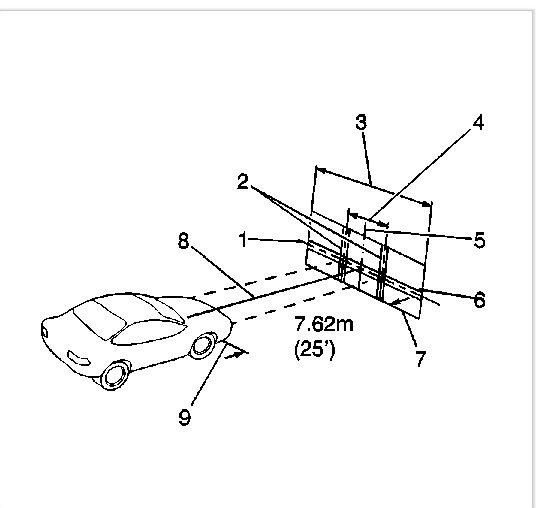

How do I aim my head light? Does my car have an antenna? If so where? It does have OnStar but not active.
Oct 15, 2018 at 5:43 AM
WILLIAM CRABTREE
  • 95 POSTS

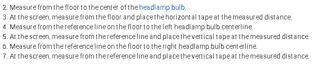

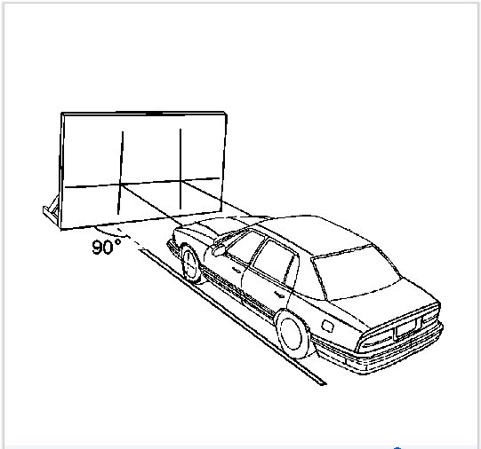

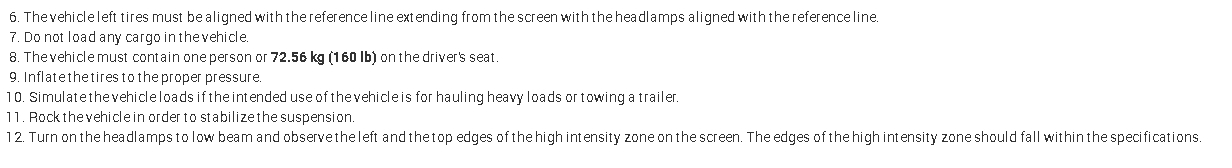

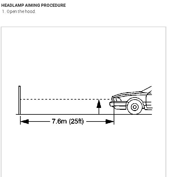

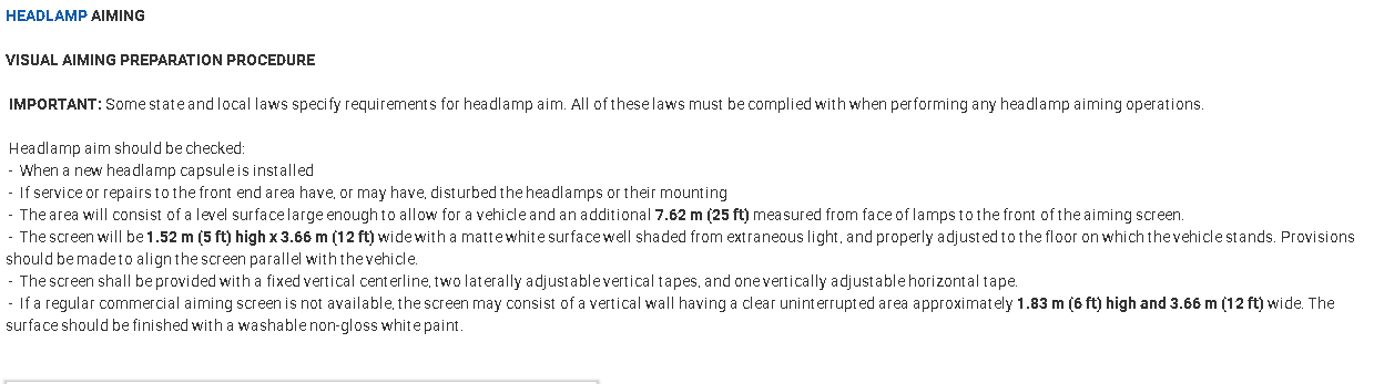

Technically, you have asked multiple questions. I have attached instructions on how to adjust your headlights. As far as the antenna, they are usually integrated into the glass on the rear window.
Hope this helps, and keep me posted!
