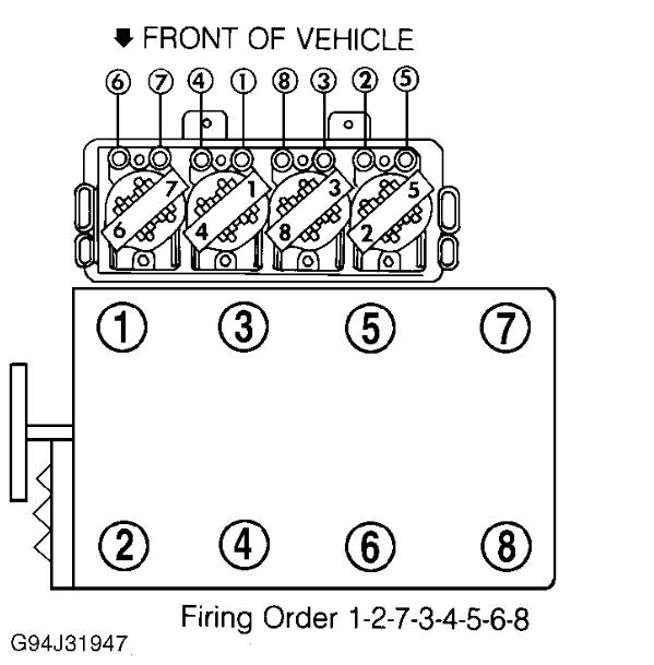

I romoved the plastic cover and found 2468 can't find 1357. But it also have been not starting like it's not getting gas and it's cutting out and backfiring I just need like a image or a video to show me but the other prom las is a big dill if it dose start it only goes like 25 and it takes a long time to get there please help.

don't know what you r numbes mean but scan for codes and check fuel pressure first with a guage autoparts rent

spark plugs in middle of valve covers there may be a cover over them. see pic for rest
