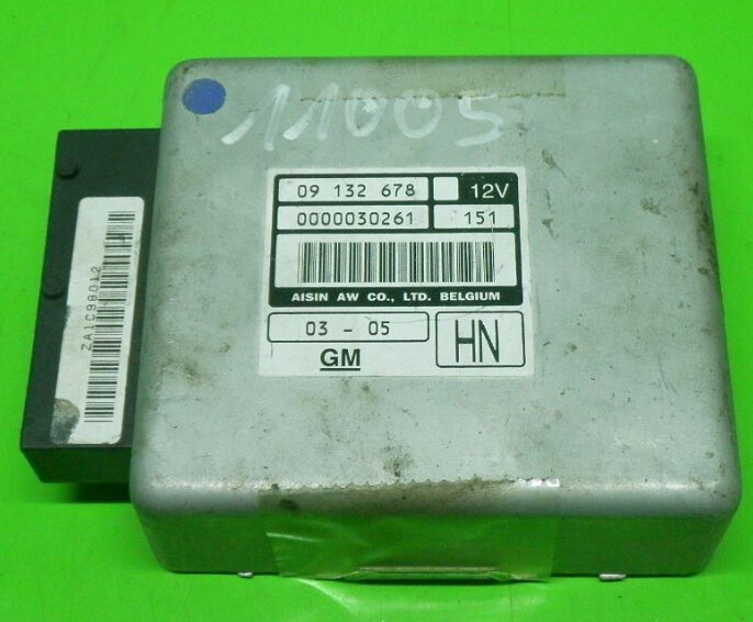

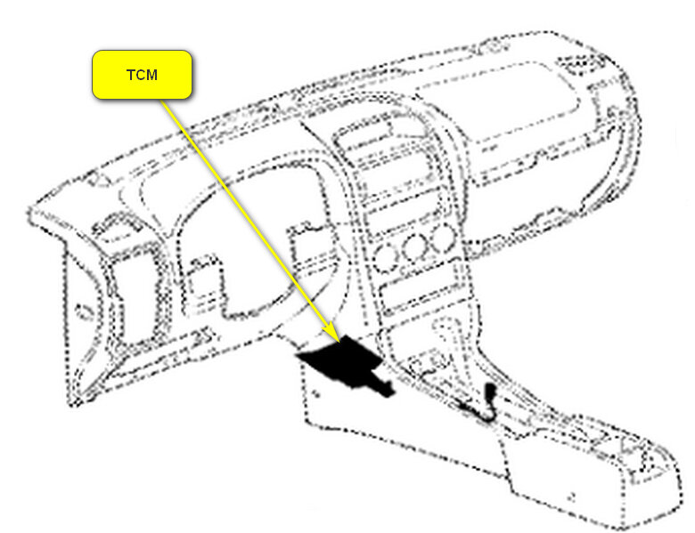

Please where is the automatic gearbox ECU located in the vehicle listed above?
Aug 26, 2023 at 12:14 AM
BORIS K
  • 836 POSTS
The Transmission Control Module, TCM, is located under the center console, heater box, on top of the center tunnel. See image 1.

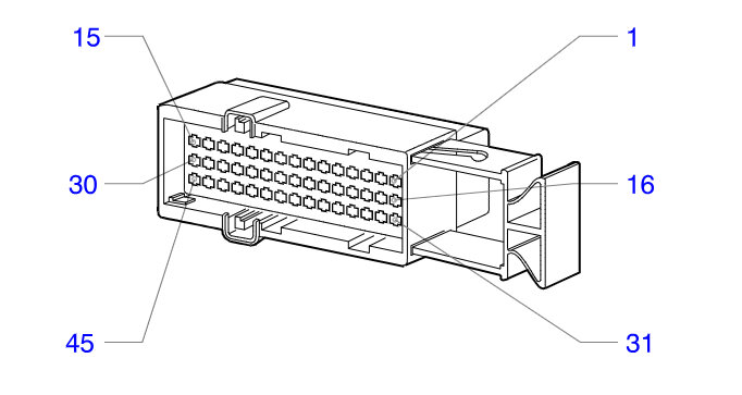

The TCM has a single, 45 pin black/brown, connector.

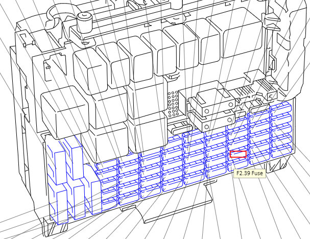

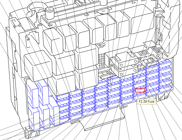

Pin out at the connector for 12V supply and ground.
Pin 16, red wire 12V from fuse F2.39 on instrument panel fuse block, see image 3.
Pin 31+32, brown wire ground.
You can check these using a voltmeter.
