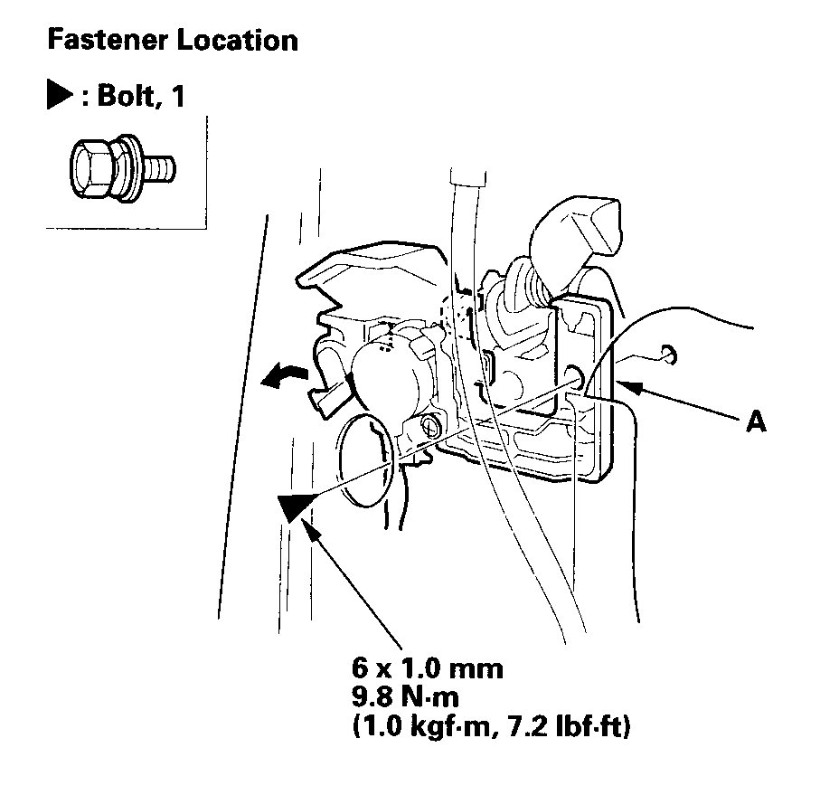

I cannot disarm the alarm on my car
2007 HONDA ACCORD
200,000 MILES • 2WD • AUTOMATIC
LESSAB

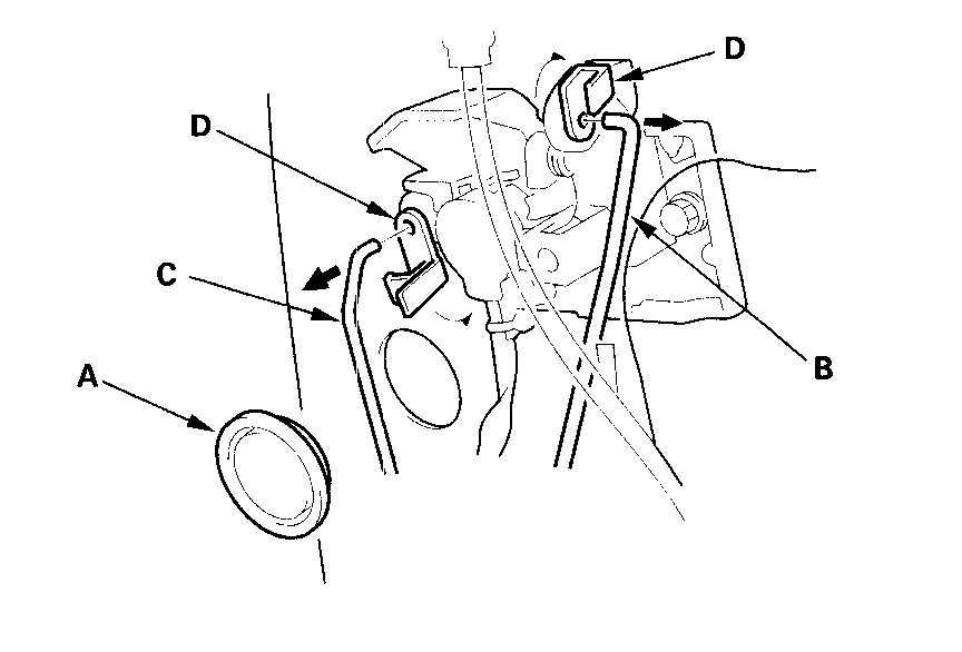

So normally I use the driver side door to disarm my alarm by putting the key in and unlocking the door. However the spring inside the keyhole on the door broke so I can’t even get the key in the door so my car alarm system is always on and alarms everytime I turn on the car. Is there a fuse or something I can remove to takeoff the alarm? Or any other way to keep the alarm system disarmed?
Thanks in advance.
Feb 3, 2021 at 1:29 PM
  • 110,244 POSTS

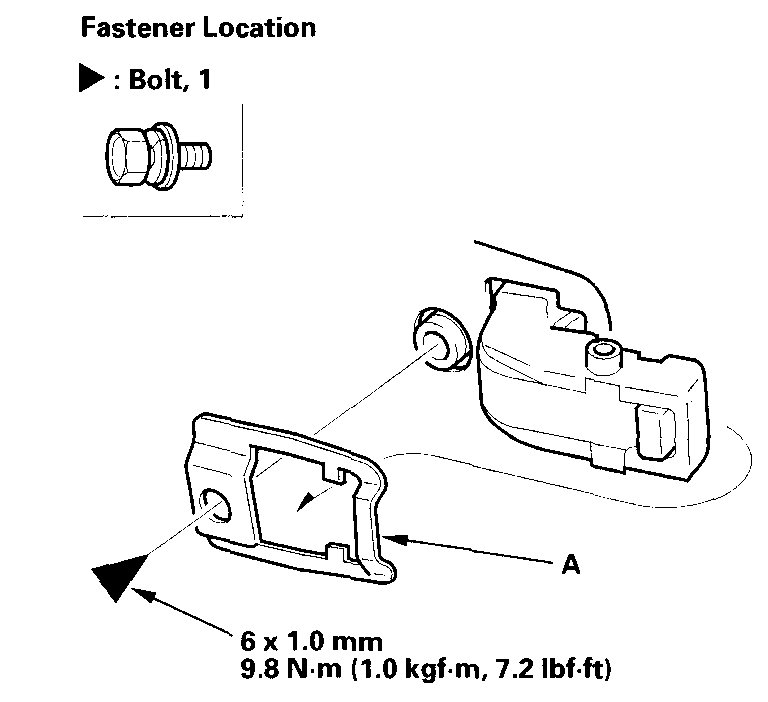

If you remove the fuse that the alarm works with, the car won't run. What I feel you need to do is replace the lock that broke. Also, it can't be disarmed.
If you decide to replace the handle/lock, here are the directions. The attached pics correlate with the directions. Note, the lock assembly can be replaced without replacing the handle, but the handle must be removed.

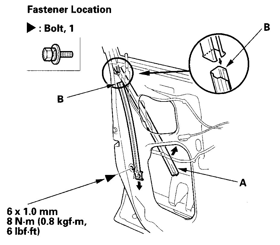

3. Pull the glass run channel (A) away as necessary, and remove the bolt, then remove the center lower channel (B) by pulling it downward.

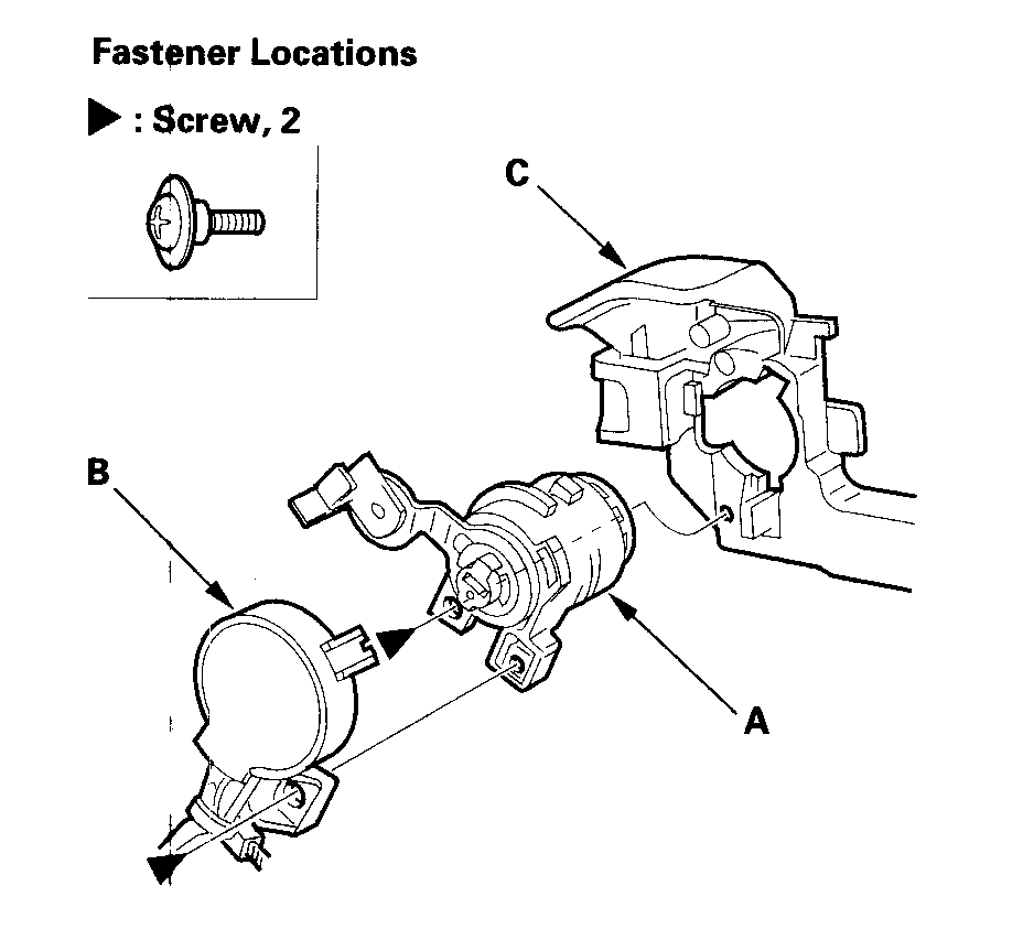

4. Remove the maintenance cap (A), then disconnect the outer handle rod (B), and cylinder rod (C) from the joint bushings (D).
NOTE: Check the joint bushing for damage and replace if necessary.
pic 3

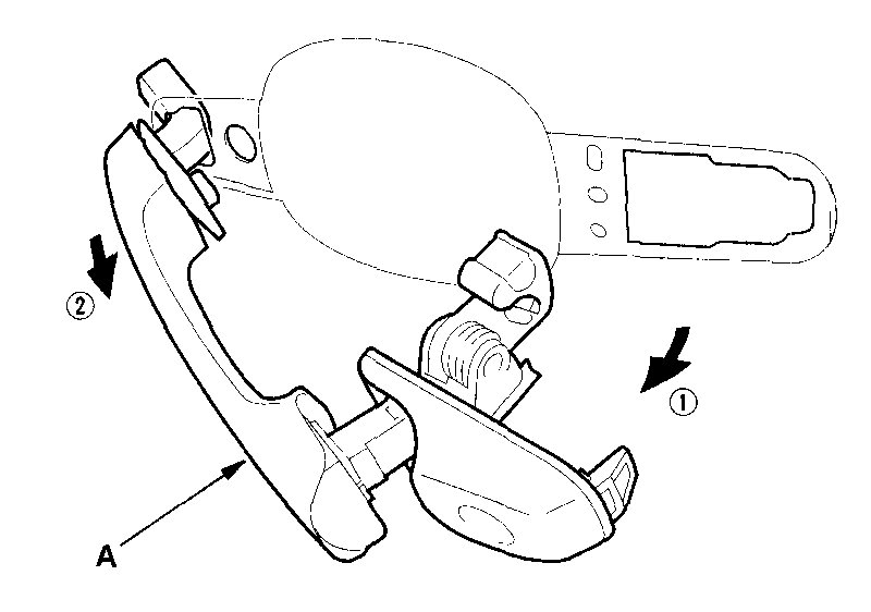

5. Driver's and some passenger's: Remove the maintenance cap (A) from the rear of the door, then loosen the screw securing the lock cylinder protector (B) and the outer handle (C).
NOTE: Because of the tape (D) on the middle of threads, the screw will stay on the protector after it is loosened.

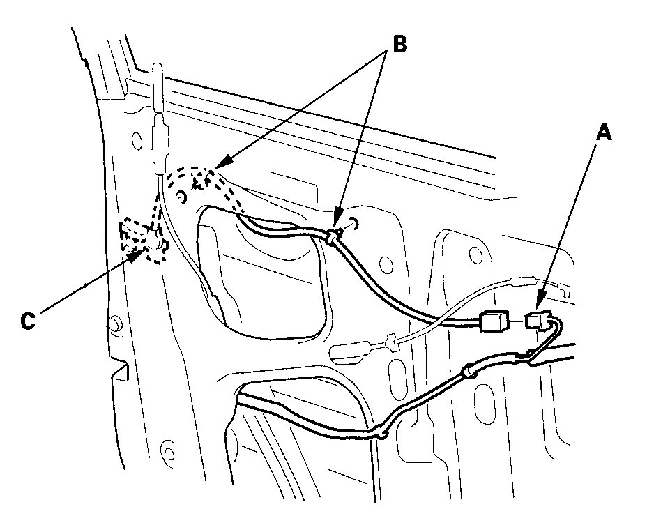

6. Remove the bolt, slide the lock cylinder protector (A) rearward, then remove the lock cylinder switch (for some models), lock cylinder, and lock cylinder protector as an assembly.

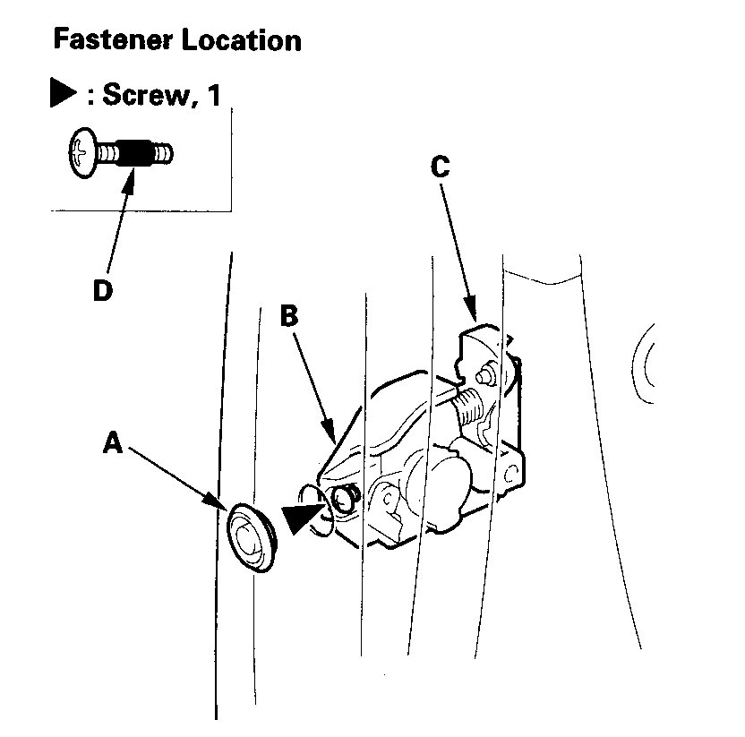

7. With lock cylinder switch: Disconnect the lock cylinder switch connector (A), and detach the harness clips (B), then remove the lock cylinder switch (C).

9. Remove the bolt, then remove the spacer (A).
pic 8
