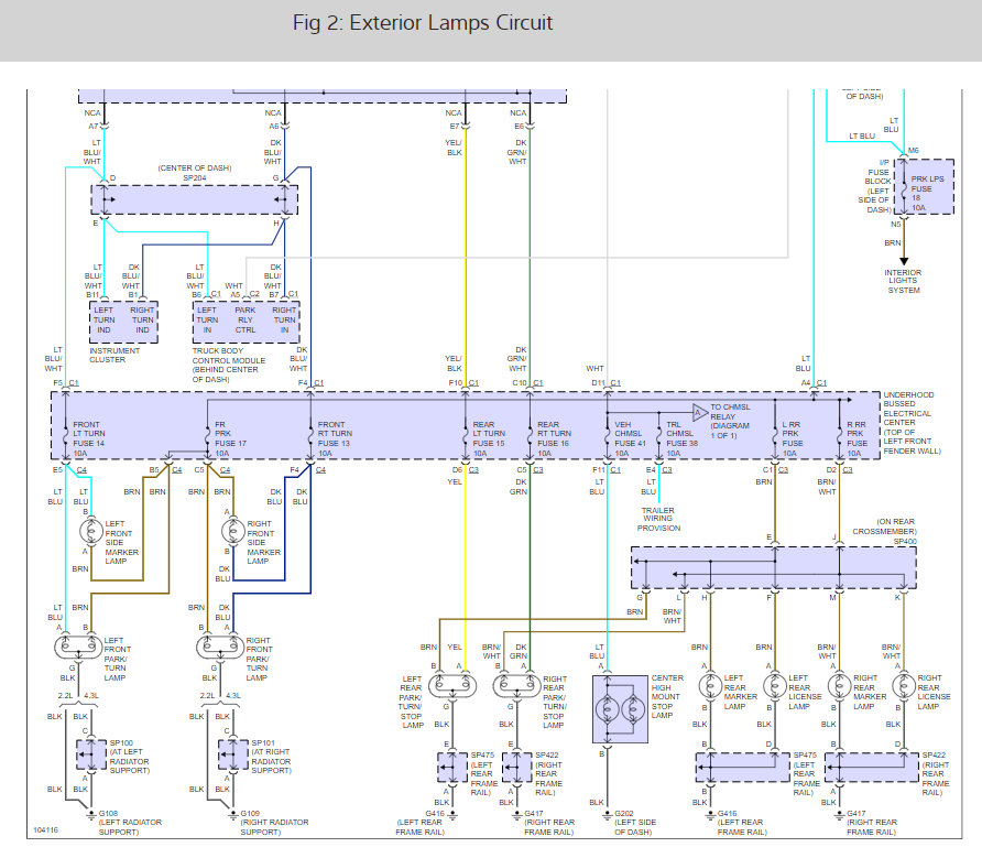

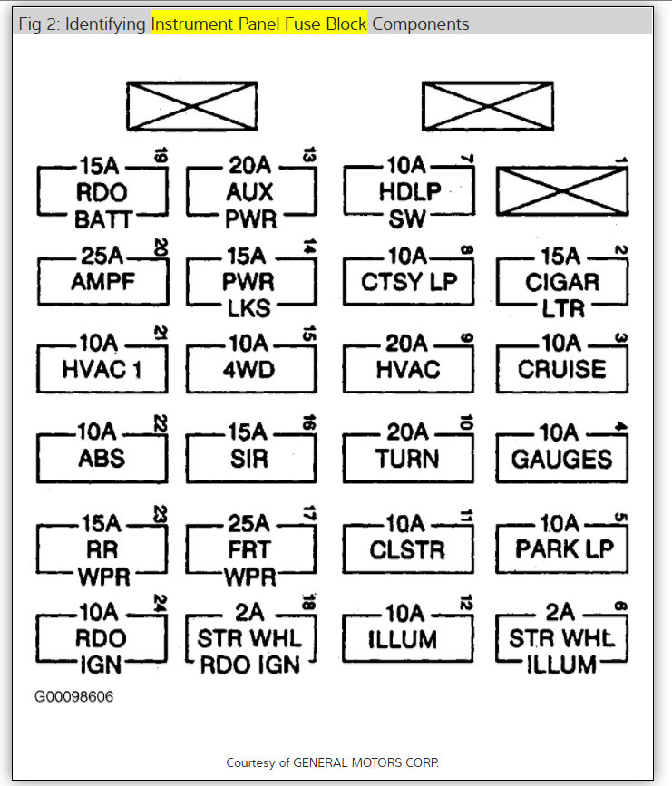

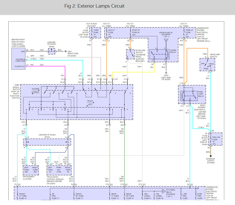

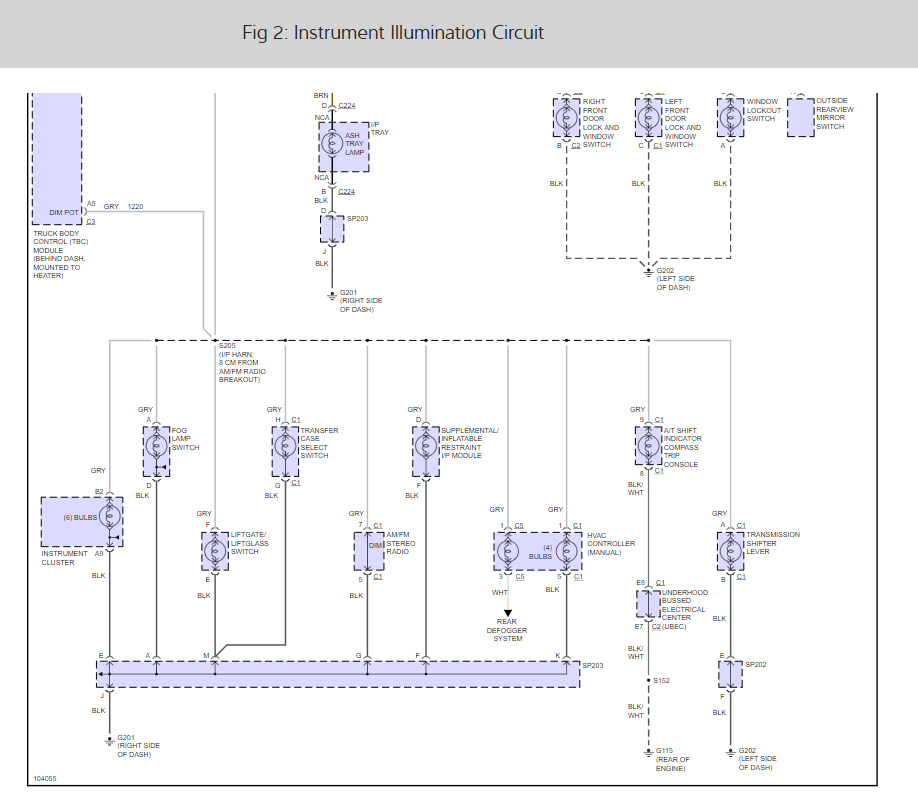

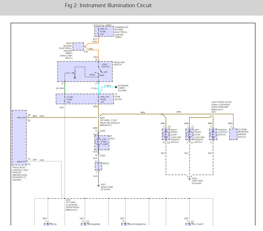

Inside my gauge cluster speedometer numbers do not light up. In the back of my truck the license plate lights do not come on. My running lights do not come on in the back, but my brake lights work. My reverse lights work, my blinkers work, but I cannot figure out where the problem is. I checked my fuses, I checked my relays. I do not understand where the problem is.
Nov 21, 2018 at 6:43 PM
  • 54,837 POSTS

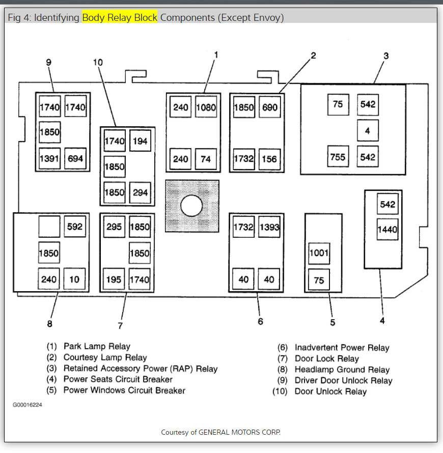

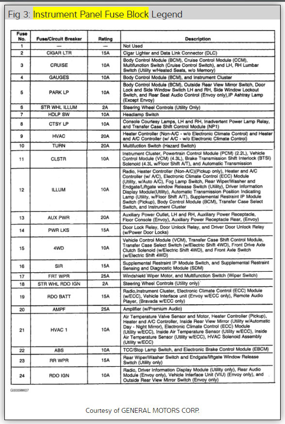

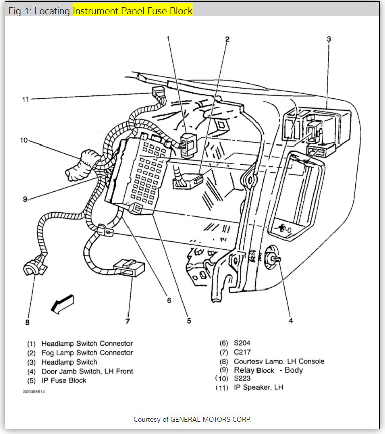

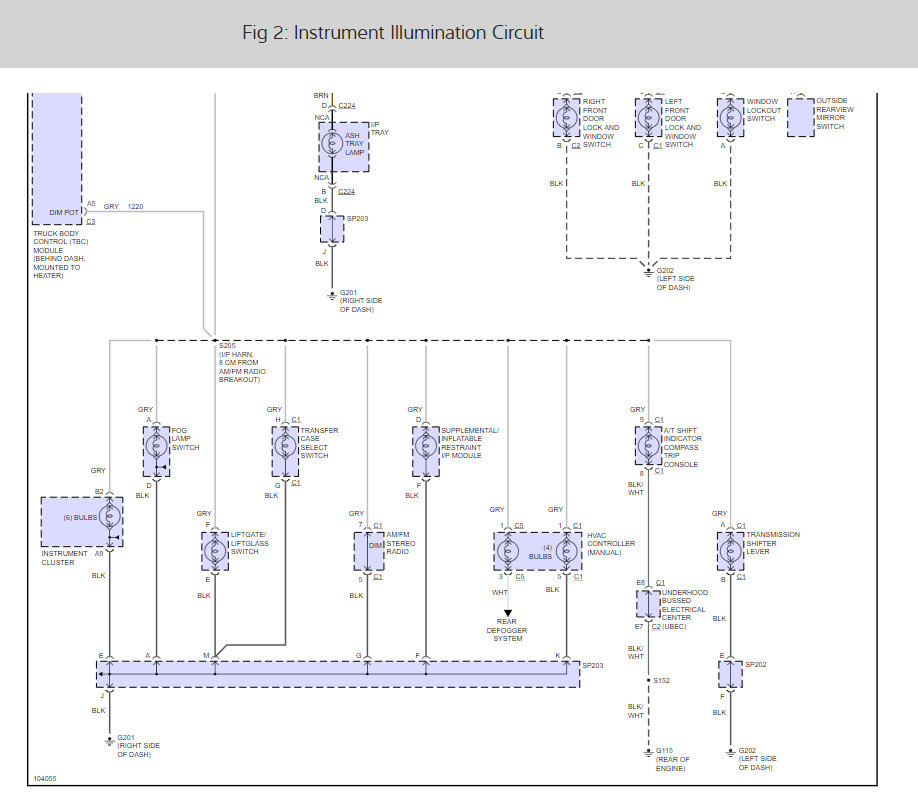

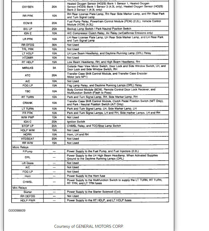

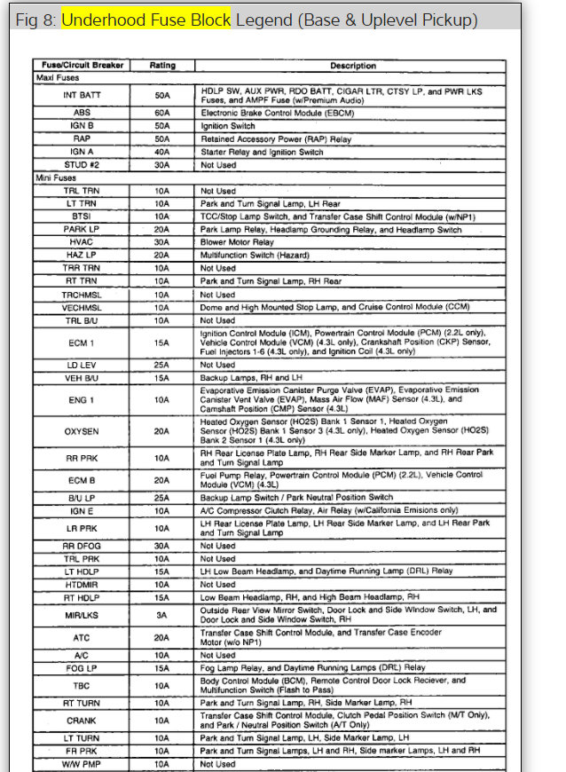

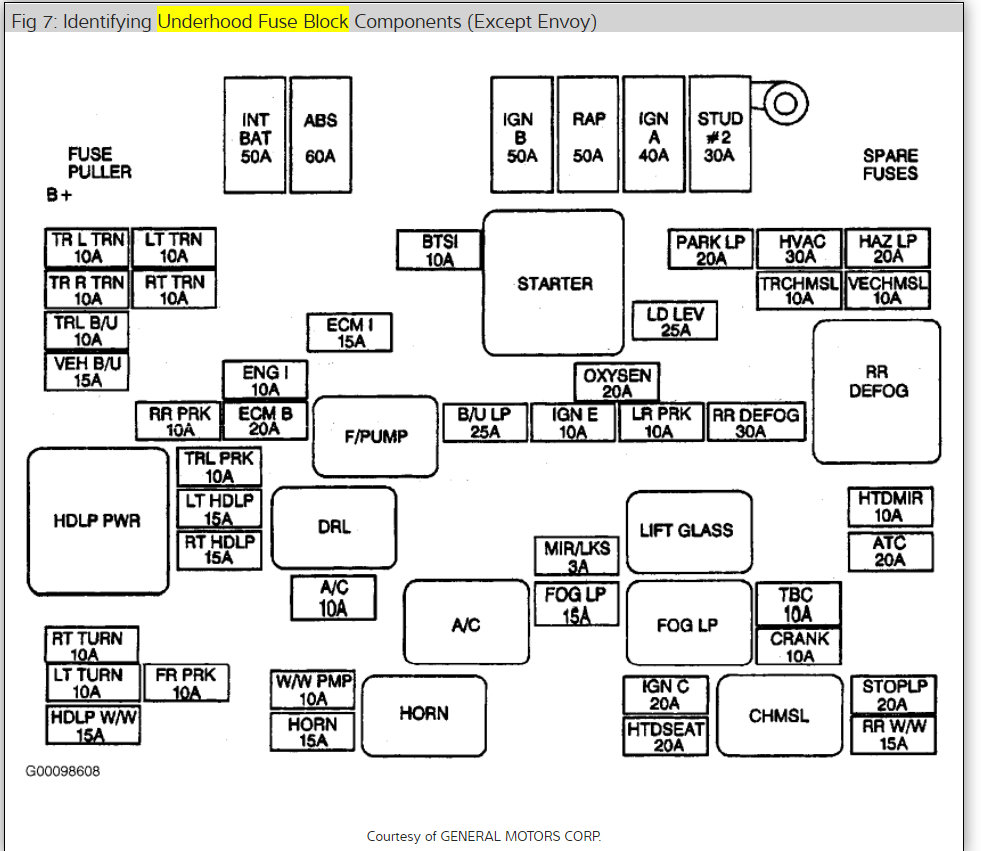

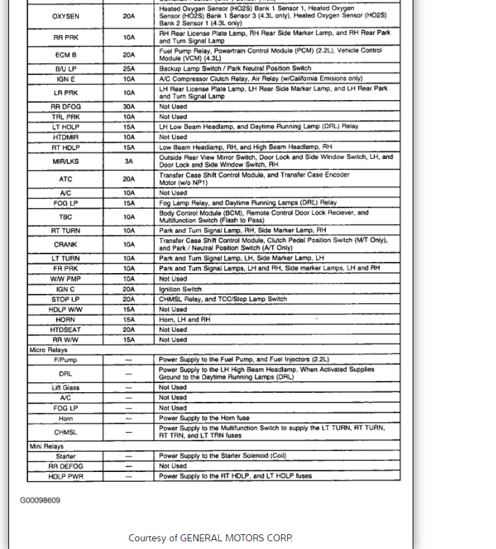

Do you have power at the PRK LP fuse? Here is a guide to help you test and the wiring diagrams for the blinkers and instrument cluster so you can see how the system works. I also included the fuse location as well.
