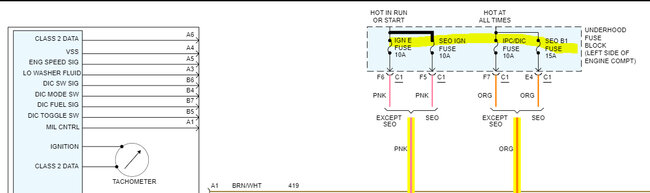

I believe instrument cluster is not working properly?
2003 CHEVROLET SILVERADO
215,496 MILES • 5.3L • V8 • 4WD • AUTOMATIC
BOWMANDA
The oil pressure gauge reads zero, the battery gauge reads zero, fuel gauge reads empty, and temperature gauge reads zero. Also, now my windows won’t go up or down and the lock system won’t work. Any help would be appreciated.
Jul 25, 2023 at 11:34 AM
  • 110,244 POSTS
I have to start by saying, the instrument clusters in these trucks are known to fail and need to be repaired or replaced. However, let's first check if we have a power issue.

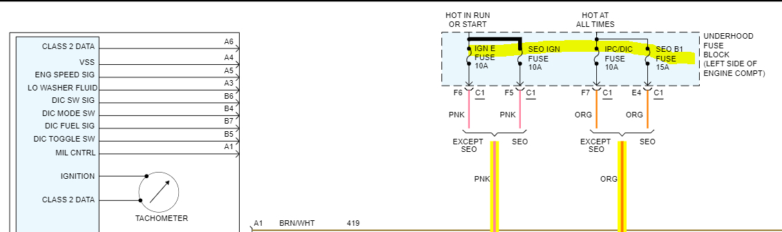

If you look below, I attached a pic of the power supply to the instrument cluster. The fuses are in the fuse box under the hood. When you check them, it is also important to make sure they have power.
Do this and let me know the results. Also, let me know if this happened all at once.
See pic below.
