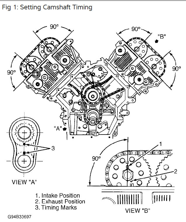

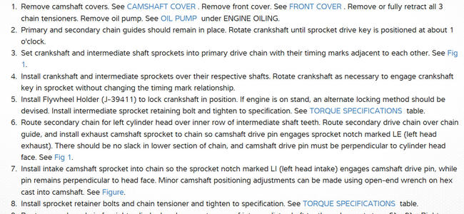

I am trying to get all of the timing marks lined up.
KELLYZ
MEMBER
1997 CADILLAC DEVILLE CONCOURS
4.6L
V8
FWD
AUTOMATIC

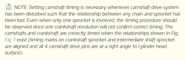

Never removed the crankshaft to balancing cam. How many rotations will it take to get the marks lined back up on these components?
Thursday, May 21st, 2015 AT 5:47 AM
HMAC300
MECHANIC
48,601 POSTS

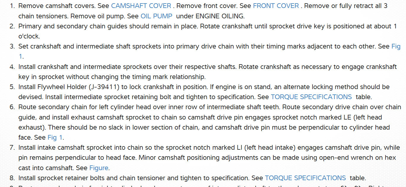

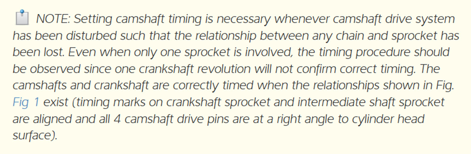

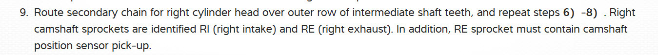

Should only be two but you will have to probably realign all of them now. See pics
