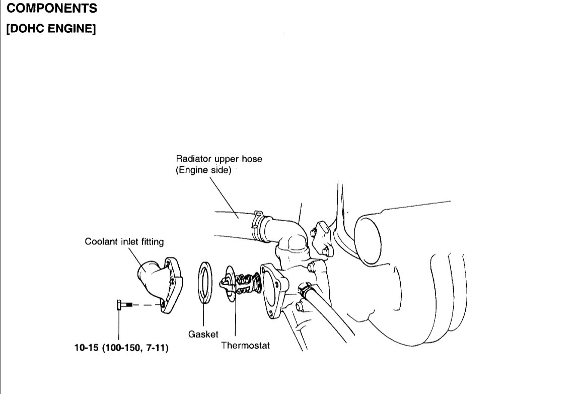

I have a 2003 Kia Optima LX and I'm trying to find out how to change the thermostat on it.
Jun 23, 2017 at 3:12 AM
Experienced Mechanic
55,579 POSTS
You must start by draining the coolant. Here is a guide, video and diagram (below) to show you how to get the job done.
and
https://youtu.be/skrwyPSkdTA
Check out the diagrams (Below). Please let us know if you need anything else to get the problem fixed. Cheers, Ken
