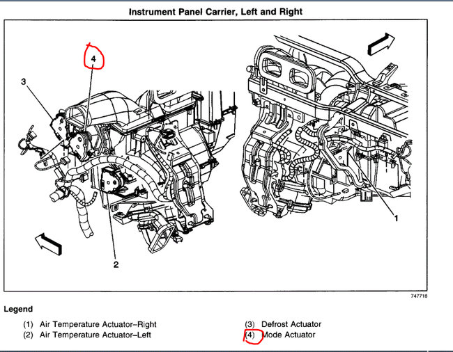

I am not getting air through dash vents. I get air from defrost and floor. where would the actuator be located for this problem?

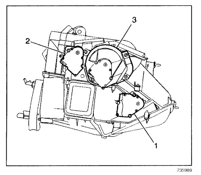

The actuator you are referring to is called the mode door actuator. It is located under the dash on the HVAC housing. Here are the directions for replacement. The attached pics correlate with the directions.
_____________________________________________
2002 Chevy Truck TrailBlazer 4WD L6-4.2L VIN S
Mode Actuator
Vehicle Heating and Air Conditioning Air Door Actuator / Motor Service and Repair Procedures Manual Control Mode Actuator
MODE ACTUATOR
REMOVAL PROCEDURE
pic 1

INSTALLATION PROCEDURE
pic 2
1. Install the mode actuator (3).
NOTE: Refer to Fastener Notice in Service Precautions.
2. Install the screws to the mode actuator (3).
Tighten
Tighten the screws to 1.9 N.m (17 lb in).
3. Connect the mode actuator electrical connector.
4. Install the I/P carrier.
5. Calibrate the air temperature actuator on vehicles equipped with automatic climate control (C68). Refer to Re-Calibrating Actuators (Primary) or Re-Calibrating Actuators (Auxiliary HVAC).
For a description of the RPO Code(s) shown in this article or any of the images therein, refer to the RPO Code List found at Vehicle/Application ID". See: Vehicle > Components > RPO Codes

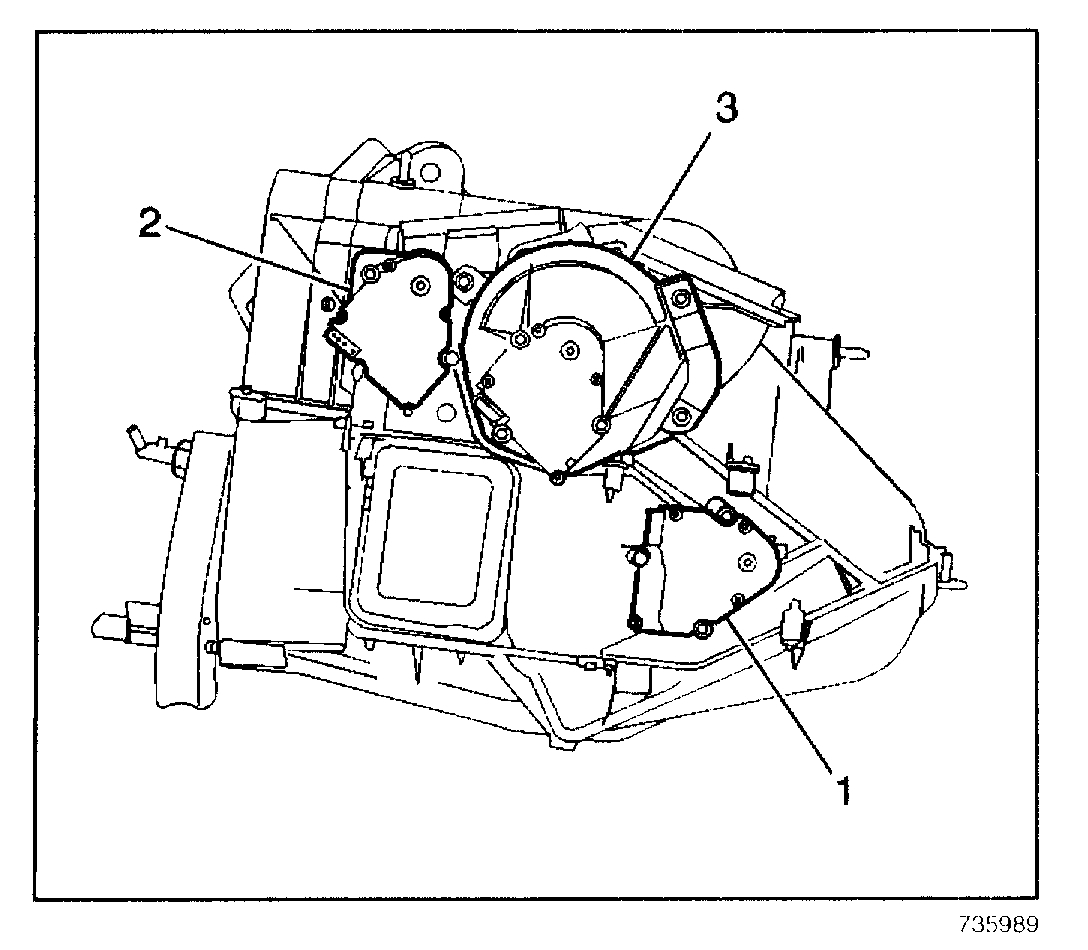

Pic 3 shows a location of the component.
Let me know if this helps.
