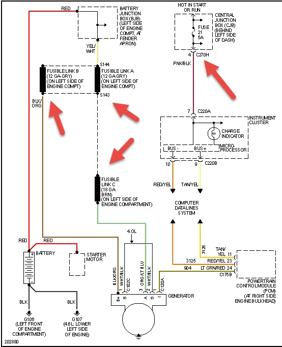

I am not getting a signal from computer to the alternator
2005 FORD EXPLORER
128 MILES • 4.0L • V6 • 2WD • AUTOMATIC
CHRISINGERSOLL
.I have checked all the connections and wires for shorts or grounding. Just not getting a signal??
