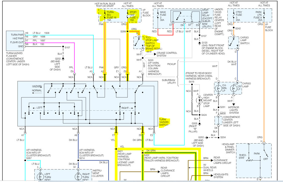

My rear brake lights and blinkers are not working and i have a few wires not connected.
The truck listed above is a k1500.

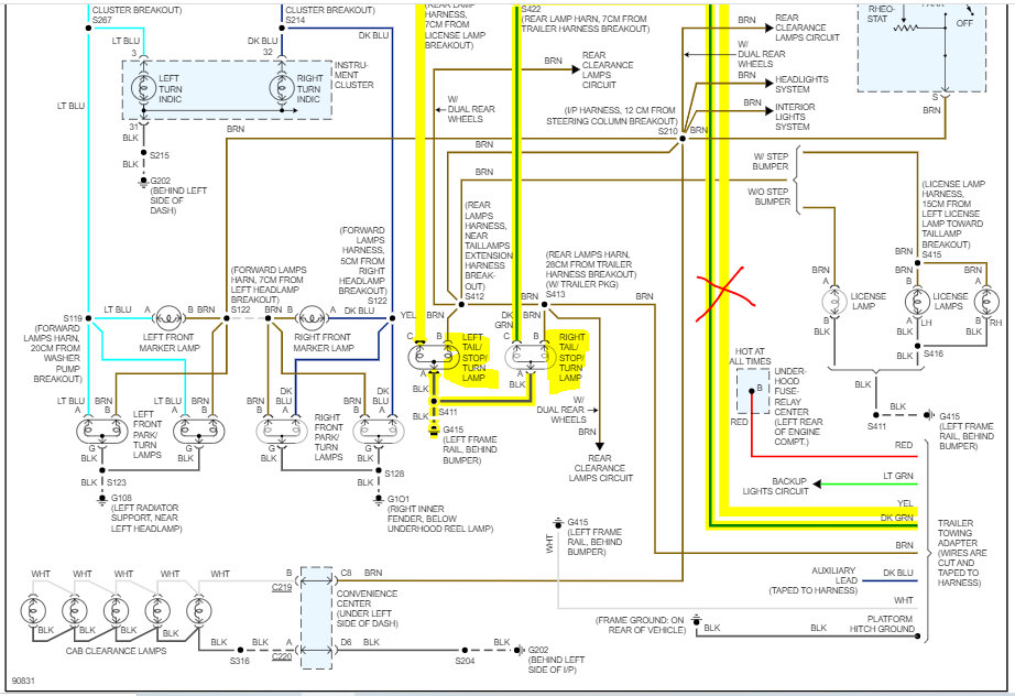

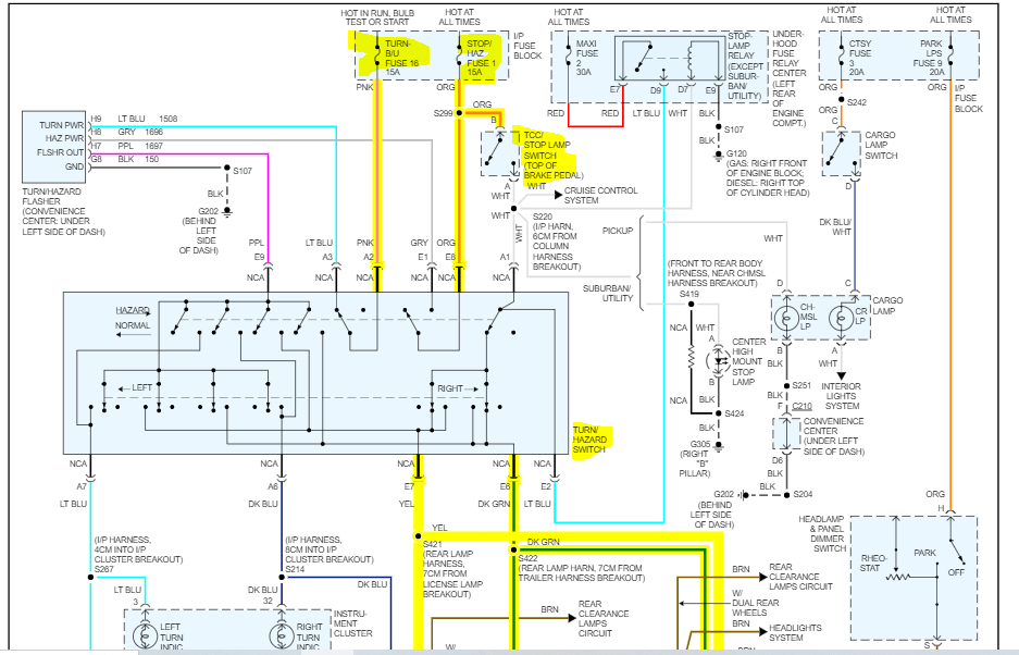

I attached the rear lamp wiring schematic below. I highlighted the wires that are relevant for the rear as well as which fuses to check.
See pics below. Note: I had to cut the pic in two to make them readable. I did overlap them so you can follow from one to the next.
