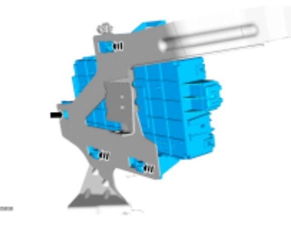

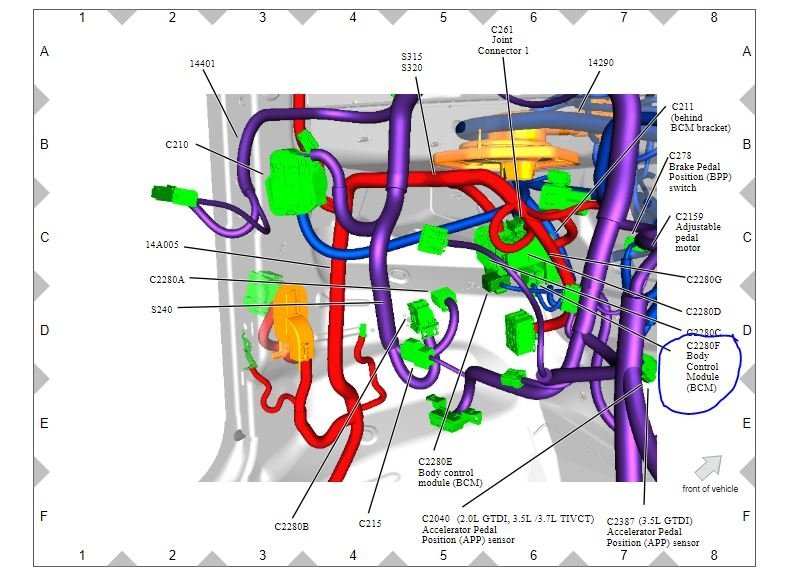

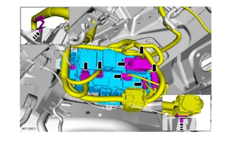

Where is the Body Control Module BCM on my car? Will I need to remove anything to access the C2280F plug? Can suggest best way to pass the wire through the firewall?

Removal
Notice: When any vehicle module is being programmed, connect an external battery charger to make sure that the module programming is completed without the interruption due to the load shedding feature becoming active. The external battery charger must maintain a system voltage above 13 volts. This can require a charger setting higher than the lowest charge setting. The external battery charger negative connection must be made to an engine or vehicle chassis ground and not the negative battery terminal. If the connection is to the negative battery terminal, load shedding cannot be prevented from being invoked and module programming may be corrupted. After charging has begun, start the engine to clear any load shed states and then turn the engine off and proceed with programming.
Note: If installing a new module, it is necessary to upload the module configuration information to the scan tool prior to removing the module. This information must be downloaded into the new module after installation.
Note: If installing a new BCM , for vehicles without Intelligent Access (IA) , all vehicle keys are erased during key programming. Verify at least 2 of the vehicle keys are available prior to carrying out this procedure. If the vehicle is equipped with a Remote Function Actuator (RFA) module, the keys will not need to be programmed because the RFA module retains the key programming information.
Connect a battery charger. Refer to Section 414-01 .
Note: This step is necessary only if the BCM is being replaced.
Upload the module configuration information from the BCM . Refer to Section 418-01 .
Remove the steering column opening trim panel. Refer to Section 501-12 .
Disconnect the 7 BCM electrical connectors and remove the 2 harness pushpins from the BCM .
Lift the BCM release tab(s) (away from the BCM bracket), slide the BCM to the left and remove.

I also attached a diagram that shows the connector you are referring to.
