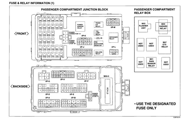

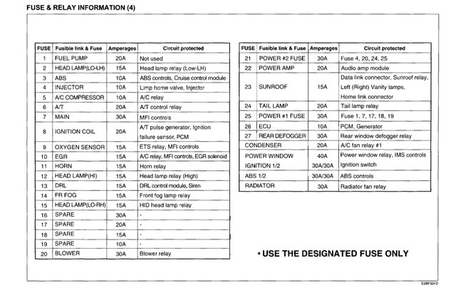

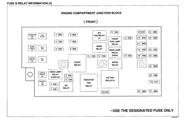

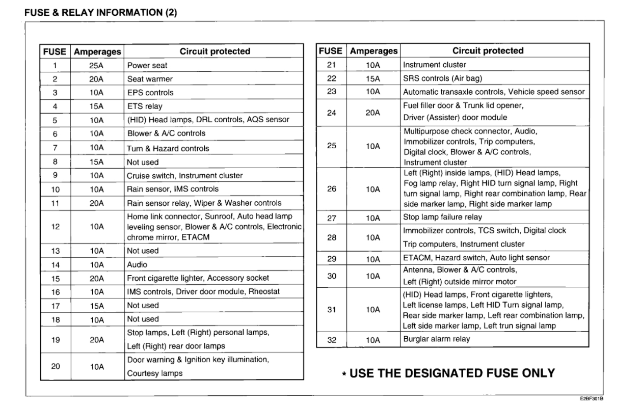

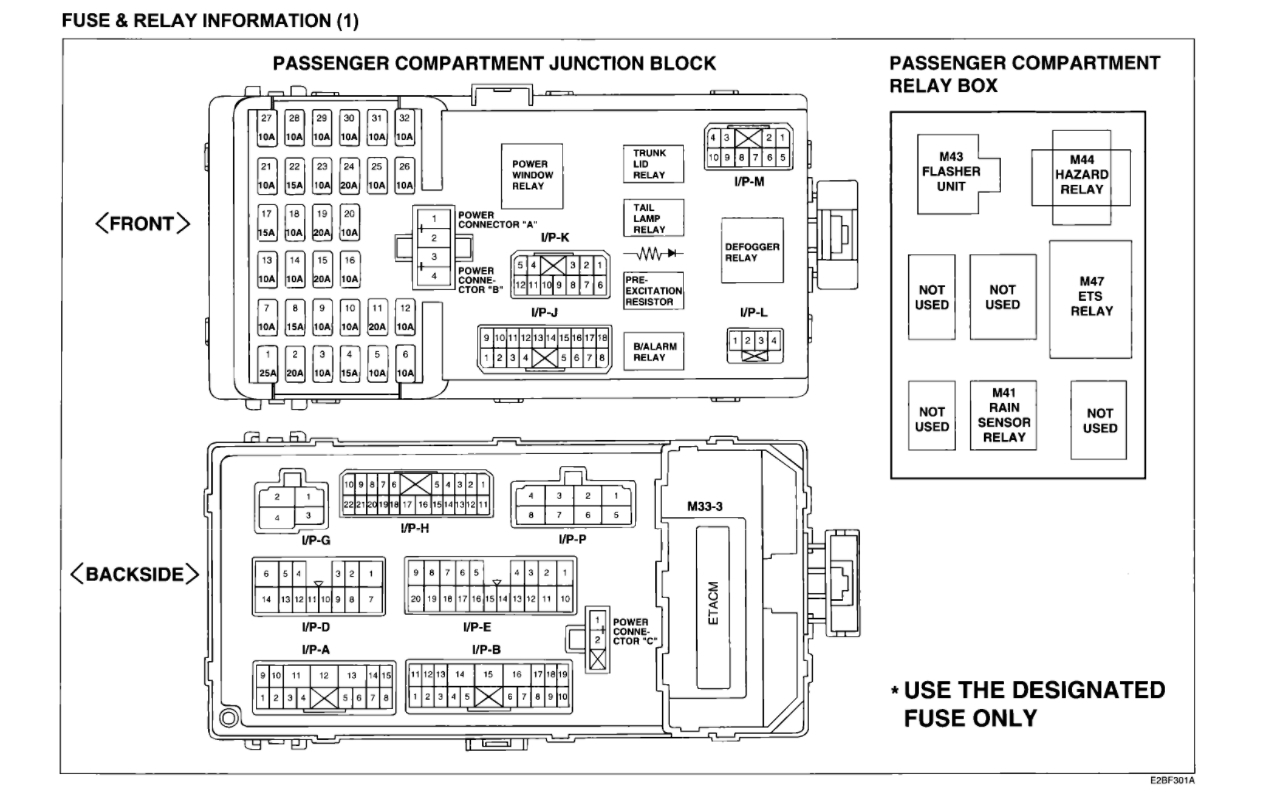

Where is the fuses for this car and how do I check them?
Jul 8, 2010 at 1:38 PM
Experienced Mechanic
52,796 POSTS
Good morning,
I attached the fuse diagrams for the 2 fuse blocks in the car. I also attached the description of each fuse and relay control.
Look for the passenger fuse block either in the lower kick panel or on the end of the dash.
The underhood will be toward the headlights by the battery.
