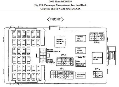

The tail lights and instrument lights went out. I had heard a clicking for a few weeks and then they all went out. I think it might be a relay. Can I replace this myself. I checked fuses already.

Your tail lamp relay is located in the passenger compartment junction block, pictured below..
https://images.2carpros.com/forum/automotive_pictures/261618_Noname_299.jpg
Simply pull the relay straight out, much like a fuse, to remove it. Follow the link below to learn how to check a relay.. https://www.2carpros.com/how_to/how_do_i_check_a_relay.htm Thanks for using 2CarPros.com!
