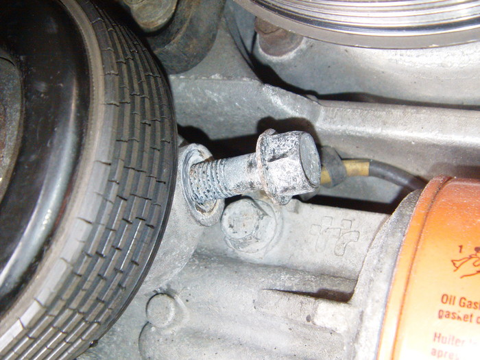

IMNOTAMECHANIC
  • 17 POSTS

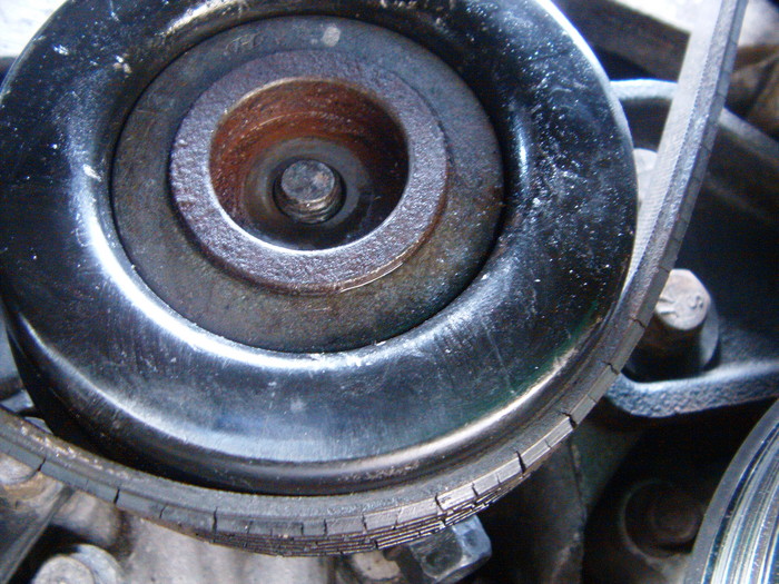

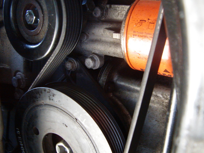

...but, my main concern still is the AC/alternator belt. I have turned the bolt counterclockwise as indicated by you and the belt still is tight as hell. You can see in the picture the bolt coming out. Is perhaps the turning of the bolt clockwise instead?
In case I'm in the right path, how to make the belt to get loose now? What to move? Where to hit? Just "cut off" the belt? :-)
(I think the picture will show the bolt going right, actually the bolt is going down, the same as the oil filter behind it)

KHLOW2008
  • 41,814 POSTS
At the side of the pulley ther is a holding nut, it must be released before the pulley will move.

IMNOTAMECHANIC
  • 17 POSTS
KHlow2008,

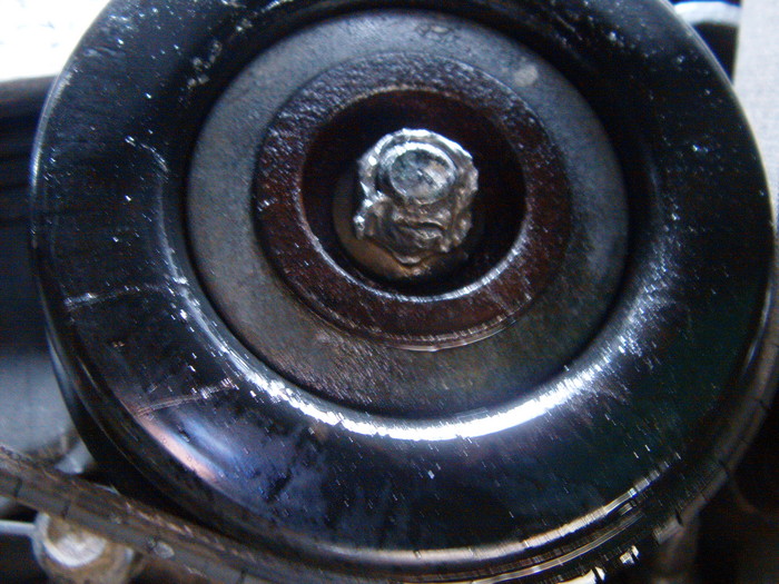

the first move I did in my first try before writing here, was to loose the nut that holds the pulley. It was that hard that I used D-40 and nothing, I noticed that I was starting to destroy the corners of the hexagon of the nut and I did stop. The releasing of this nut is hard by its location, which is very difficult to reach. I thought after this first step which failed, that the loosing of the belt was by doing it in a different way.
I will buy one of those tools which remove nuts by holding their sides and not their coners, and try it again. I will do it on Sunday, because today I had to re-install everything back in place because I need the car tomorrow and Saturday...besides, tonight and tomorrow will be raining in my area.
Thank you for your advice, I wish you should answered my question last year when I started this thread, but never is late, and I will try it again.
Apr 7, 2011 at 6:44 PM
KHLOW2008
  • 41,814 POSTS
Sorry if I did not make myself clear.
There are 2 bolts, one for the pulley ( bearing ) and the other is the mounting. The one to loosen is the mounting bolt and not the one holding the pulley.

Maybe I was not paying too much attention.
The one that you are having problem with is it the A/C or Power Steering Belt?
Sometimes pictures are shown not in their proper perspective so it is a little confusing.
For the A/C belt, the central holding the pulley (bearing) has to be loosened.

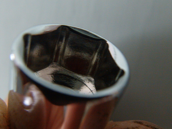

IMNOTAMECHANIC
  • 17 POSTS

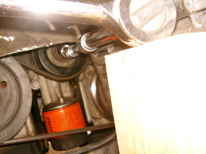

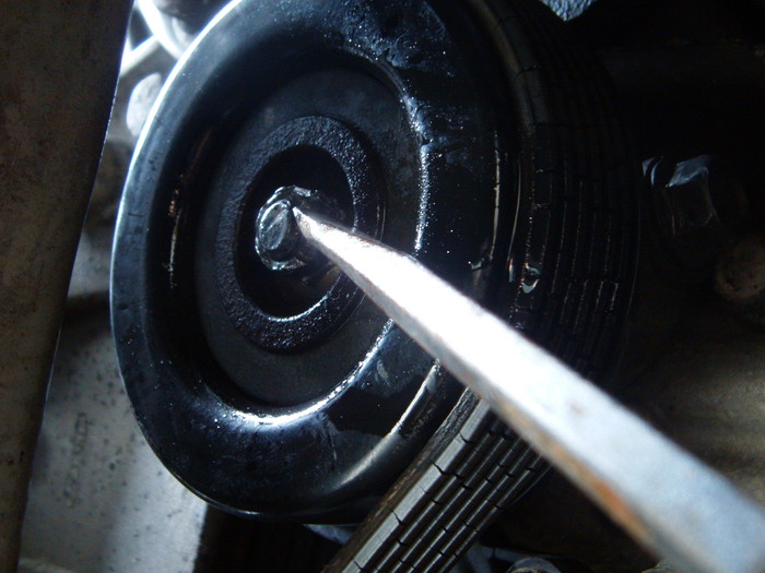

Today I was looking for a metric wrench similar to a break bleeder wrench, because they can reach nuts and bolts that are located in a lower surface level. This is the problem with the nut of the pulley in question, my wrench has a regular angle which is not enough to reach and fit properly to the nut.
I will heat a wrench and bend it in that way to reach the nut and make it fit entirely. Or perhaps I will reduce the beveled interior sides of the nut socket in the bench grinder for the same purpose, because the nut's width is very thin.
I will find the way to loose that nut that gave me hard time in my first try, Sunday I will loose it even if I must have to use the troglodyte method using a flat screww driver and a hammer and hit and push a side of the nut until moves.
Thanks again for your help, I have the hope that on Sunday my car will run with new belts.

KHLOW2008
  • 41,814 POSTS
The hex part is rather thin and you need a hex wrench, not those with multi points which can easily result in it going loose.
There are wrenches available which are not angled which would be the best choice of tool to use. Snap-on makes one of the best but they are rather pricey.

IMNOTAMECHANIC
  • 17 POSTS

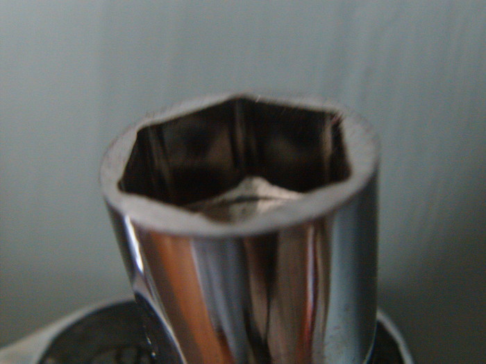

Well, I bought extra nut sockets in the pawnshop for a buck, and took the beveled interior. This way the nut socket will fit entirely to the nut. I didn't find a 14mm hex head wrench to release the bolt, so I went with the wrench.
Apr 10, 2011 at 5:18 PM

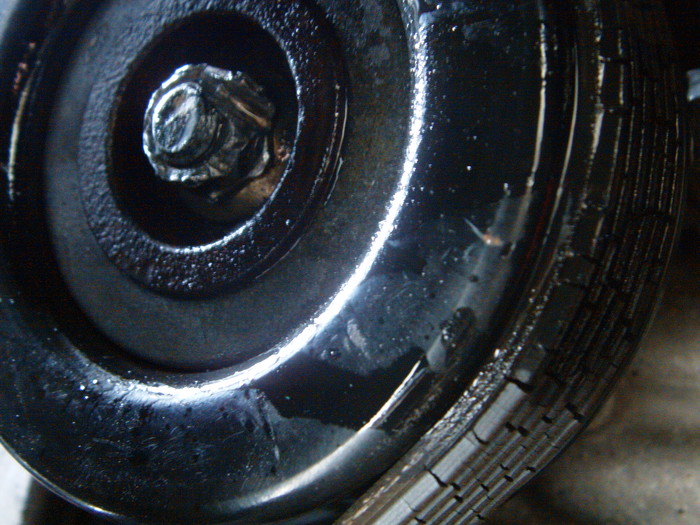

IMNOTAMECHANIC
  • 17 POSTS

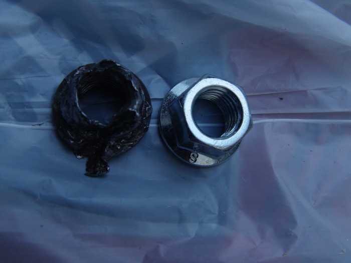

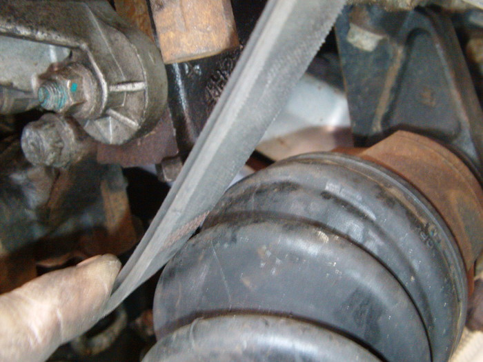

In order to take the nut out I had to make a base to hold the wrench, to which I must have to add extensions because otherwise won't fit straight. The nut came out so easy, that I should made this step in November last year and have no need to consult no one. After I took the nut, the process of changing the belts was a piece of cake, the way it is suppose to be.
Apr 10, 2011 at 5:26 PM
IMNOTAMECHANIC
  • 17 POSTS
Ha ha ha ha....easy?! To take that nut was HELL!!!. I had to become a troglodyte and with a set of screwdrivers and a hammer I practically had to brake the nut. I spent lots of D-40 and took me about an hour of hard work. Finally the nut moved, look at it, believe me, there was no other way because I lack of "special tools" for situations like this.

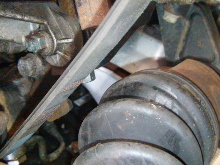

IMNOTAMECHANIC
  • 17 POSTS

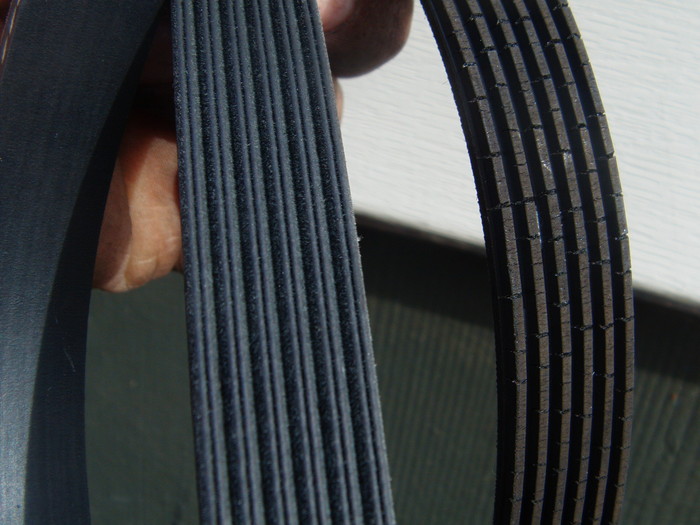

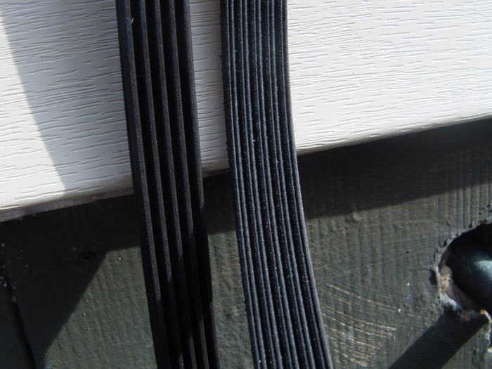

Actually, only the AC/alternator belt was very bad, the steering wheel belt was in good condition, but I decided to replace both, because the car has barely 45,000 miles and still about two years to replace the timming belt, so, I don't want to remove the belts again until the day I must replace the timming belt. I gave a look to the timming belt and still look very good, no signs of deterioration at all.

IMNOTAMECHANIC
  • 17 POSTS

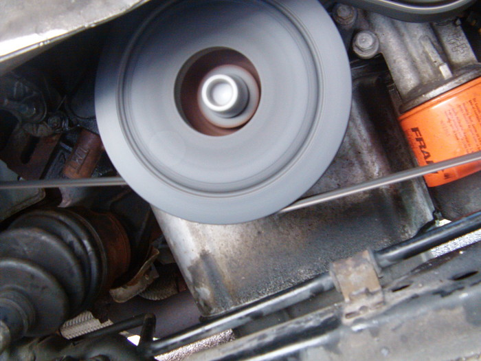

Well, thank you bluelighnin6, and a million thanks KHlow2008, I replaced the belts, check for the proper tension, and the car is running great. Here are the pictures of the pulley with the new nut installed, the new belts in place, and the motor running and belts working properly.
I took some additional pictures, and I might answer the question asked above mine, about changing belts. I'm not a mechanic, neither an expert, but I will try to show the process step by step.

Cheers. Finally you won the war.
The pictures that you posted is going to be helpful to others.
