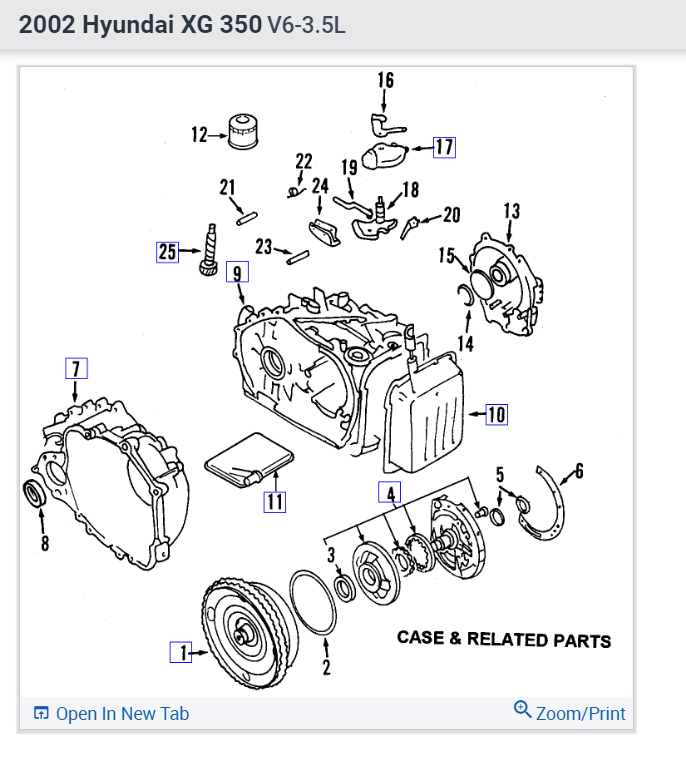

Would you tell me the location of the transmission filters for my car? Carquest sold me a spin on external filter and Advanced sold me an internal filter but I cannot find the location of either one.

The transmission filter is located on top of the transmission upside down here is a diagram of the location below (#12) with a guide on how to service the transmission step by step.
