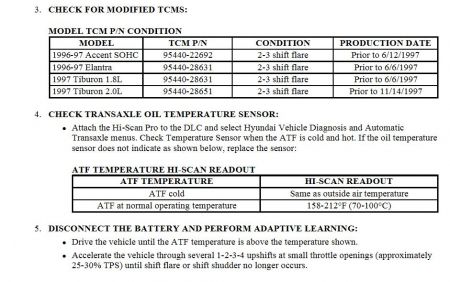

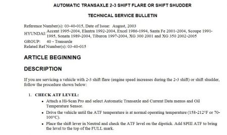

2001 Hyundai XG300 6 cyl Front Wheel Drive 112000 miles
when transmission changes from 2nd to 3rd there is a shaking like going over rumbling strips

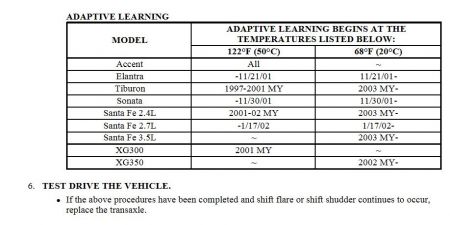

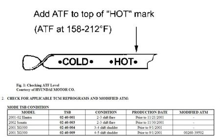

Hi Enoch, Thank you for the donation. There was a service bulletin out on this issue and you can check with your local dealer for more info.
