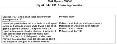

2001 Hyundai XG300 code P0715
2001 HYUNDAI XG300
10,010 MILES • 6 CYL • FWD • AUTOMATIC
WESLMOR
I see this code means Input/Turbine speed sensor circuit malfunction. tell me what I need to buy and how to put it on.
